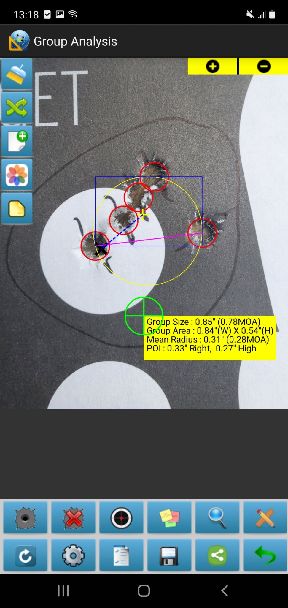

That has been a consistent group size with factory 77smk out of my 12.5 core with the piston
