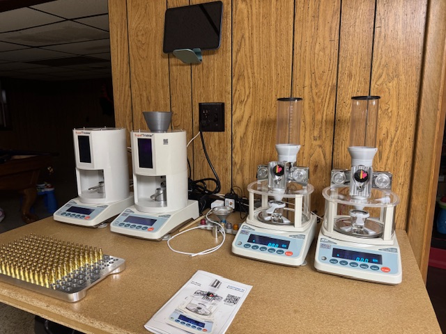

So next what I did was I finally grounded my scales directly to my breaker panel and isolated the trickler son a different table, different outlet altogether. Different circuit too, not the same breaker. This helped some.

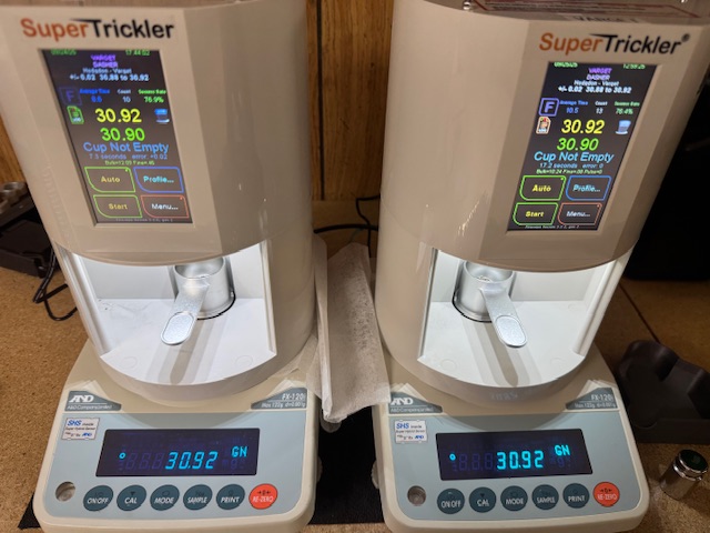

Here is two pictures of my tricklers right after throwing a charge, and then coming back about 30 minutes later.

what are your scales plugged into? I had drift issues. I contacted AnD and they had me isolate the scales from any other electronics. So they got their own power strip and outlet. They also told me to ground the unit, it has a ground on the back of it. I have not had any drift issues since. Just to test this I plugged my laptop in the power strip and had it open and running, and the scale drifted again. Might be worth a try if you have not done this already.
