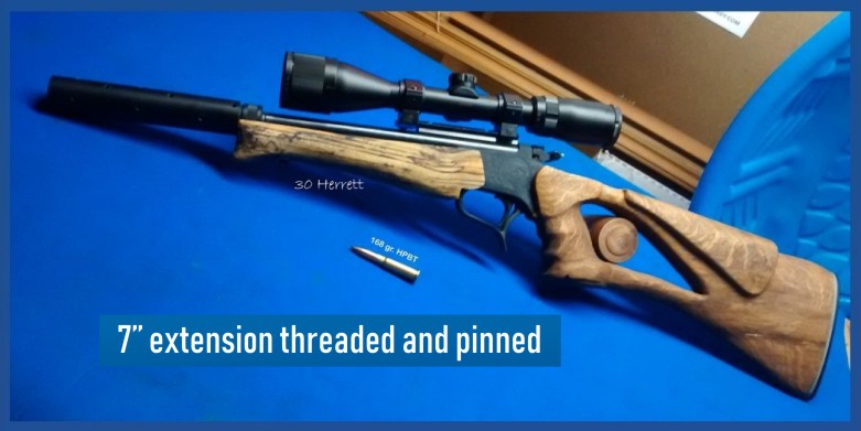

Im looking to build a .30 cal rifle for hunting and plinking etc. Has anyone ever used a 30 Herrett? Also does anyone have any suggestions for a rifle? Im really not looking for a 308 Winchester. Looking for something on a smaller scale, preferably that I can put on a Contender/Encore frame with a 16-18" barrel and still perform.

The 30 Herret is a 44mag necked down to 30 cal I think. Hodgdon's website has data for it.
