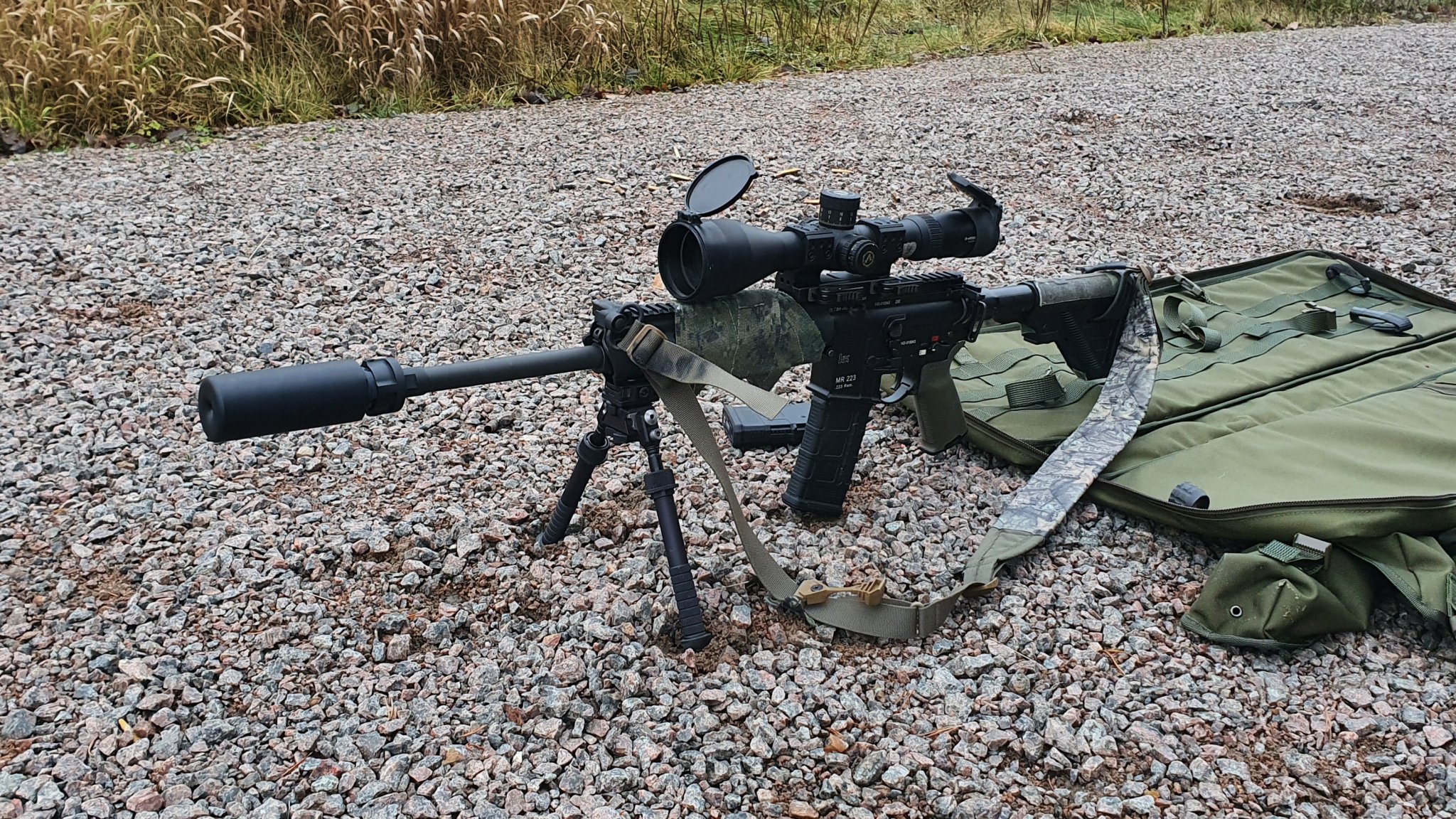

    Hi,
    Bought MR223 and the plan was from the beginning to make it suppressed and I recently added Ase Utra SL5 to it.
    I chose the legacy version because it has better specs and I believe I can get the SL5 working.
    Turned out it is not so easy, with the gas block set to suppressed it is quite nice and very quiet to shoot but I noticed some gas coming out of charging handle hole.
    Previously I have only suppressed bolt and blowback-operated guns so this was much more complicated.
    I have studied this problem and so far I have gathered some basics of how gas operated AR rifles actually work.
    What are the best practices to solve this issue?
    I started to think about modifying the lower.
    I read HK uses an 8 lb spring and a 5 oz buffer and I have been thinking whether upgrading either one of them would keep the bolt closed for a bit longer.
    Is this the right way to do it?
    I also thought of modding the forward assist so that there is some space in it to let gas out. It should help with normal suppressed shooting and even more if I am shooting hotter loads.
    Preferably some 0.17 surface cut along the length of the assist that touches the upper surface.
    Easiest mod I’ve found that works fantastic on my M18 is the Griffin SOB buffer. It tweaks the timing just enough that I don’t get gassed. And I can always easily swap back to factory if I ever want to with no permanent mods.
