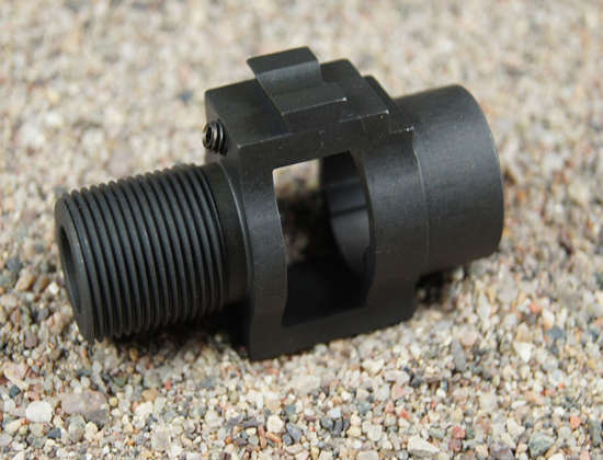

    I’ve done it without the Schuster. I got a Gaslock Front Sight made by SEI. Google .595x32 to 5/8x24 thread adapter M1A. Several places make them and they range in price from $30-$100; not sure why they should cost $100.

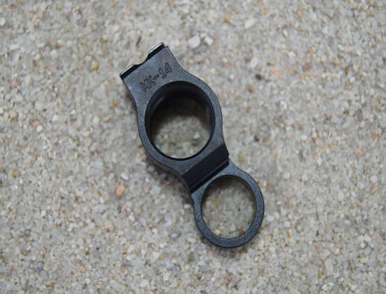

    Most important thing is you need the shroud from a blank firing adapter kit. It will cut down on gas to the face, which is pretty bad.

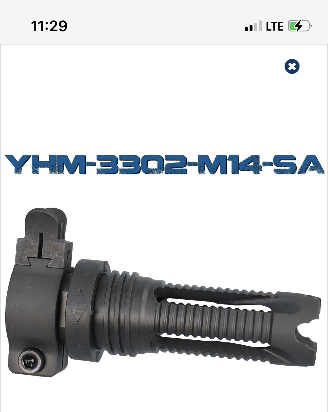

    YHM makes an adapter for their cans that allows you to keep the front sight as well. The barrel has 3 grooves under that flash hider, so don’t go twisting it thinking it will come off. That castle but actually “pulls” the cage off as you loosen it.
