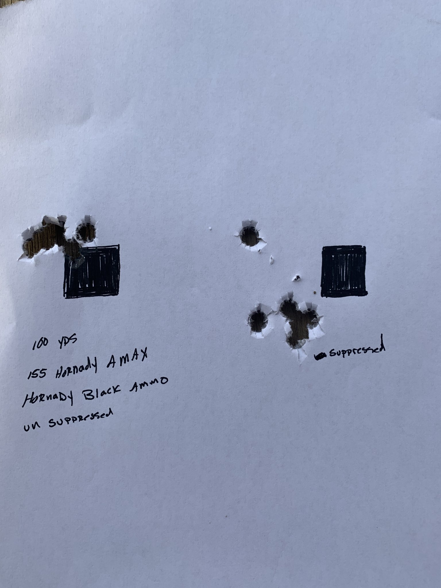

form for is back and the 762 specwar will not hold groups with my match ammo(175 gr nosler rdf home load) or with factory fgmm 168 ammo.
sent it in and they sent it back saying nothing wrong with it but they did send me another brake to try, I mounted it shot the can and same issue.
but I bought a box of 155 hornady black to try for better velocities down range and after 2 fliers it seemed to settle in, is it a suppressor issue or am I going to have to tailor a suppressed load ?
i did a 50 yard test because when silencer co tested this they only tested at 50 and told me the suppressor was fine, and their 50 yard group was as tight as mine, so I did the 50 yard test to show them 50 yards proved nothing

Please don't take this as an insult or as demeaning, but if it shoots tight at 50y, it should shoot tight at a 100y. With no atmospheric effects, groups should be twice the size (I know you already know that, but sometimes hearing it from someone else helps!)
. There is some promise there and one of the 100y groups looked good with one exception. It could be a bit of head game sneaking in on you. If you're expecting to shoot poorly, you usually do.
I would say try it on a different rifle, and/or have someone else that's a known good trigger puller give it a go. I've seen how SilencerCo builds these and there's not a lot of room for error.

my shooting isnt the issue and I not saying that to sound cocky just saying I drive tacks with this gun all day
if I had a 5/8 brake I’d try it on my ar10 but my tikka is m18

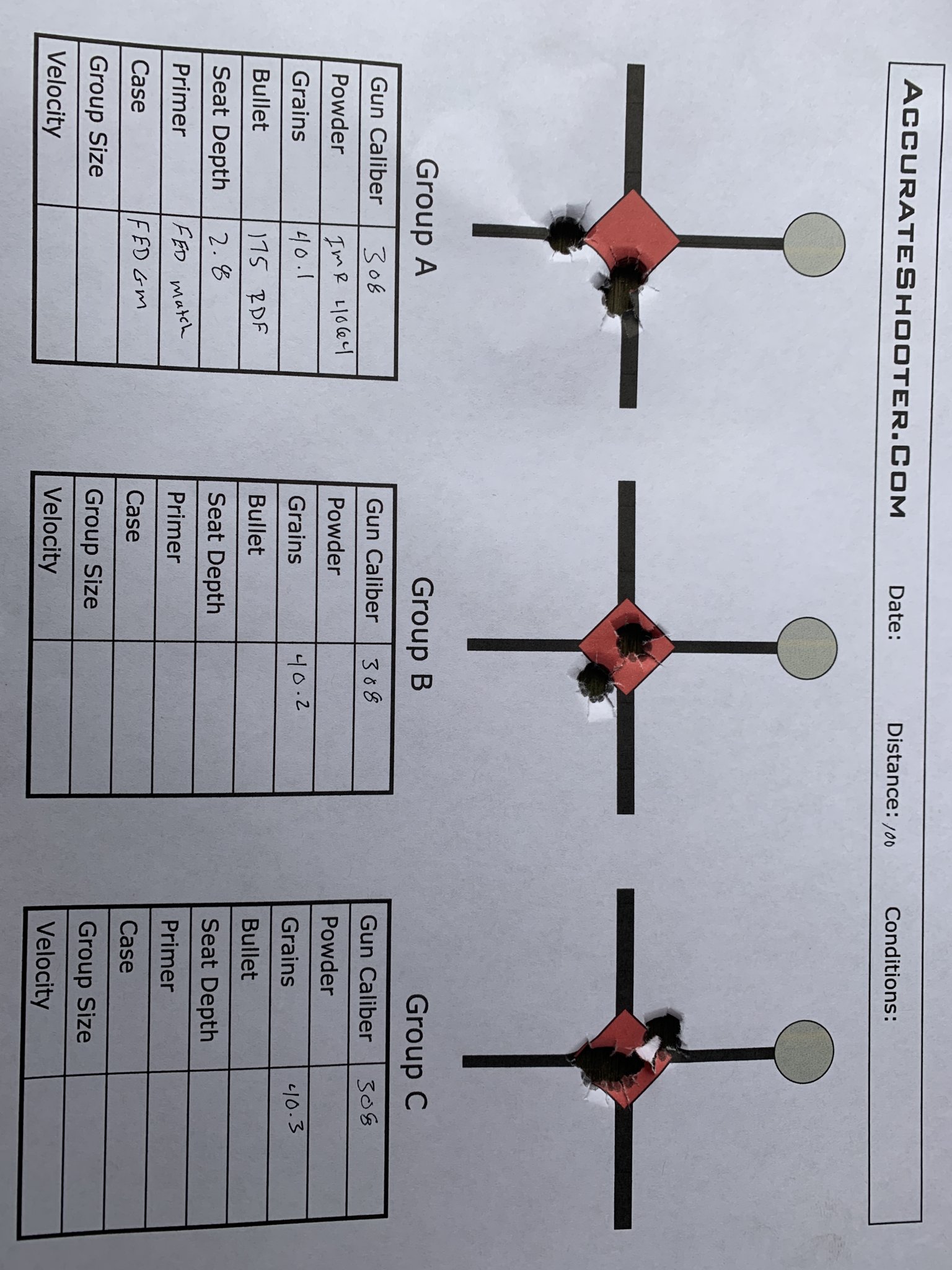

attached is a 3 target group for load development, as you can see mint, then another shit group with same ammo suppressed

I know what you're saying, I was just trying to help isolate the issue. I meant no offense.
I've had perfectly good rifles that shot fine, that I had to sell because I couldn't shoot them for anything.
I've also had perfectly good golf clubs that I had to sell because they didn't look right to my minds eye. The brain can do some crazy things!
Ya I think my best bet is get advice from sico or tailor load a suppressor round
Anytime you hang something on your barrel you change the barrel harmonics. Chances are that’s the difference. Shooting the bullets you intend to use at the charges you intend to try will ensure stability. Then tune to the suppressor. Your barrel is your tuning fork

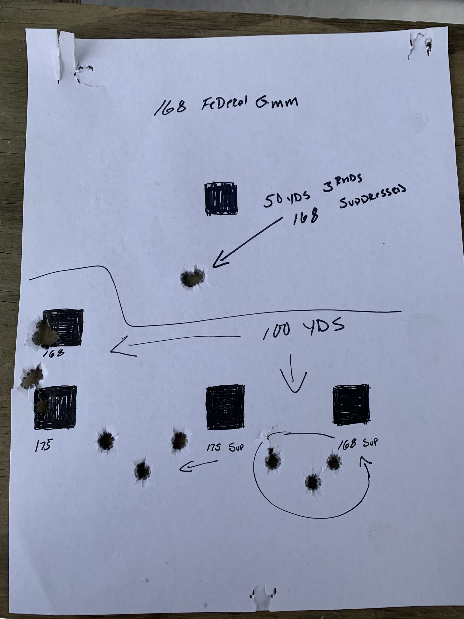

Where both of your targets on the same type of backer? It almost looks like the suppressor target the bullets are key holing, it’s a small picture that I’m looking at but they don’t look to be the same to me.
Yes they where on the same one

UPDATE:
So I went out this am with 20 rounds, trying things and shooting 2 shot groups, I used my fgmm 168 factory ammo and 155 hornady black.
to get right to it when I mounted the suppressor I tightened it on the brake massively tight by hand, tight as I possibly could, shot 2 rounds of 168 fgmm, they where as tight as the gun prints them with out the suppressor
took the suppressor off and repeated,and those 2 rounds landed in the same group as the last two, did this test with 155 hornady black and got the same results
again took it off and again reamed it on and got the same super accurate results.
naturally I got a poi shift that’s ok I’ll zero it for suppressor on, but in short the issue is it needs to be mounted extremely tight

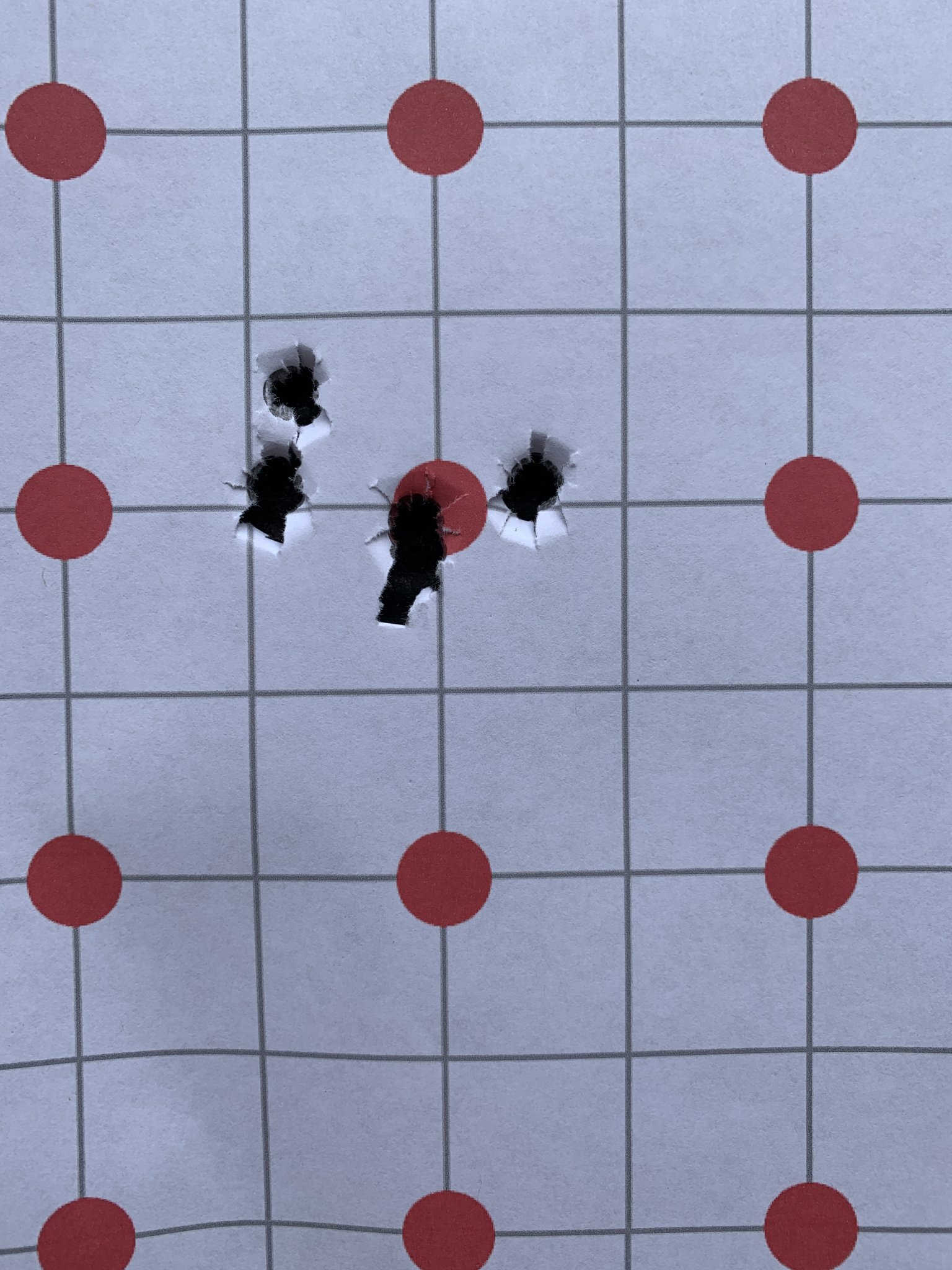

Having a similar issue with my Specwar.
Best group I can get with the can attached is about 2MOA, even with ammo tuned to the gun.

There could be several reasons, but usually when I see groups open up with a silencer attached, it means that the silencer is slightly off center the way its mounted. Not enough for a strike, but enough to disturb the bullet slightly. I suggest you check it with an alignment rod. Geissele makes them. It should look perfectly centered like this photo for optimal accuracy. You can mount and re-mount until its straight.
