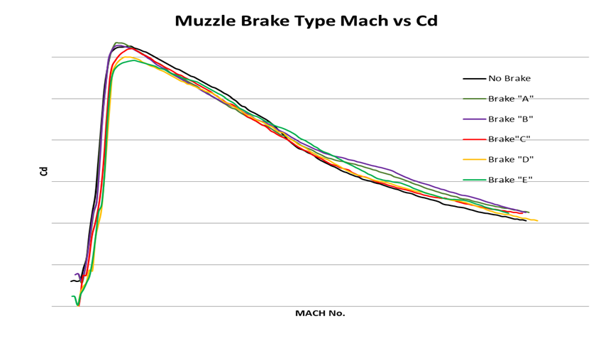

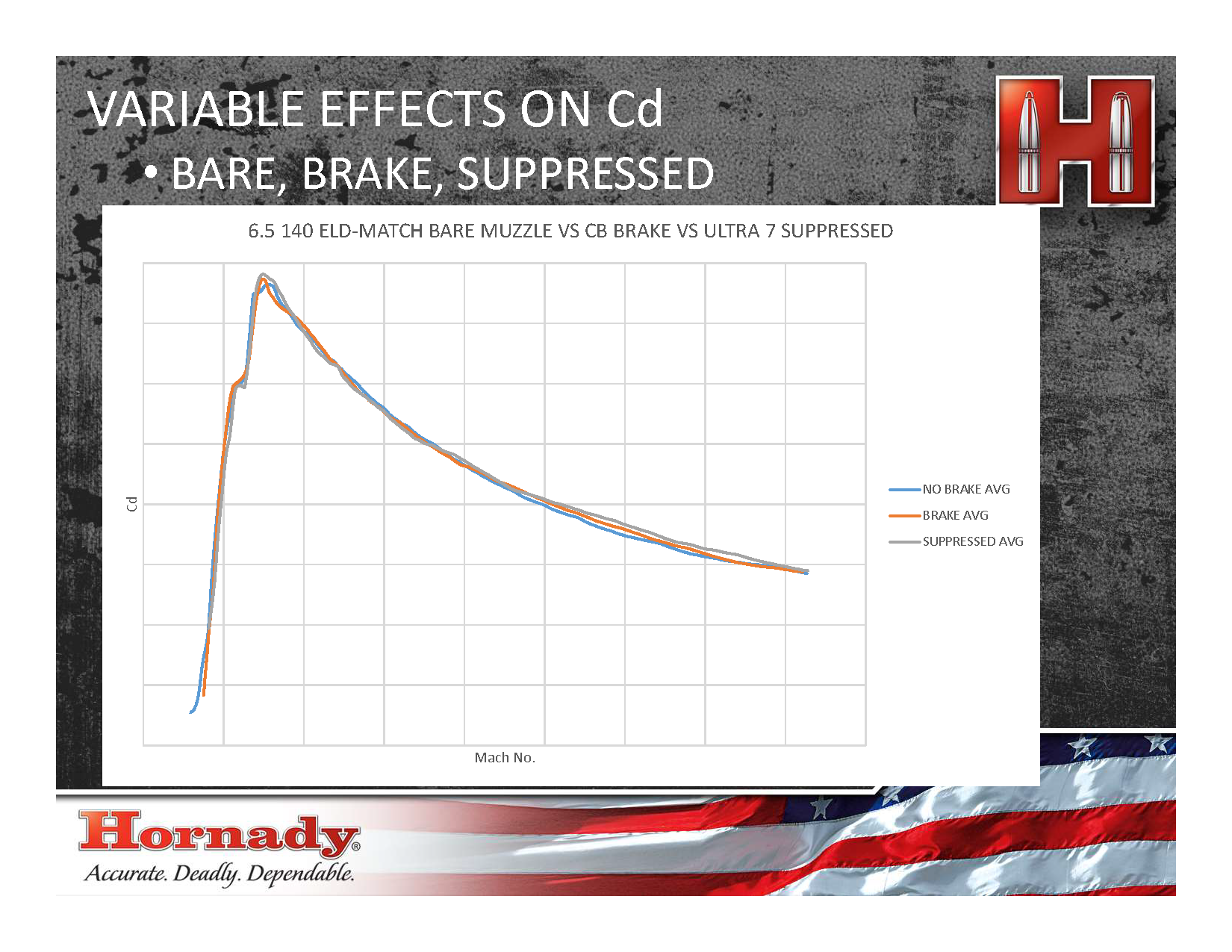

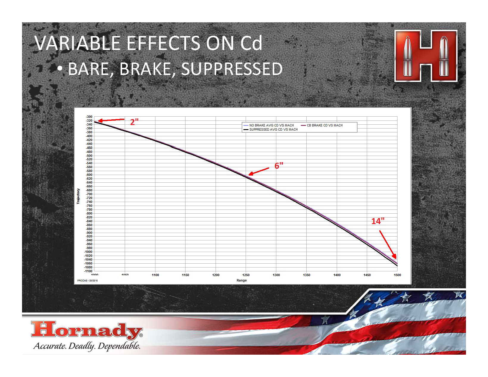

@Ledzep do you have any data showing the effect on BC broken down by bare muzzle vs suppressors vs muzzle brakes? That would be very interesting data indeed. I’m sure the drama caused would be popcorn worthy!

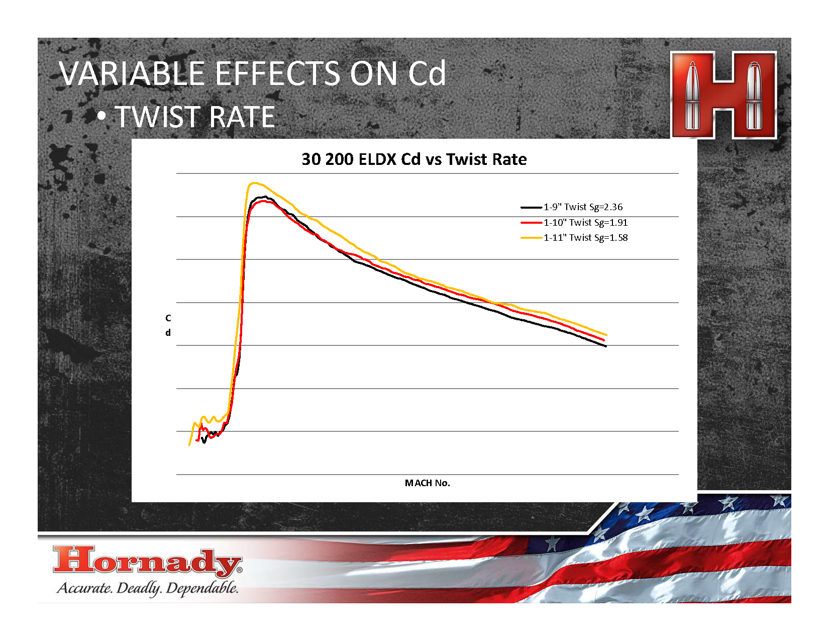

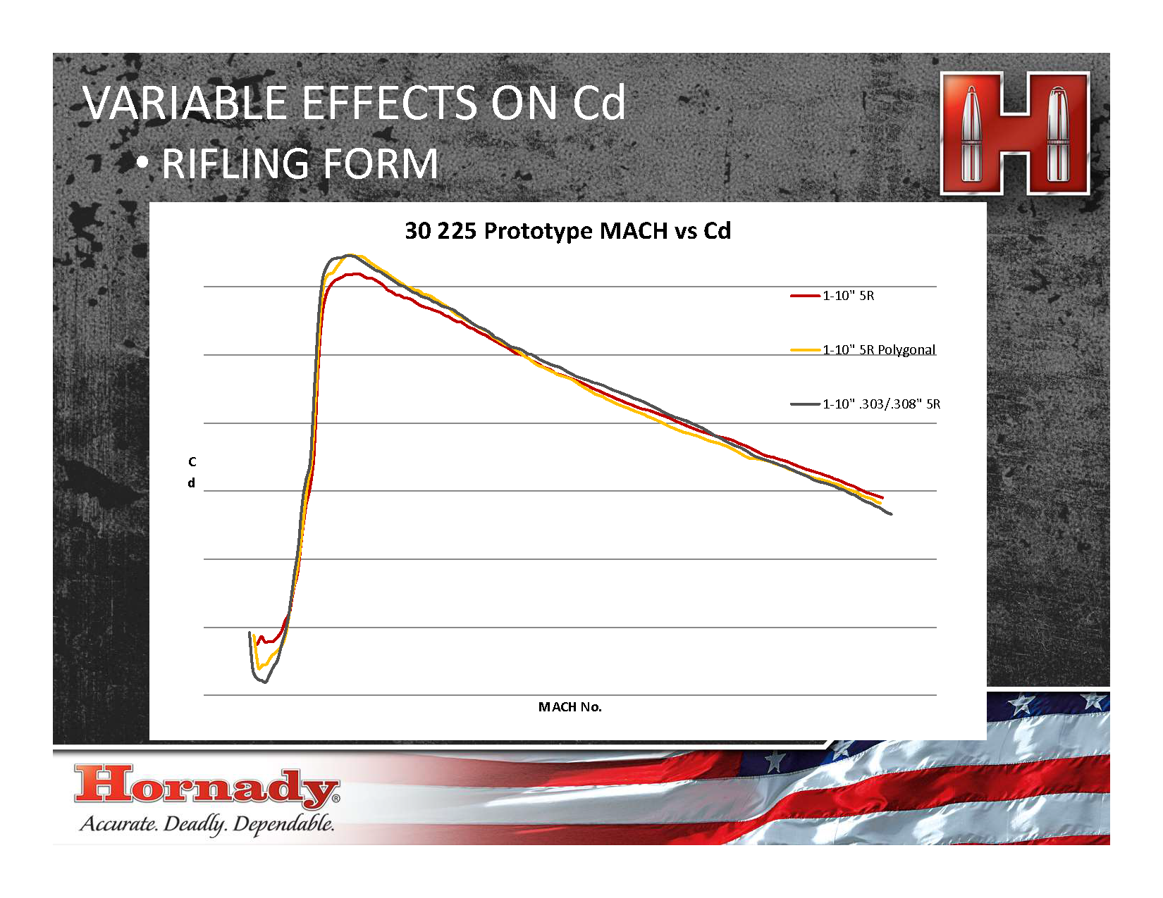

Yes we have a few examples of that. I'm asking around to make sure if I can share and if I can it will be sanitized so as not to cause any cataclysm. Some designs are definitely worse at increasing drag, but there are other metrics involved (flash, recoil, sound, etc...) so it's not an end-all-be-all metric. Again the difference is typically <3-5% on extreme swings. Twist rate typically causes bigger variation. Rifling type and barrel-to-barrel variation on this exists, too. If you could stack all of them one way and another rifle all the other way you could probably see an 8-10% difference. Luckily most of the time there's some level of cancellation around "average".
