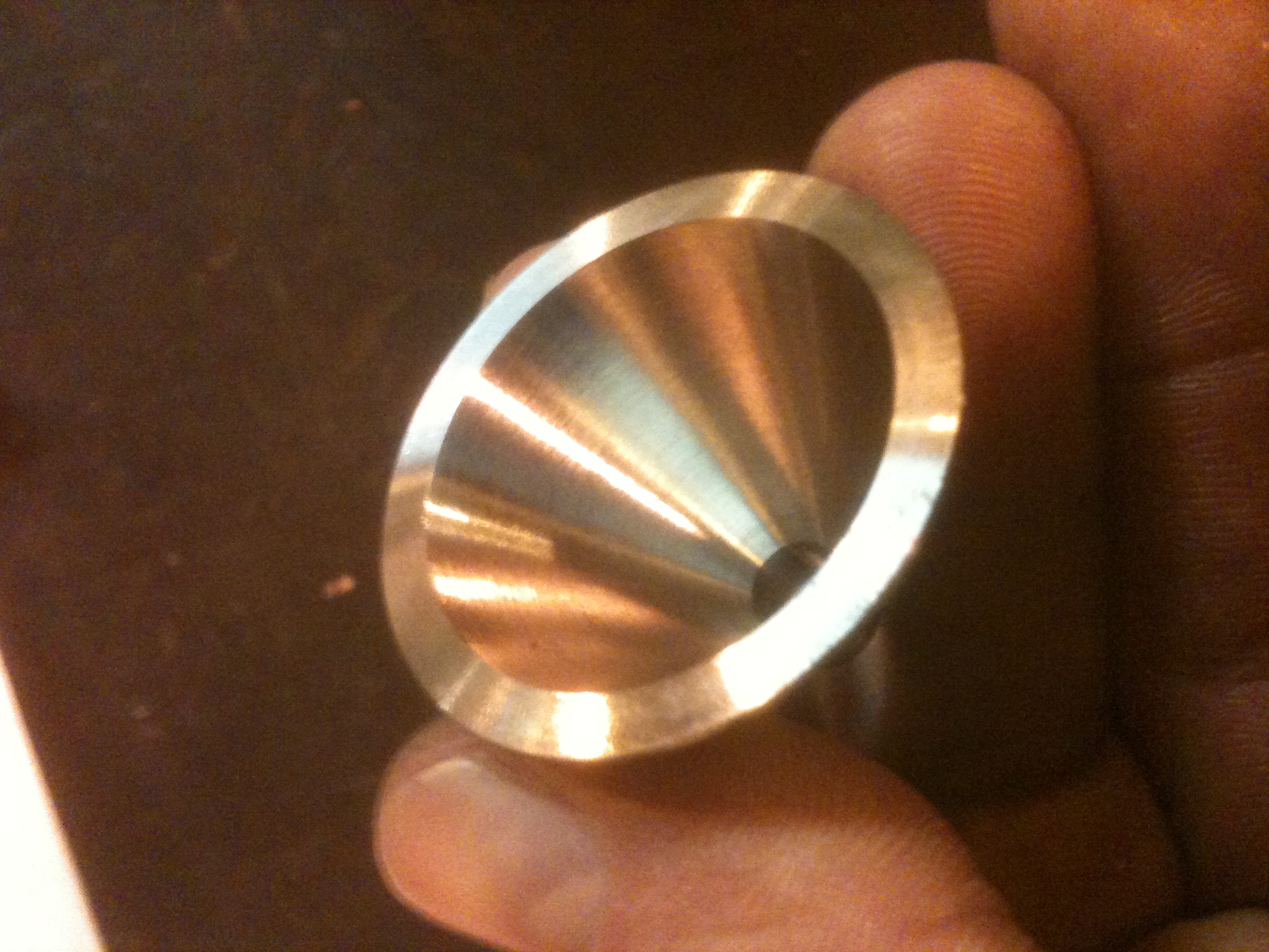

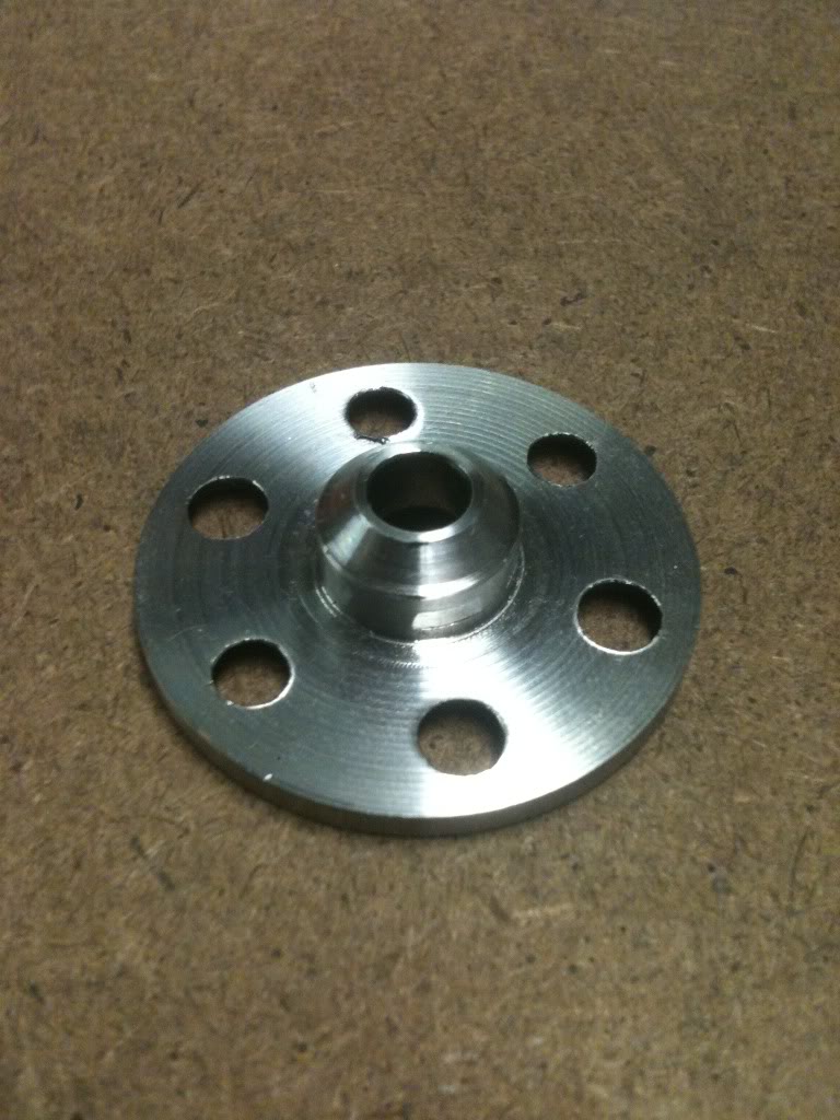

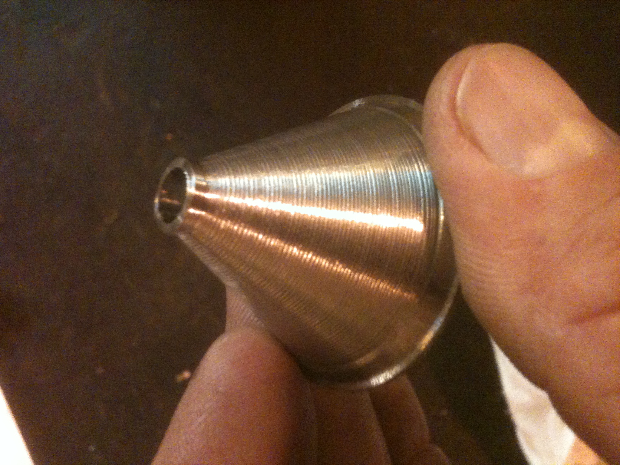

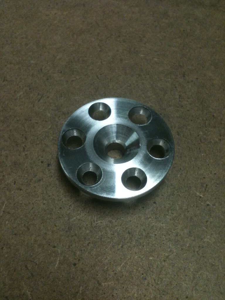

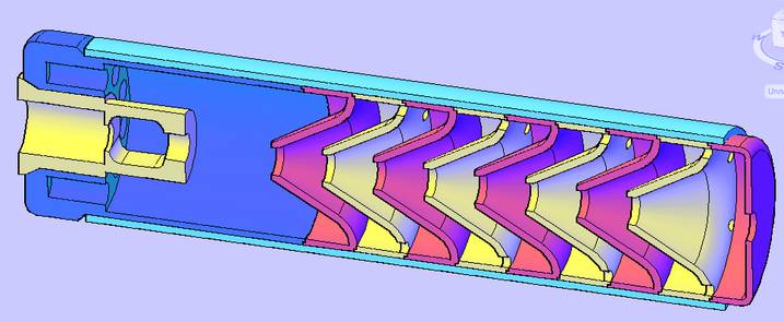

The color computer print is what I started with , I just adapted it to have a flat blast baffle to be a lot heavier built to cut down on erosion , the baffles on the print look to be one piece with the spacer but they are not , the con sit on top of a piece of thin wall tube as a spacer (.025" wall).
The cones are made from 316L SS and the blast baffle is made from 17-4 SS , the grooves in the frond side of the cone were made on purpose to give the surface some "texture" for the gas to deal with , I don't know if it made a difference but it coulden't have hurt.
