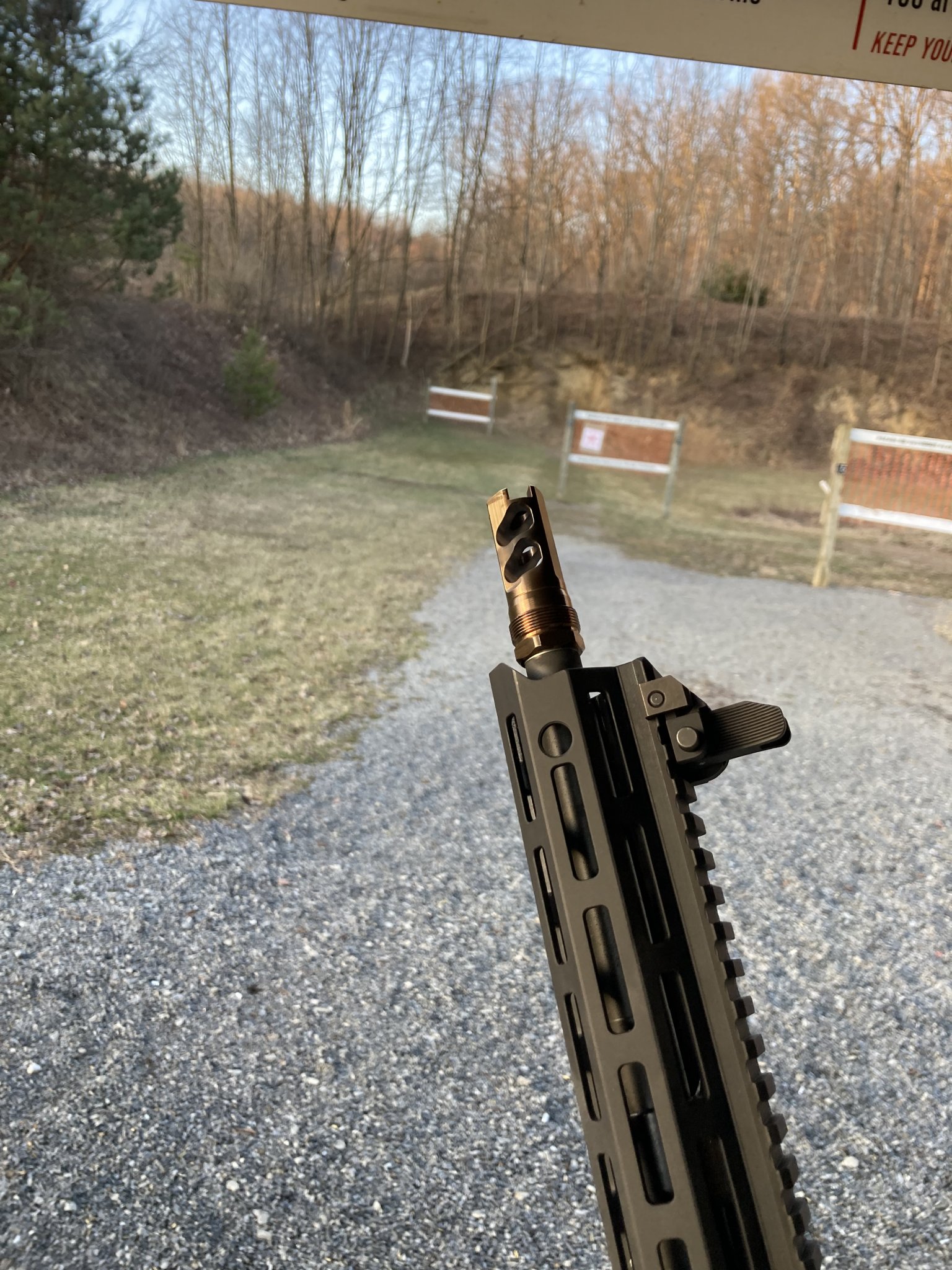

Going with Rearden for my Nomad. Just took my first shots with their DPB.
Reactions: kthomas

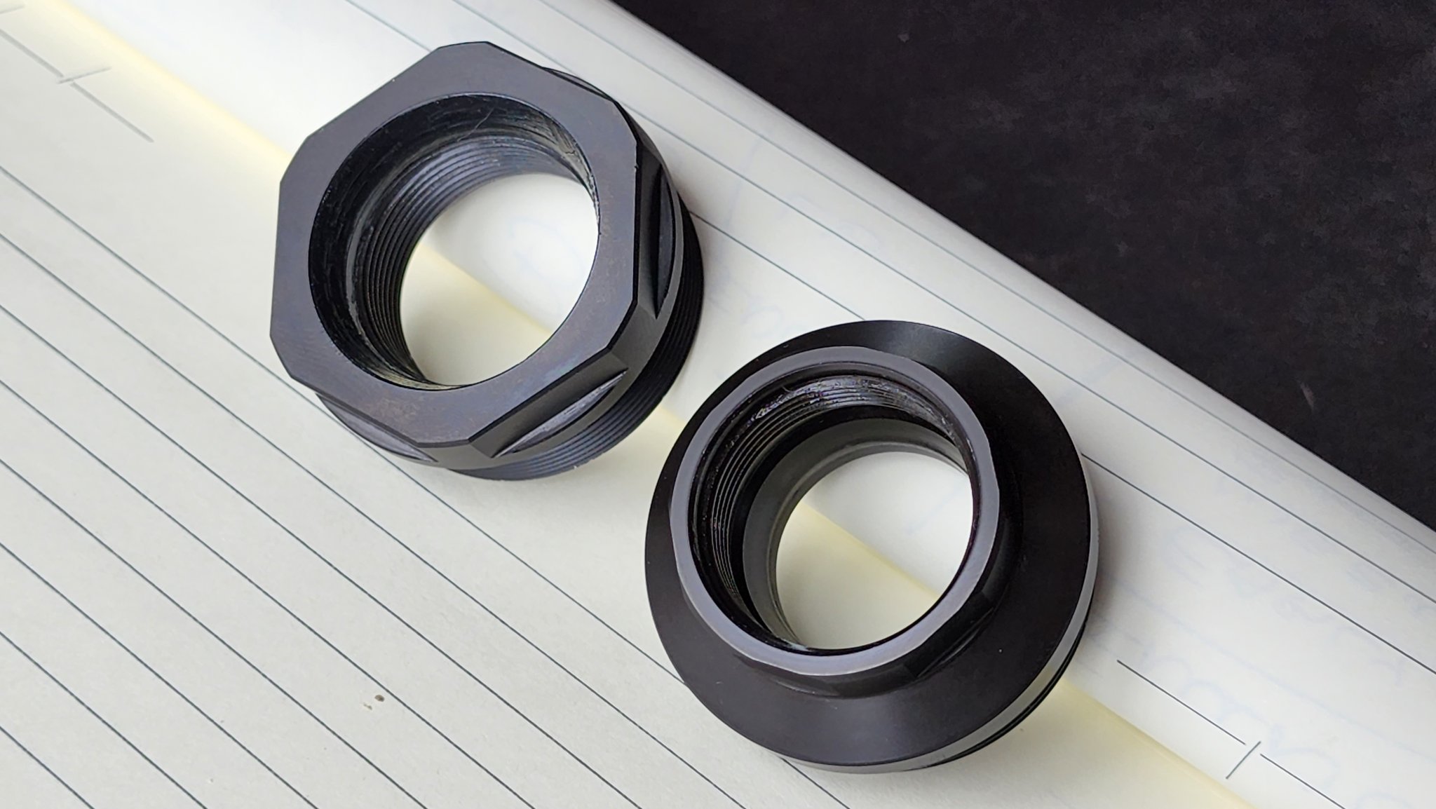

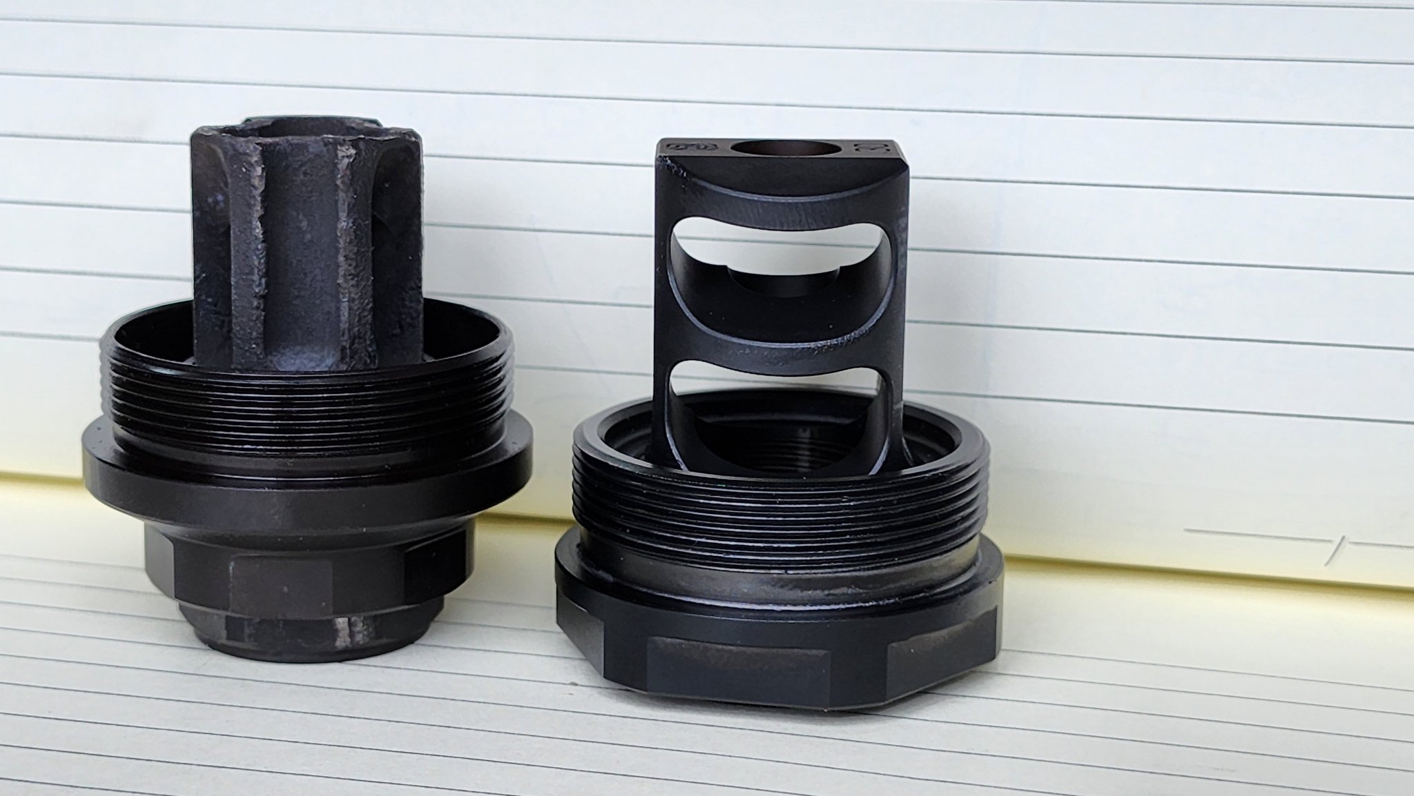

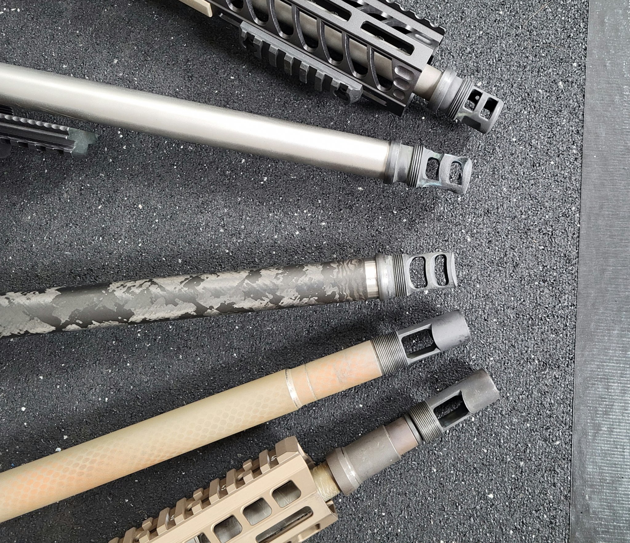

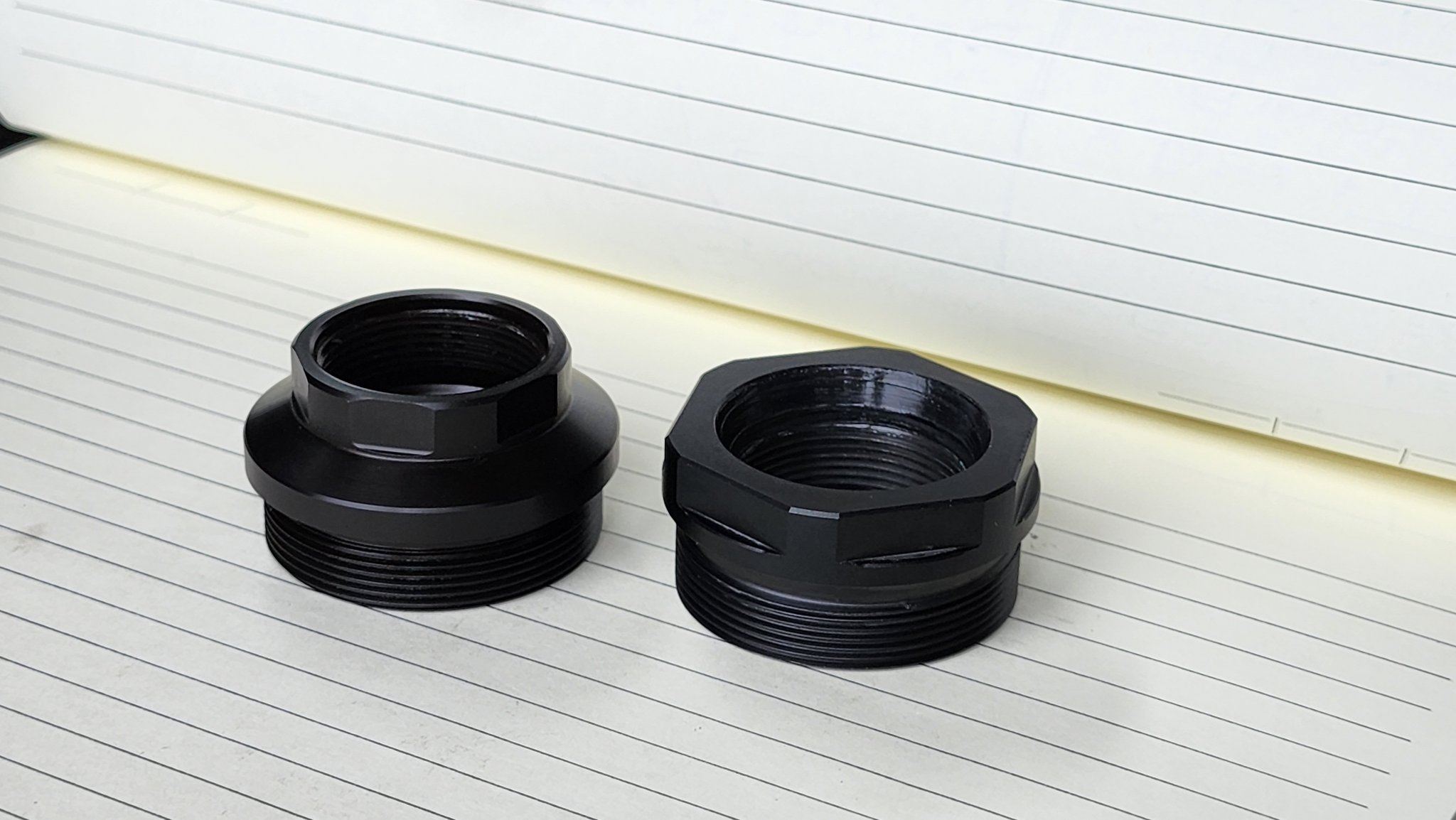

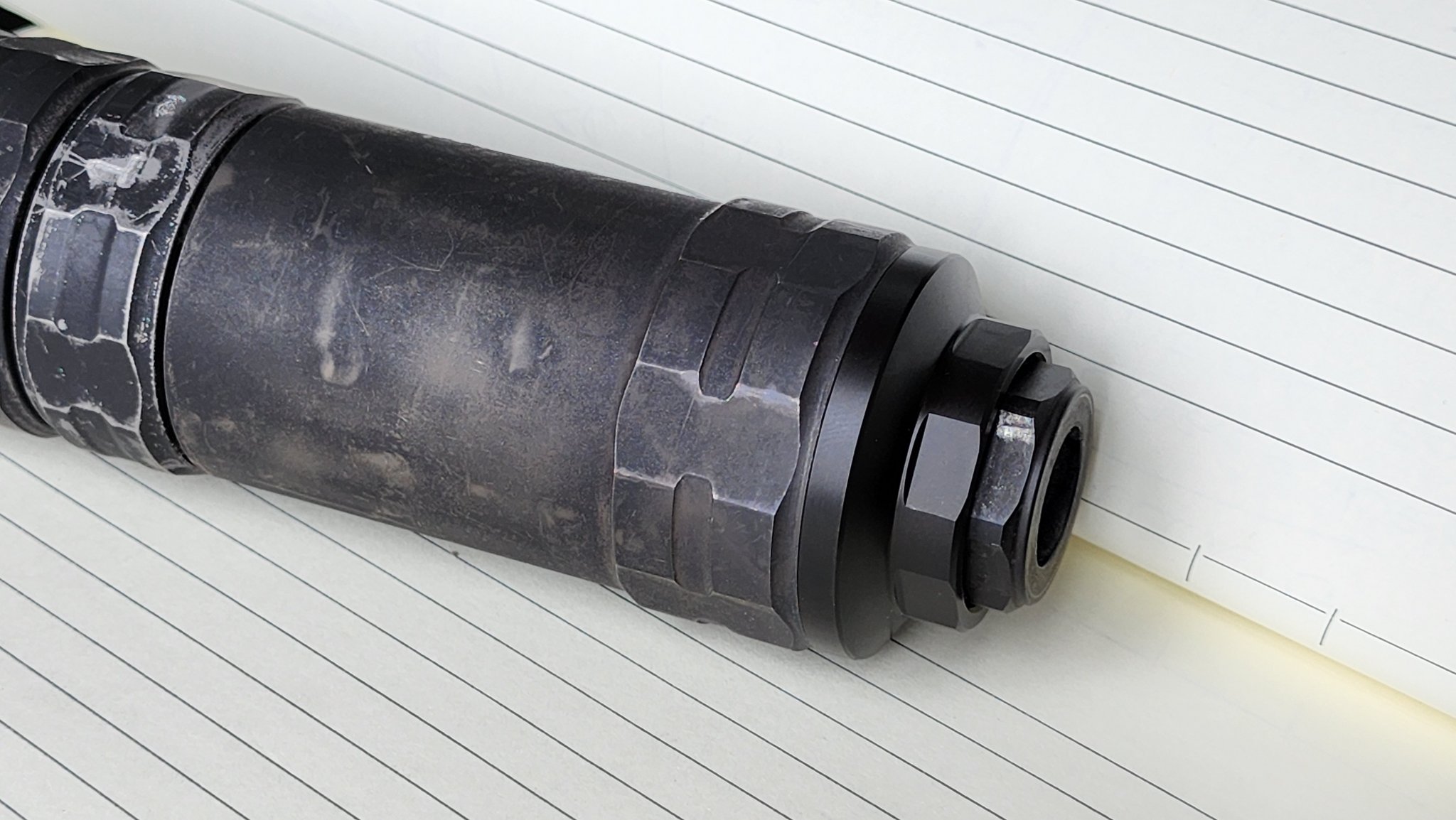

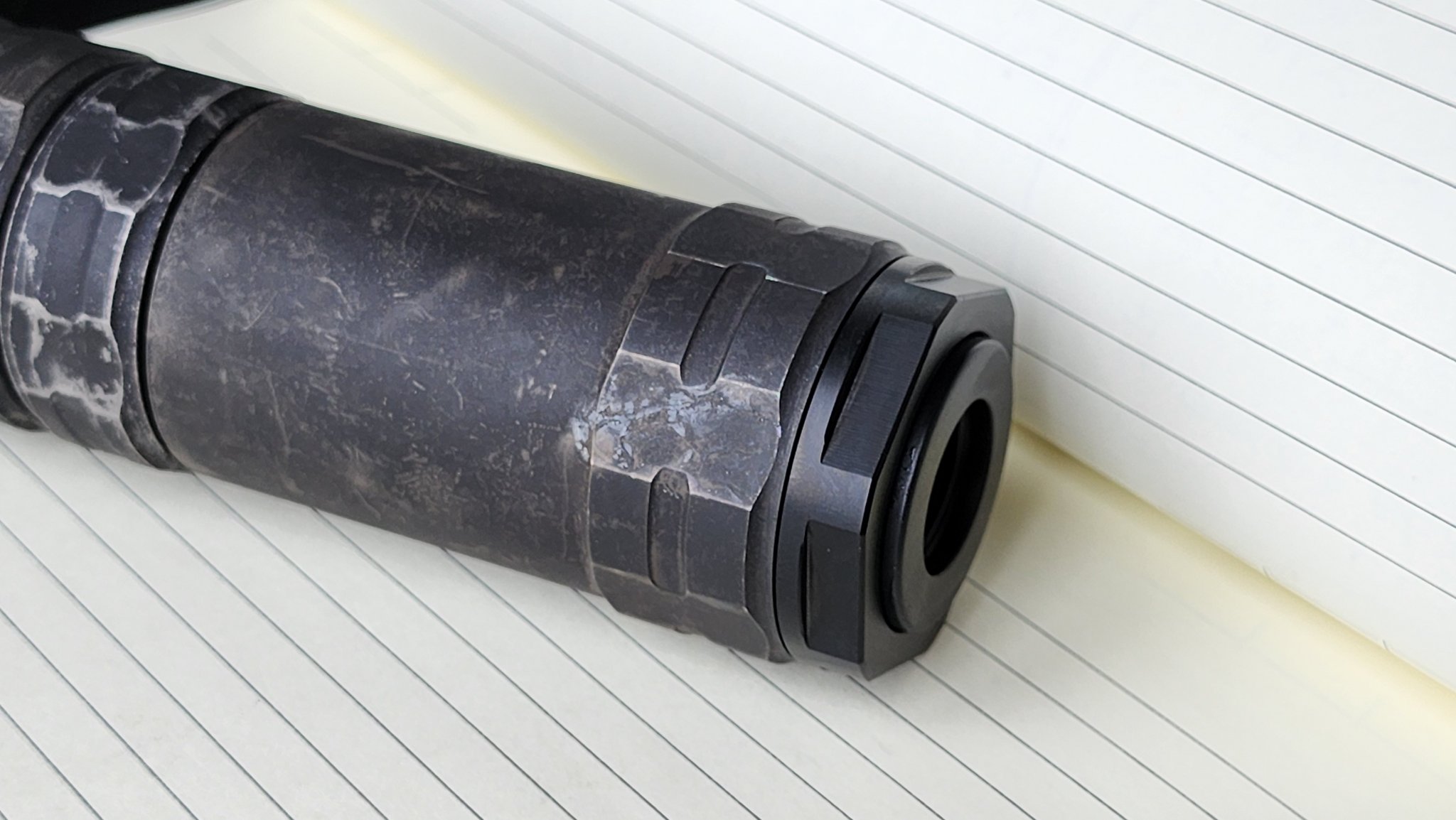

As far as taper mounts go, I am partial to the TBAC CB system using the Energetic Armament HUB mount with TBAC muzzle devices (super short OAL) or Q plan B system using the Rearden Atlas HUB mount with Rearden or Liberty Precision Machine muzzle devices.
Energetic Armament CB Left, Rearden Atlas Plan B Right:
Rearden Atlas Plan B Left, Energetic Armament CB Right:
Rearden Atlas Plan B + Liberty Precision Machine Flash Hider Left, Energetic Armament CB + TBAC CB 2 Port Brake Right:
Rearden Atlas HUB Plan B mount on one of my cans with the Liberty Precision Machine Flash Hider mounted inside:
Energetic Armament HUB CB mount on one of my cans with the TBAC CB 2 Port Brake mounted inside:
The CB system is tried and true for precision applications with a high degree of repeatability. Pretty awesome of Energetic Armament to make a HUB mounting system for it, I have swapped two of my weapons and one can over to it. My Rearden Atlas Plan B + LPM muzzle device combo has been abused beyond belief across multiple systems and has yet to walk off.
Both are excellent, elegant, and simple suppressor mounting solutions that work very well. The key to using taper mount systems period is a high temp thread lock on the mount-suppressor threads as well as the muzzle brake-barrel threads; I prefer Rocksett. Additionally, putting some grease onto the taper will help keep them from seizing. A little goes a long way here and has not caused my can to walk off either.
Links:
EA HUB CB (TB/ThunderBeast) Mount:
Rearden Atlas HUB (and other threads) Plan B Mount:
TBAC muzzle devices:
Plan B style Rearden Muzzle Devices:
Plan B style Liberty Precision Machine Muzzle Devices
Reactions: Craqas and kthomas

The only things you are gaining by adding a muzzle device are 1) a sacrificial blast baffle in the suppressor 2) a quick detach system instead of direct thread 3) the ability to use a muzzle device for recoil control or flash mitigation without a suppressor attached and without any change to the system otherwise.
If a muzzle device is having an effect on performance in terms of sound signature, it is likely within the margin of error that human ear cannot perceive a difference.
Ok thanks appreciate it! Wasn't sure if there were issues specifically with the blast chamber or flash signature performance depending on length, port placement, etc... Sent an email to Capitol Armory to see if the EA muzzle device will even fit the Sierra5. I'm likely a good five months out based on my last suppressor so I have some time, LOL.
No problem! For fitment the measurement you are looking for is "projection" inside the suppressor. Basically, you're looking to confirm once you stack up the suppressor mount and muzzle device that the blast baffle isn't interfering with the muzzle device.
