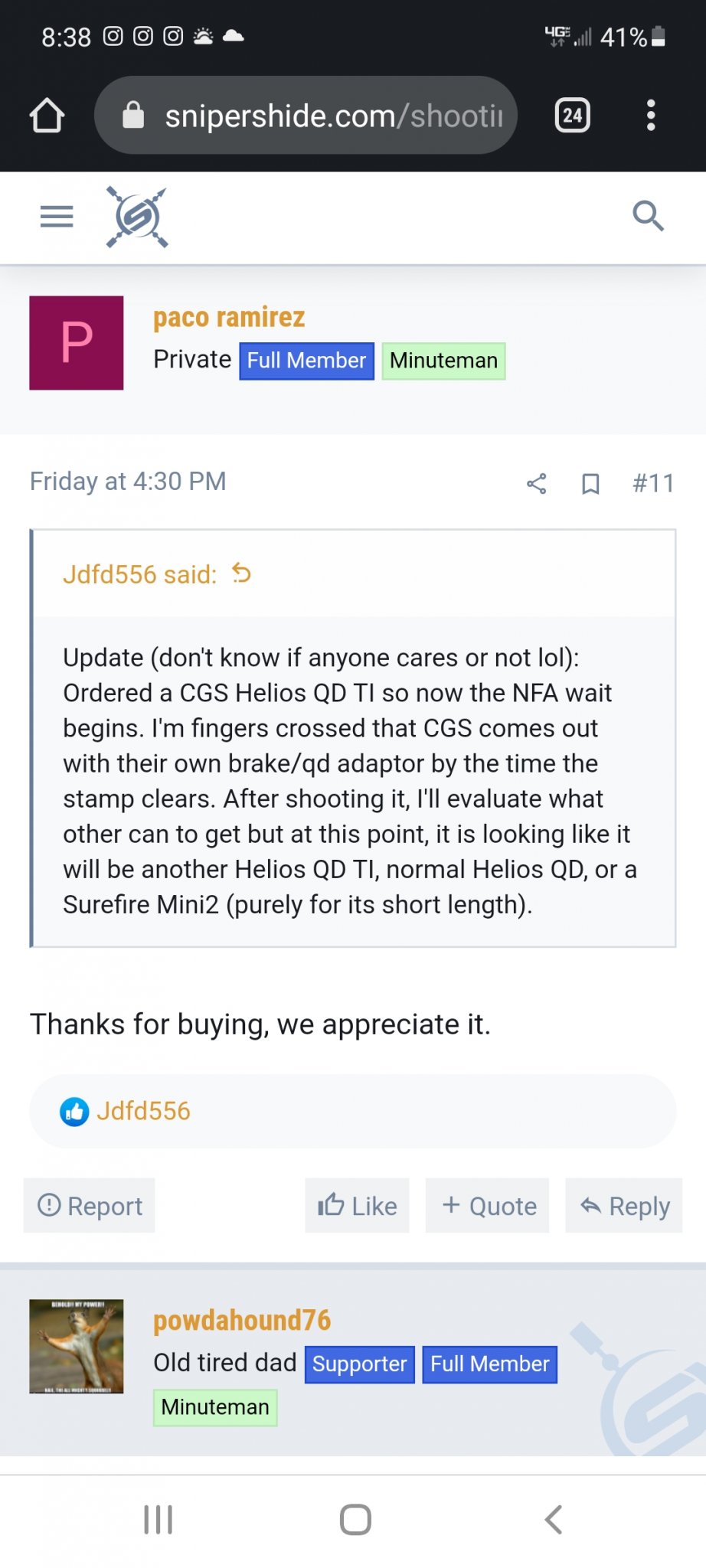

Update (don't know if anyone cares or not lol): Ordered a CGS Helios QD TI so now the NFA wait begins. I'm fingers crossed that CGS comes out with their own brake/qd adaptor by the time the stamp clears. After shooting it, I'll evaluate what other can to get but at this point, it is looking like it will be another Helios QD TI, normal Helios QD, or a Surefire Mini2 (purely for its short length).
Thanks for buying, we appreciate it.
