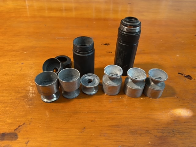

I just got a Frankford tumbler to clean my brass and was wondering can I put my OSS RAS 22 baffles in with pins and a solution to clean or even dry media.
Or is the correct way is by ultra sonic only?
I didn’t have any luck with tumbler or sonic cleaner. I had to put my baffles in a blast cabinet and get the lead off. Be careful if your baffles are aluminum cause some cleaners will eat them up. If I remember correctly the manufacturer of my suppressor said blast cabinet was the only effective way to clean a 22 can.

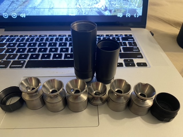

I put the stainless steel baffles for my 9mm and .22LR cans in the Frankford Arsenal tumbler.
My recipe is about 30 ML of citric acid and a splash of Dawn dish-washing soap along with the steel pins that came with the tumbler. The measuring cup for 30 ML is the cup that you get with a bottle of NyQuil.
I set the timer for 3 hours and they come out looking like new. Sometimes, I might have to use a fresh solution for a 2nd tumble but that beats me scrubbing everything with a toothbrush.
I rinse the baffles, dry with a towel then put them in the case dryer before they go back in the can.

I just tumbled the internals of my 22 Mask and they came out looking like new. I'm going to heat them tomorrow and drop in silicone and see if that helps with the maintenance.
I put the core of my silencerco sparrow (SS) in my stainless tumbler with a little dish soap after soaking it for a few hours in CLR. It came out looking brand new. Much easier than scrapping by hand.
