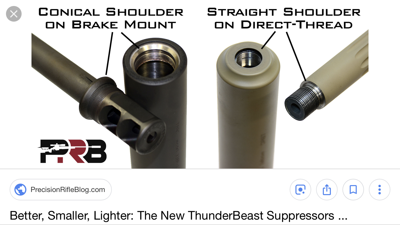

Last thing, the way the CB mount works is a tapered Shoulder at the rear of the brake and a matching taper in the back of the suppressor. When you thread the can onto the brake the 2 tapers make contact which helps center the can and then creates friction which hold the can in place. More surface area equals more friction which the taper create more surface area. Here is a picture to help you visualize.

Thanks for all the information but another stupid question. I understand how a brake works. But if you put one inside a can, does it not function properly? Then your primary advantage is that you regain the ability to go between your guns that all have breaks??
If will be easier for me as all my guns have the same thread patterns.
i started with the TB brake on 2 different rifles with an ultra 7 and 9. Its like the brake becomes part of the can once you put it on. you dont notice the brake. I now use the Area 419 adapters and brakes which are more effective. I can switch from brake to cans from the 2 rifles with the 419 adapters and there is no change at 1k. i can even swap cans with no change. Rifles were also built by area 419. TB makes the best can out there, 419 just makes it better and more versatile.
If the suppressor is installed onto the brake, the brake is not going to reduce recoil since the gasses are not being vented into the air to reduce recoil, they are being vented into the can. The suppressor still reduced recoil just not as much as a brake.
And the brake acts as a set of sacrificial baffles to protect the inside of the can from erosion of the first baffle. The direct thread cans just have a mount (can't remember if it's a brake or FH or something different) permanently mounted inside. TBAC can actually convert a direct thread to CB for a small fee.

TBAC's thread over brake is better than using the direct thread for a few reasons, mainly which is the bevel and size of the mount compared to a smaller direct thread and a narrow flat shoulder. So yeah, the brakes are better than direct thread. Shit sure has changed, even in the last decade. Mostly with mounts. There is no lock on the brake and it's the closest you can get to a direct thread without any of the problems of direct thread.

The DT version weighs the same as the CB + brake. They are machined the same, the DT is a CB that has a brake semi-permanently thread locked inside. TBAC can convert an existing Ultra from one configuration to the other for a nominal shop fee.
Reactions: Kylejohn33
The CB has two huge advantages over the DT. One, tighter lockup due to the larger bearing surface area. Second, each brake acts as a thread adapter. My Ultra 9 CB swaps between my AI (M18x1.5 thread), Badger Ordnance and Rem 700 (5/8x24 thread) and AR-15s (1/2x28 thread).
