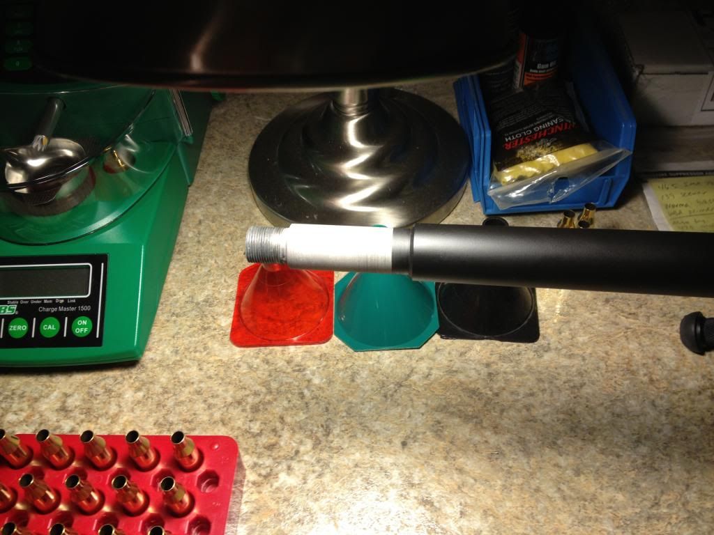

    Chad, you have to contour the barrel to .775" for 2.75" back from the muzzle, here are some pics from my SureFire MB762SSAL RE Muzzle Brake which I'm pretty sure is the same demisions as the SOCOM when you are talking about the barrel profile. Also I sent you a PM about a barrel job. Thanks

    -UPDATE:
    In spite of this pending winter storm warning were facing, the heavens opened, the clouds parted, and a little ray of sunlight shined on my fat ugly face.
    "Chuck" from Surefire stumbled onto this post and was kind enough to give me a call. Sorry germs, all you guys were wrong and I'd of installed yet another brake incorrectly.
    The SFMB-762-5/8-24 goes on like this:
    Turn a cylinder to an OD appropiate for 5/8-24 2A dimension.
    Cylinder length should be .625 from muzzle to shoulder.
    Thread to a 2A thread pitch diameter.
    The full thread form needs to be within .100" from the shoulder. Otherwise the brake gets pinched from the thread getting shallower and it fails to clam up against the shoulder.
    Install and time the brake accordingly.
    That's it. This brake has a projection on the back of the shoulder that serves as the standoff. This eliminates the need to turn back the barrel OD/shoulder depth qualified off the crown.
