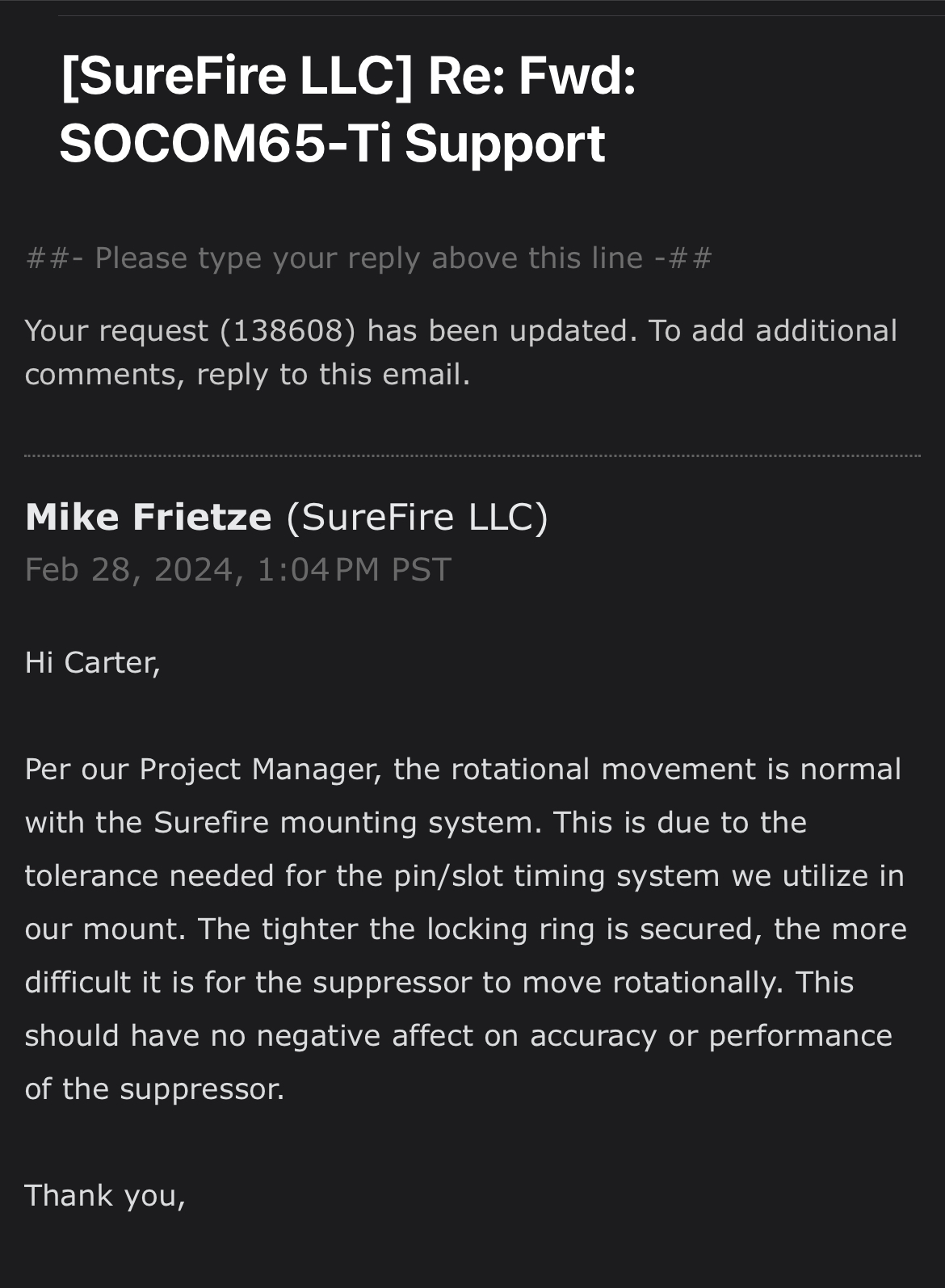

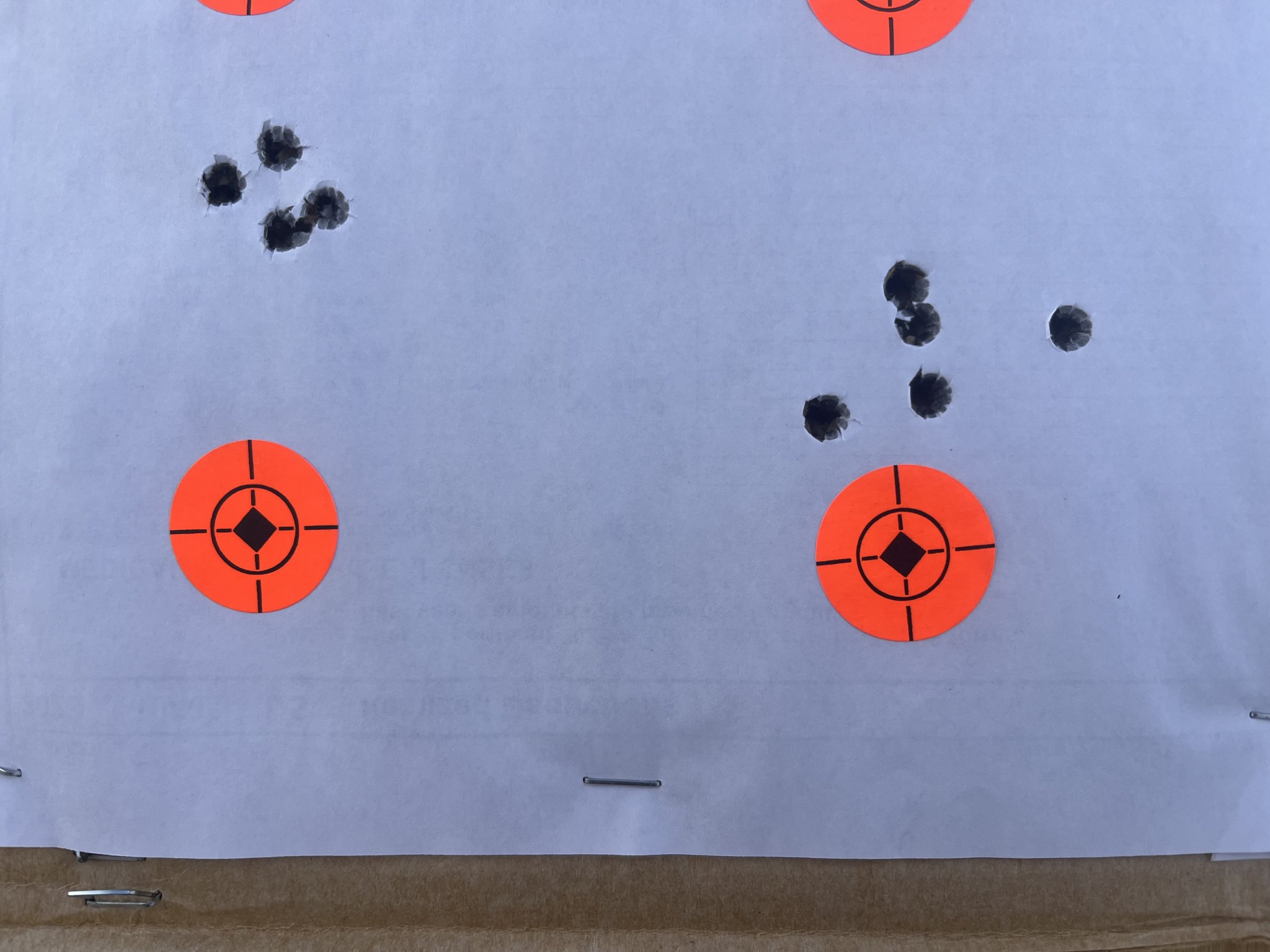

SureFire’s responce below. It just pisses me off a little saying this won’t effect accuracy. I’d consider it a known fact that a can that you could move around with your bare hand would affect accuracy. I even sent them pictures of groups with the can and with out. When the can had the slight wobble you can’t get it under an inch with a 5 shot group ever. Take the can off and 5 shots look like 3 or 4 shots every time.
