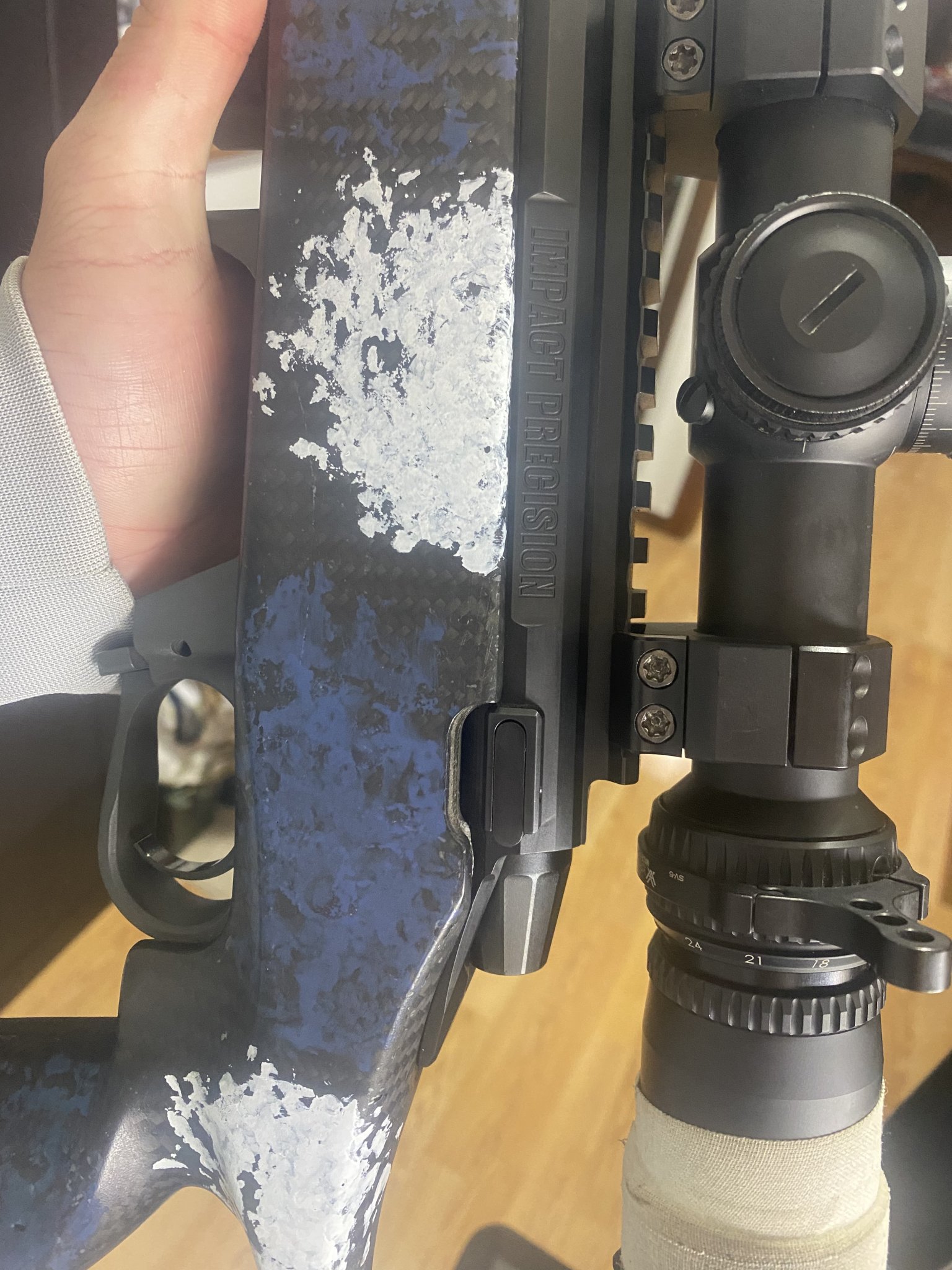

Yep. I sold my Surgeon about 6 months ago and dropped an Impact into the Surgeon inletted stock. The relief cut for bolt stop is just slightly larger for the surgeon than it would need to be for the Impact. I can take a pic tonight for you to see what I mean.

wonder if the actual bolt stop itself is thinner as well or maybe impact moved it "up"
2 birds 1 stone in their eyes
surgeon bilt stop is dead center in bolt lug cut
It looks like the bolt stop may be slightly above bolt Center, but the guard is definitely thinner as well.
