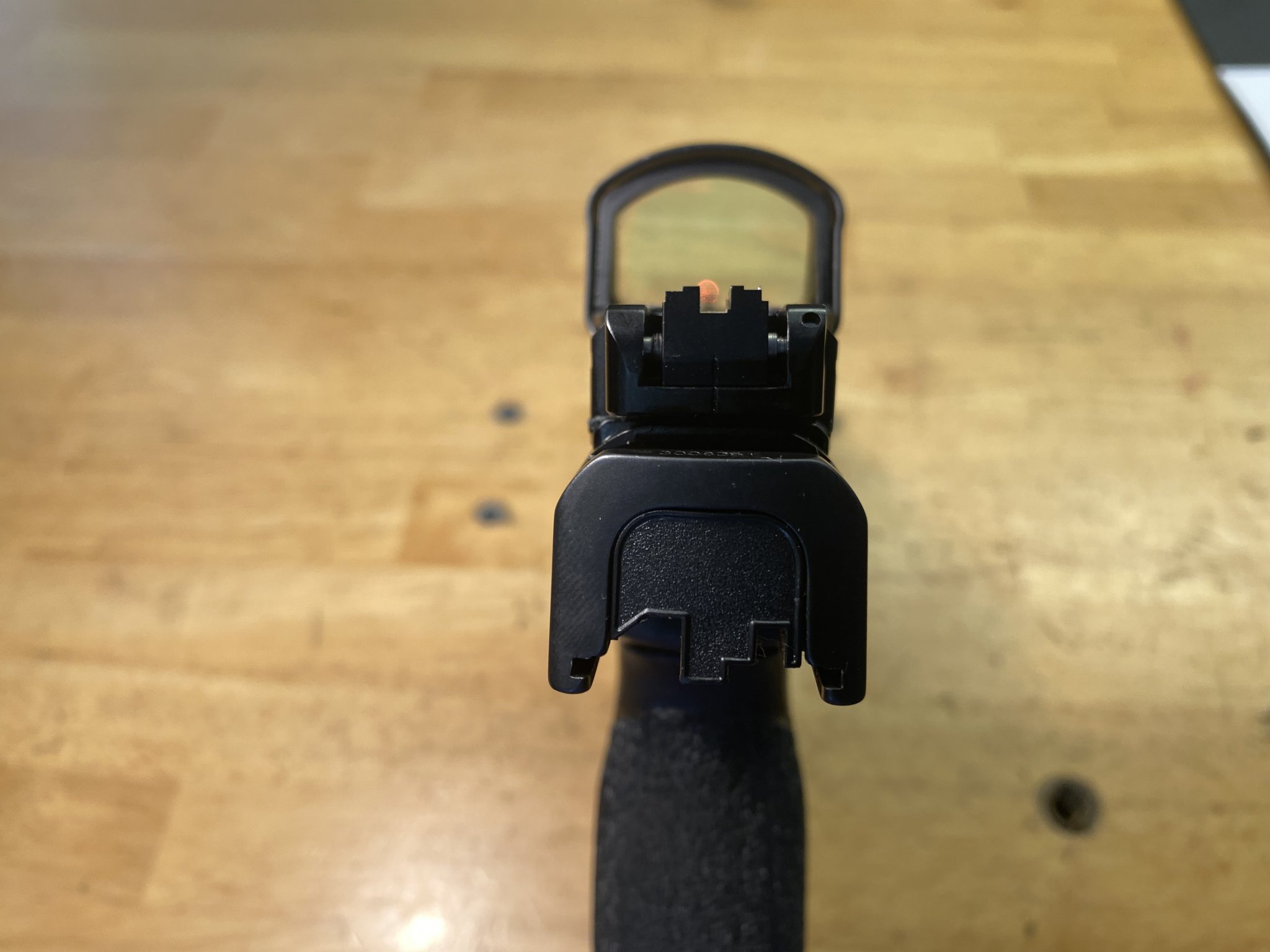

I'd get the lowest possible sights that will show up through the bottom of the glass, go for 1/4 or 1/3 co-witness- the idea is to keep the lens as uncluttered as possible. Remember they're just back up irons.
probably just going to get all blacked out irons at 1/3 and leave it at that

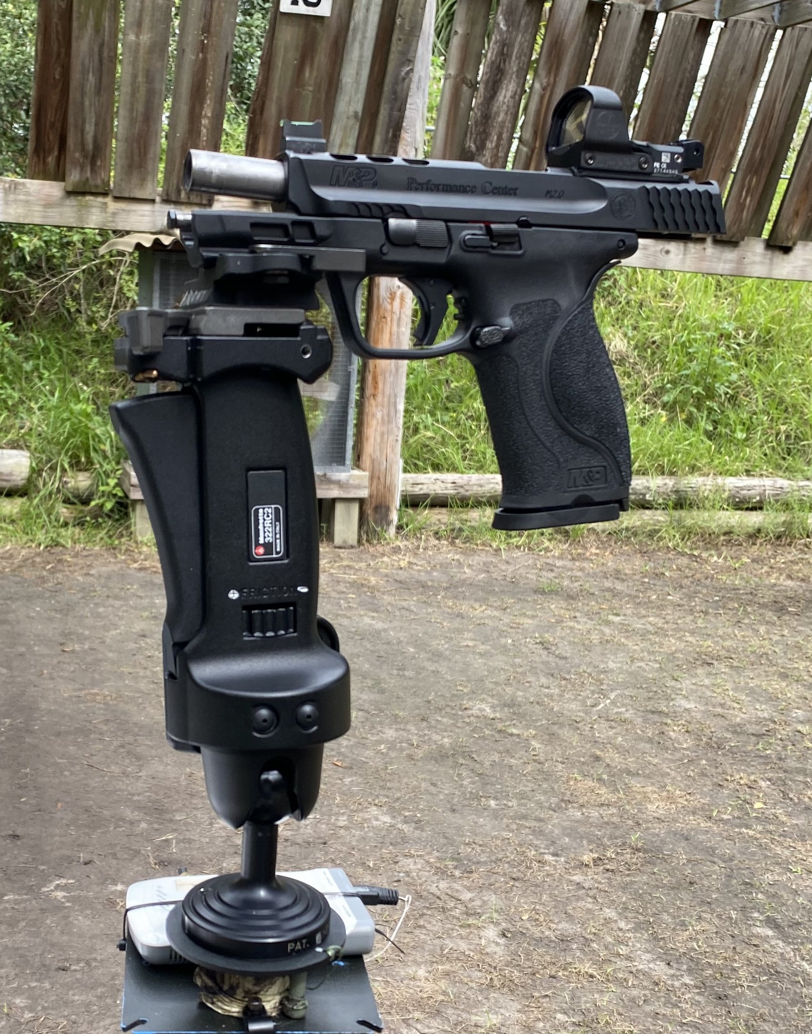

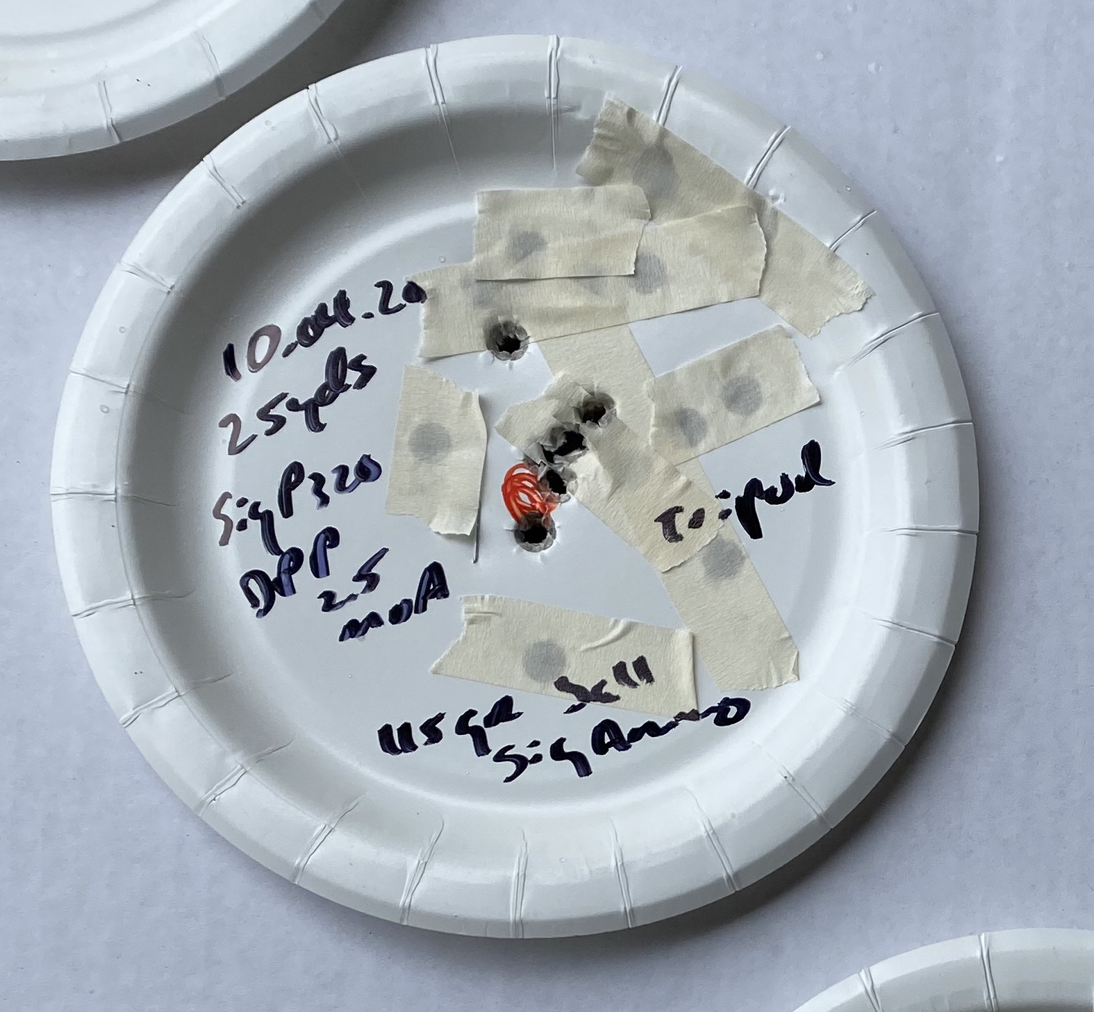

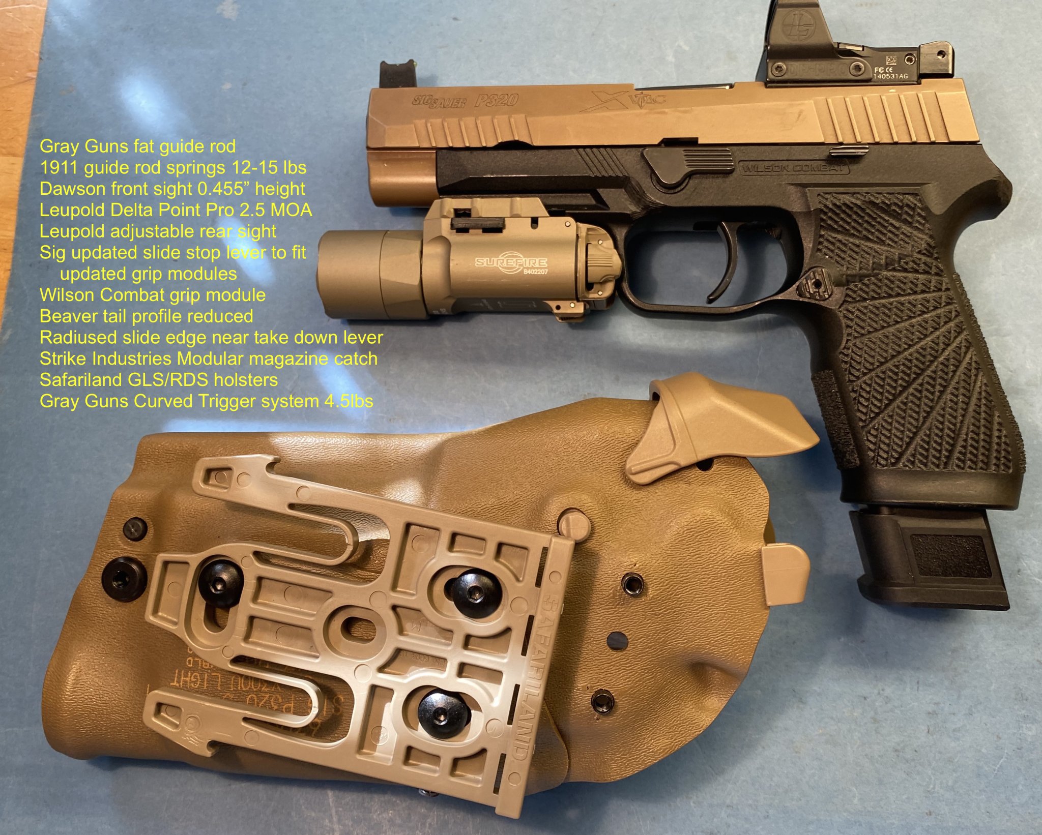

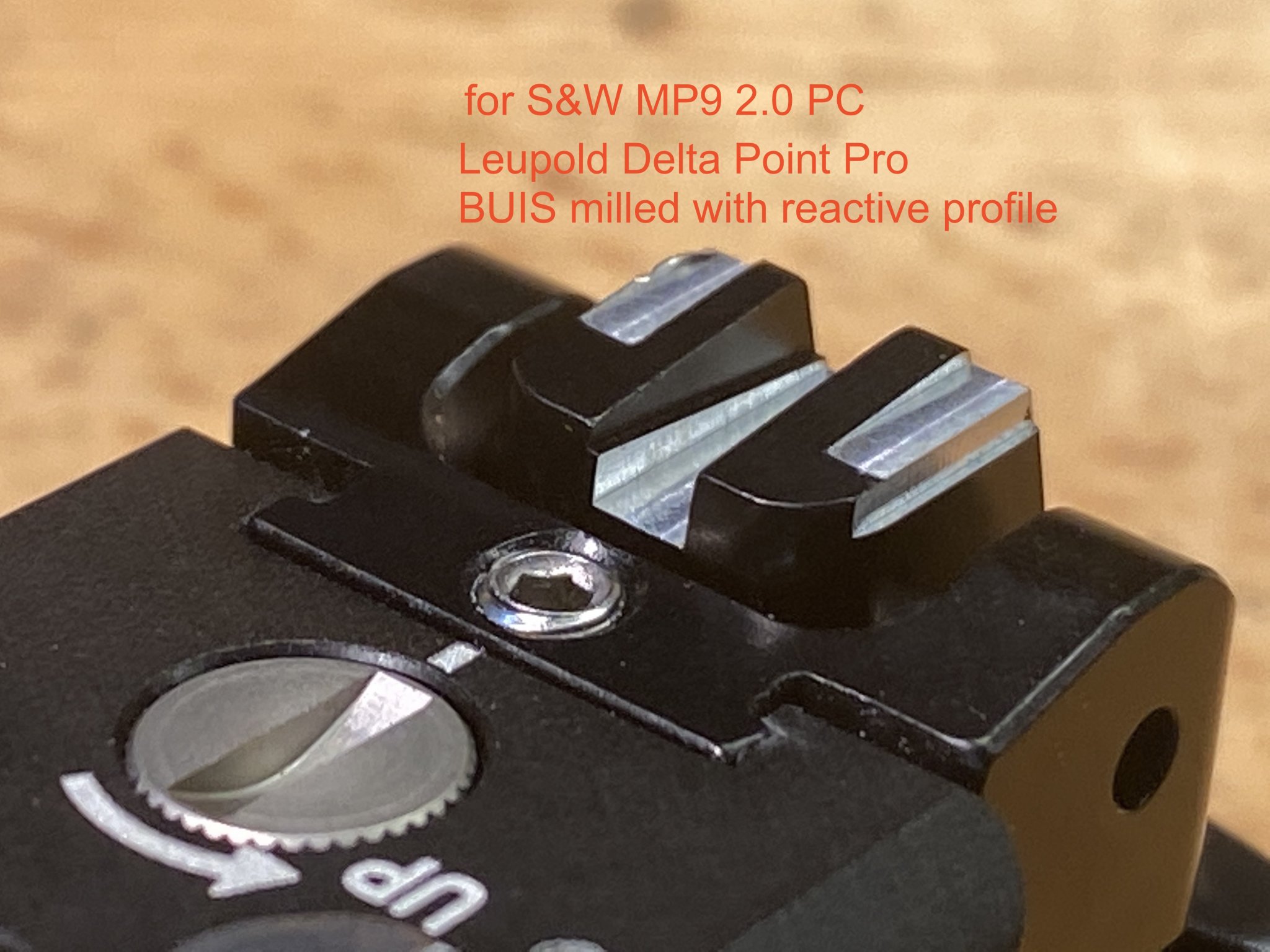

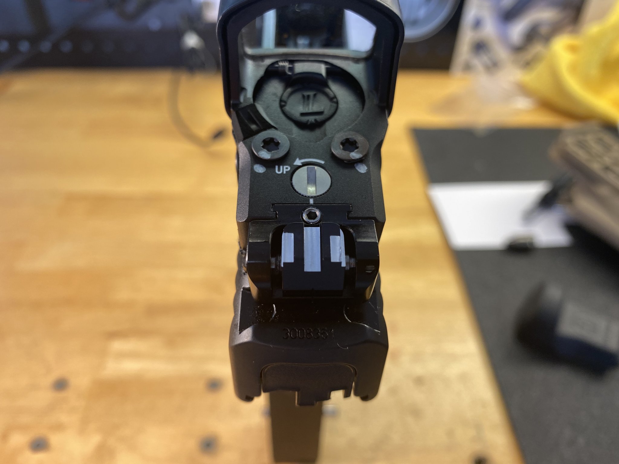

I black out all my rear sights. With RDS's Dawson has a lot of choices for front sight optics. The Leupold Delta Point Pro's have an
optional elevating rear sight; I profiled those rear sights as "reactive target sights, RTS", which are nice; milled the profile, but a steady hand
and a proper gunsmith file you could make a nice rear sight mod. to get the co-witness height to your preference. A S&W MP 2.0 Performance Center and Sig X-TAC p320 with Leupold DPP's mounted.

I went with .365 Trijicons on my 19-5. No dot yet, but they just clear with the Rugged Obsidian 9
