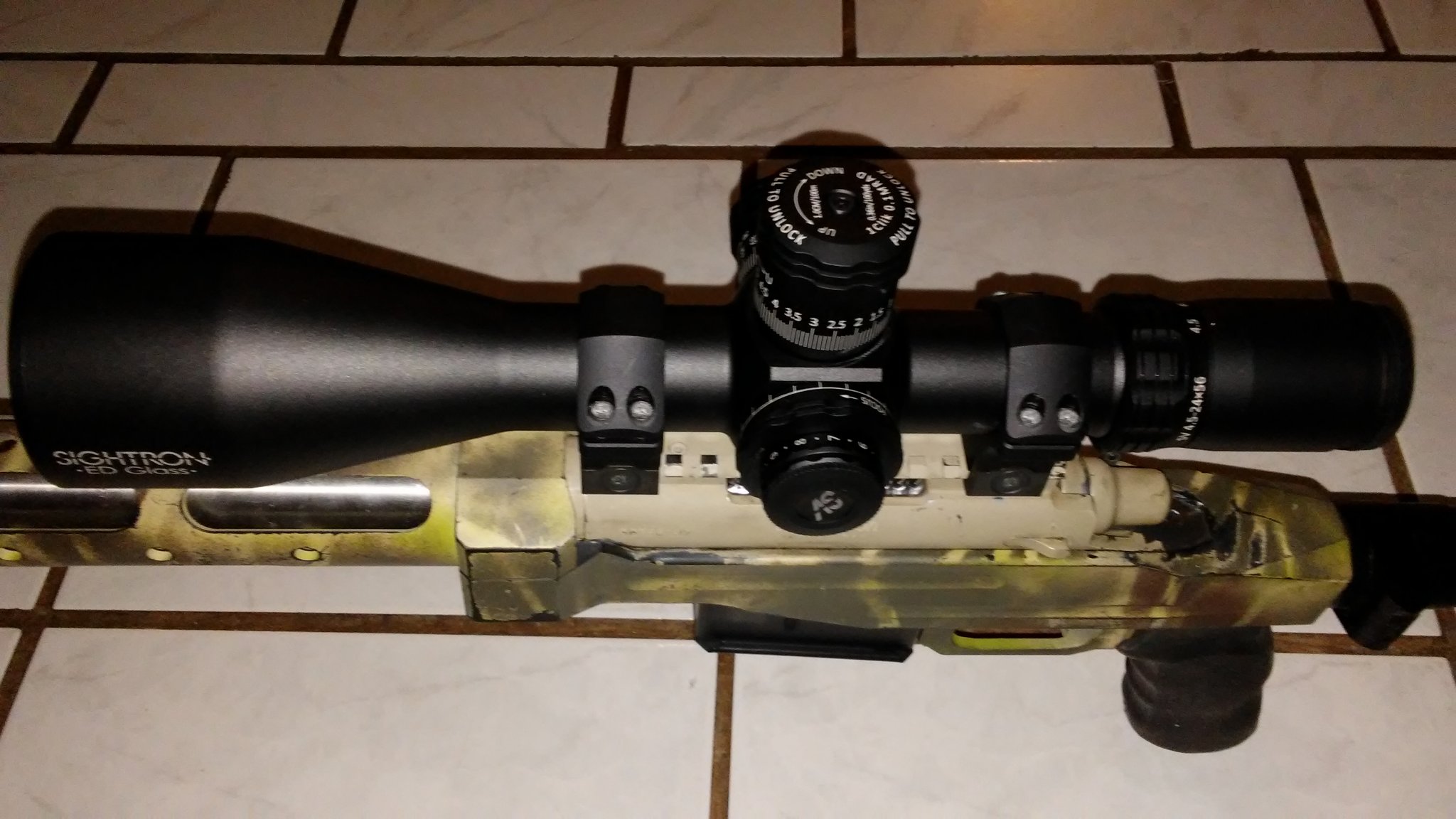

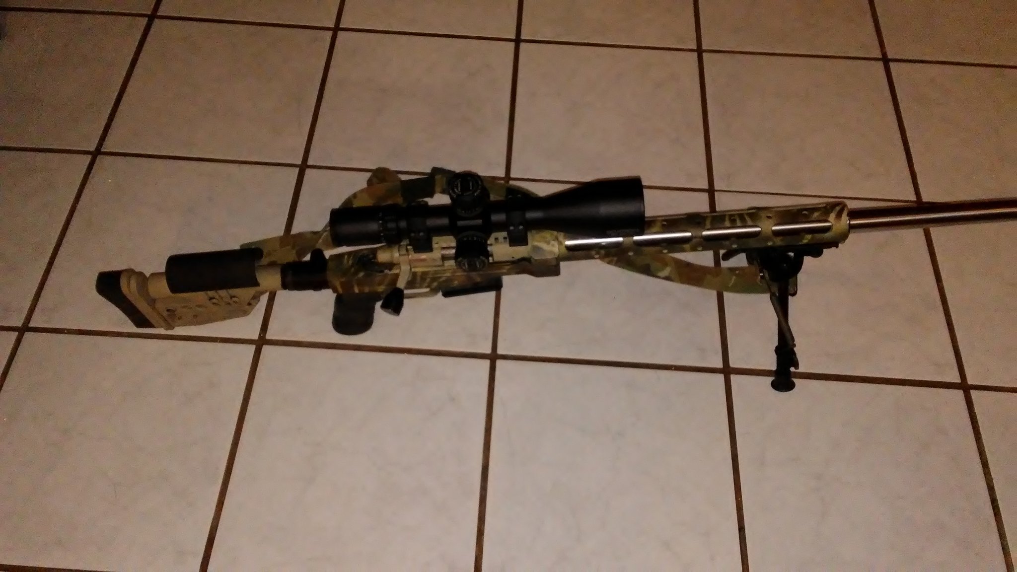

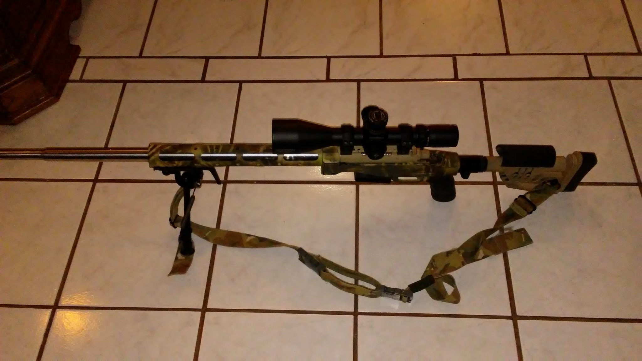

    Unfortunately, I'm feeling like shit and won't be able to get to the range for several days.

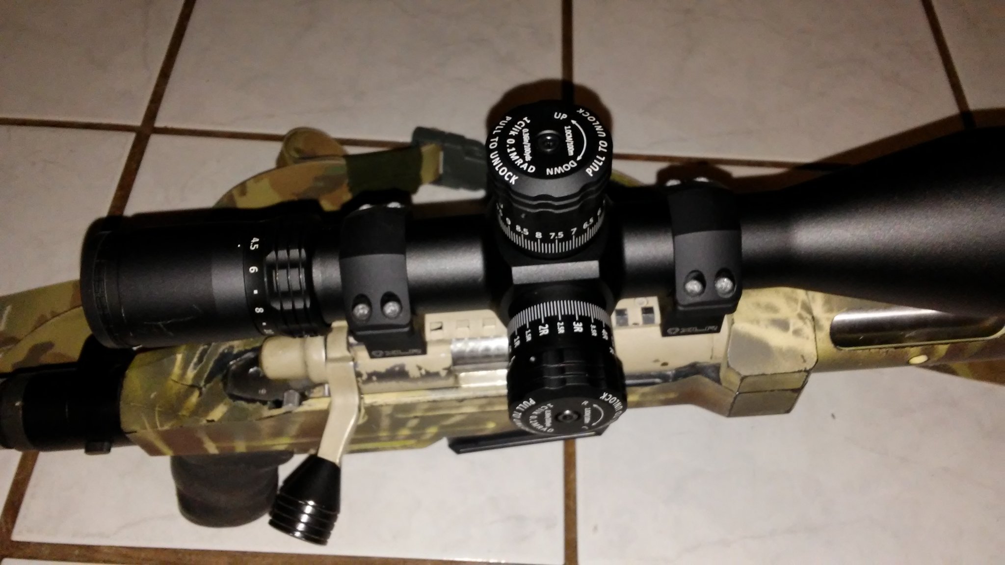

    This thing is NICE. The turrets are a bit stiff when pulling them up, very easy to push back down.
    Clicks are SOLID, no mush anywhere.
    Magnification ring turns SMOOTHLY.
    Parallax is likewise smooth.
    While holding it in my hand, I was able to focus clearly on a brick wall about 20 feet away on 24 power.
    Glass appears top shelf, reticle is clearly defined.
    Illumination switch turns with no issue (haven't installed the battery yet.
    Scope comes with a scopecoat, battery, TINY allen keysunshade.
    Finish is smooth, even matte black, lettering is subdued white.
    More to follow, I need to go mount it.
    If you're a fan of big turrets, this thing has you covered.
    Illumination lights up entire reticle.
    Reticle is a floating dot, according to the info provided, dot subtends .073 mils.
    Holdover lines are numbered every mil, windage lines are numbered every other mil.

    I'm surprised Sightron didn't feel users would want zero stop in a 24X scope with 120 moa of elevation. Can a shim be inserted like on a SWFA? Would love to see a pic with the elevation turret cap off.
    They caution against removing the center post screw, stating that damage will LIKELY occur.
    Knowing this, I’d like to know what the actual hell they were thinking... putting out a new optic lacking one of the most basic features that potential buyers are going to be looking for.
    Then to say oh no, there’s no aftermarket options without damaging it? That’s laughable really. I guess you can argue how necessary a ZS really is but I think this might be a good definition of shooting oneself in the foot.

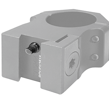

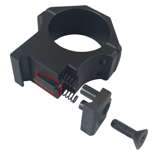

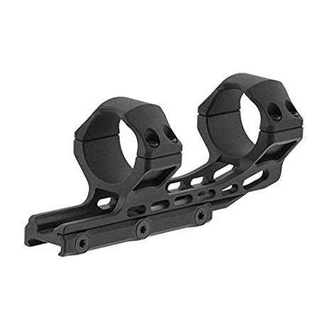

    Fdkay- both your xlr rings have this picatinny cross bar circled in red?
    The UTG doesnt appear to have that.
    They are different after all and the XLR does appear to be a more solid product.
    yes, mine have the bar partway across. Not a full length recoil lug, about 60% of the distance.
    This is very common. People often believe they are getting the same product but for cheaper. In reality when you buy both, there are usually some big differences between the cheap and expensive option. The Burris and Vortex and chinese six hole rings are great example. At first look they all seem the same.
    I think we may actually be mistaken... I always thought utg was knock off bbgun and airsoft stuff and was priced accordingly but when I saw how close they looked on the web assumed they were third party with different markings. But there are now more pics out that seem to show the difference. I wonder if UTG was forced to demonstrate the difference after some misleading advertising claims because the indepth pics didnt use to exist.

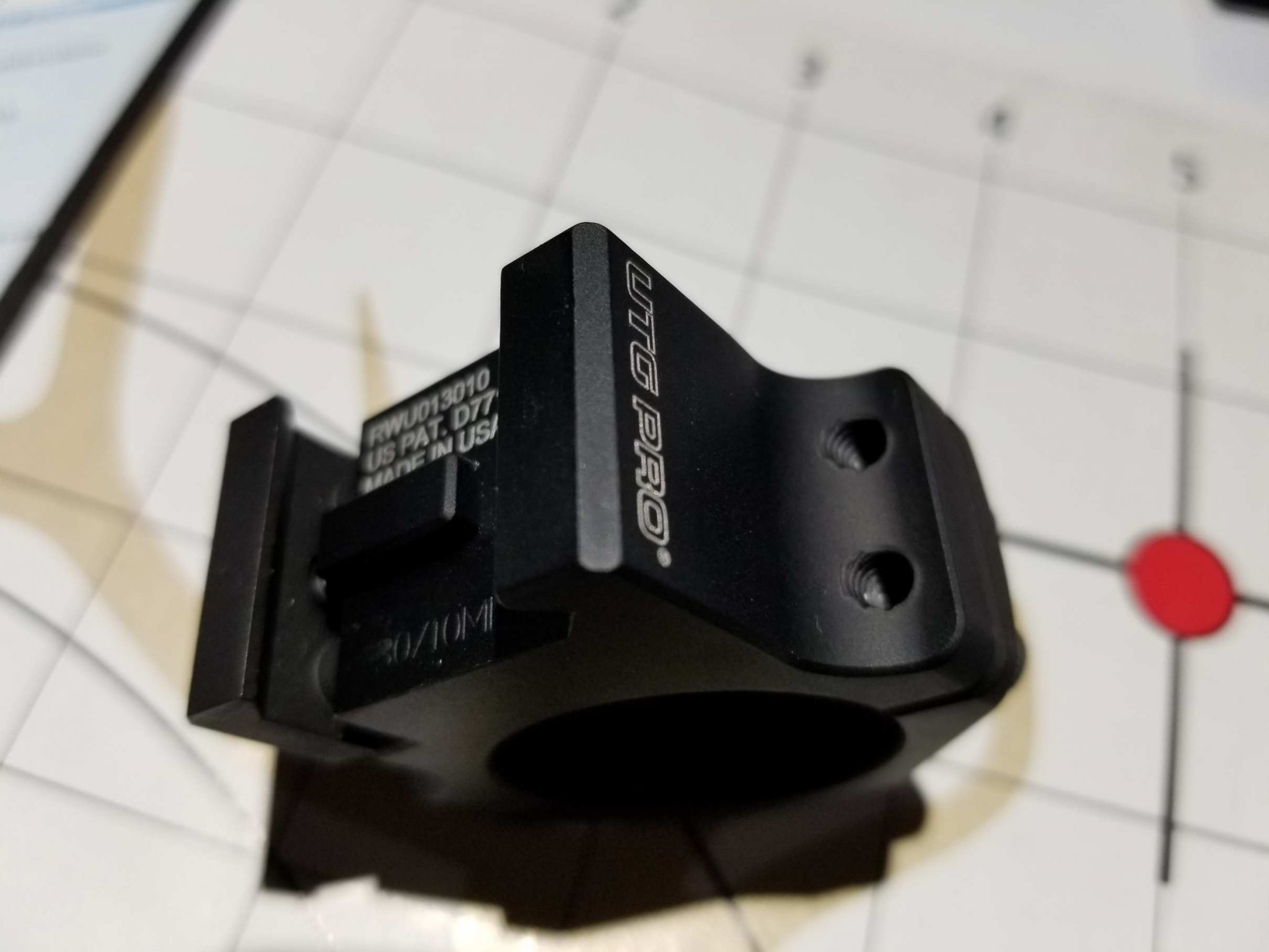

    My UTG Pro have the 60% lug like the XLR.
    They are the exact same design with different branding.
    UTG Pro is made in the USA and all of the UTG Pro parts that this consumer with 20 years experience in the machine shop has purchased have been of very good design, materials, machining, and finish, regardless of what the haters want to believe.
    See, that’s what I thought they were originally, identical. I wonder why the images on their website show that different style now. I figured it was patent infringement or something and they had to change it up. Or maybe it was that and you got the early model. Or maybe I just found a different style all together. Idk at this point but there’s no denying the pics.
    The only rings I've seem with the retractable pin style lug are for air rifles.
    The UTG rings (which are current production I just bought) have a US patent number on them so if there is a patent infringement issue I doubt it is UTG that has the problem. In all likelihood XLR is reselling rebranded UTG rings, just like Vortex Precision rings are made by Seekins and MPA mounts are rebranded ZRODelta mounts.

    On closer examination, although there is a strong resemblance between the contour of the rings (especially the details in the caps) and similarities between the bases in the MPA and ZRODelta mounts, they are not identical. I believe, at a minimum, the design of one was strongly influenced by the design of the other. I remembered a post here a while back about them being the same mount and at that time took a quick look. It was a poor example of rebranding.
    Take a closer look. The UTG rings you have pictured are dovetail mount. Their Pro Picatinny Rail mount rings have the solid square lug.
    Reactions: spife7980
    I have a UTG one piece mount on my 34mm Weaver. It was $45 and it looks and performs exactly how it should. It holds my scope, and it holds zero.
    I just went to Sightron's website to check features of the SV 4.5-24x56, and they list it as having a mechanical zero stop. I've got several Kahles K624i AMRs, five Athlon Cronus 4.5-29x56, and a couple of their new Ares ETRs, so don't really need another 34mm scope....but would still like to have the opportunity to examine one of the SV scopes...am an old fan of the SIII 6-24x50 spf scopes, anxious to see how good the optical quality is on these SVs.
    Zero stop for the SV is in the works.
    Also, a S-Tac FFP 4-20x50, mil/mil (.1 mil clicks), zero stop will be offered in the 2019 line. Come by the Sightron booth at SHOT to see the S-Tac FFP. Retail is going to be $699.
