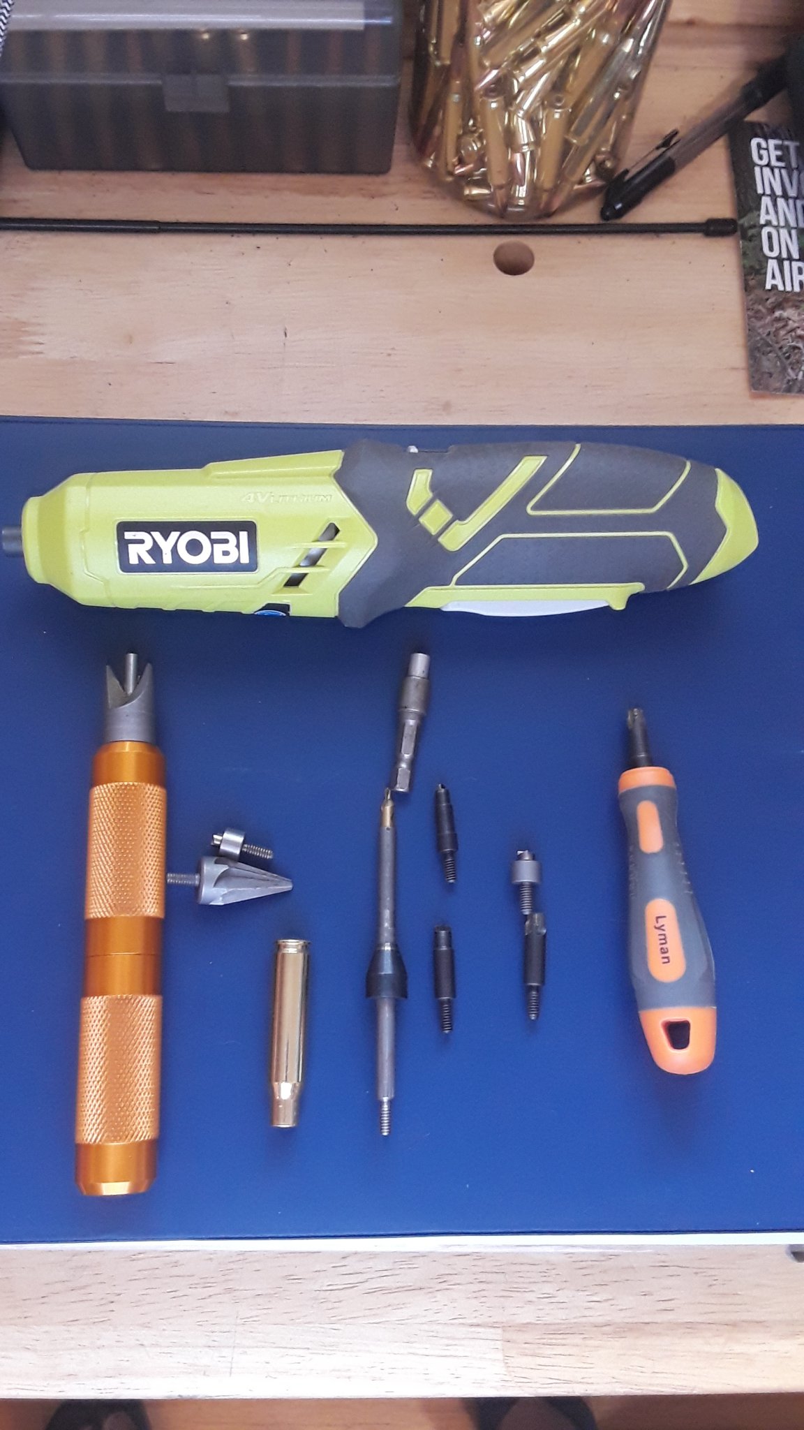

Drill moters are big and clunky.
A tv tray, two containers, a short trash can to catch shavings and a cordless screwdriver is my setup.
Cheap multi purpose tool that doesn't eat bench space.
I can use a trimmer, inside outside champher uniformer reamer and flash hole uniformer.
You can buy or make the 8/32 X hex drive adapter.

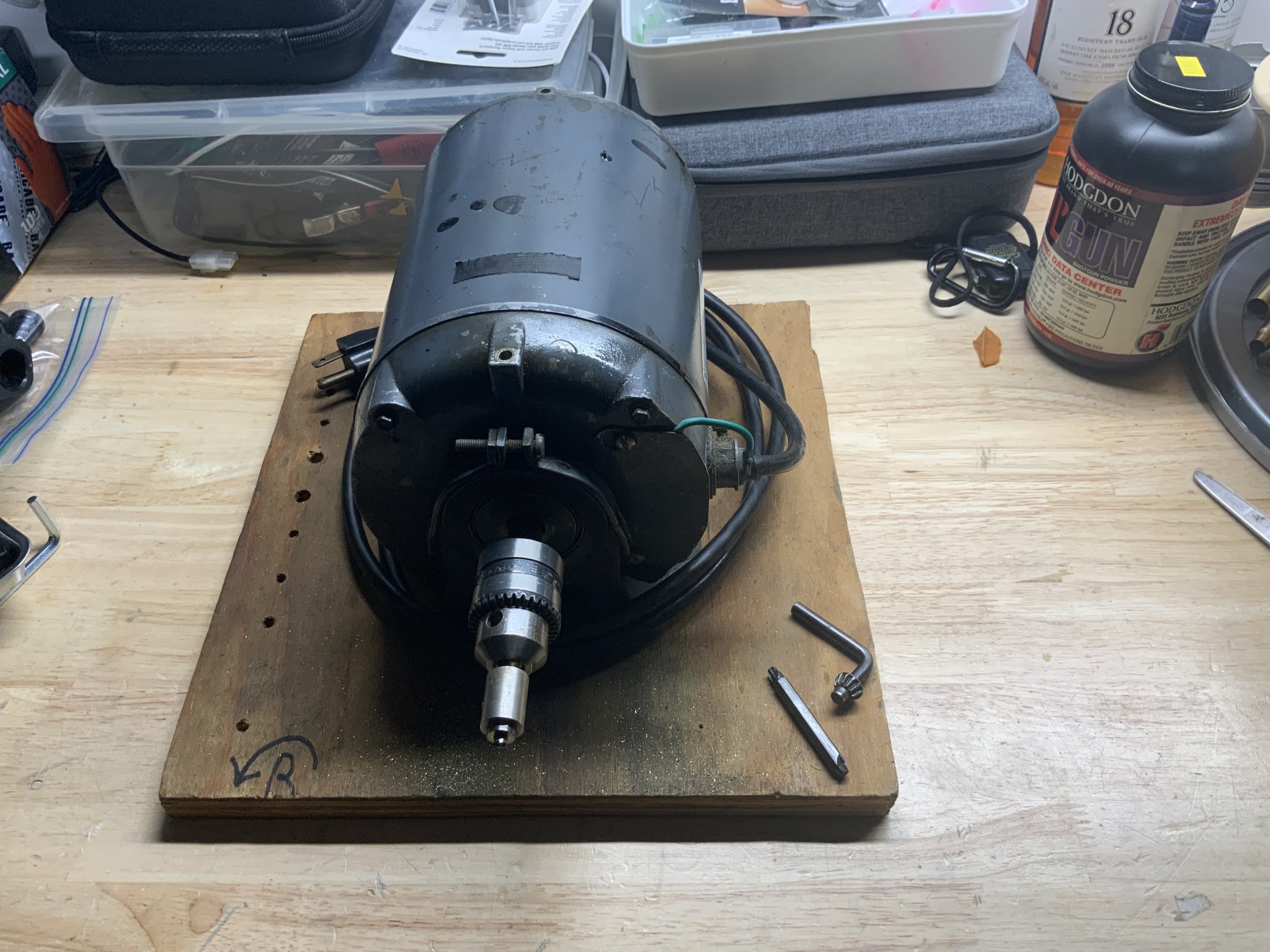

Here’s my low budget solution and it works great. Started with a an old attic fan motor, scrap piece of plywood, and had a machinist friend thread the shaft for a surplus drill chuck. I use the primer pocket crimp remover laying on the wood, and then use Sinclair primer pocket uniformers for large and small pockets. At a 1/2 hp, it has plenty of power. Custom tool head holder on the left side. Notice the simple user instructions on the left! Your hand is the starter capacitor. It rotates either direction but you need to follow the ”instructions” so the cutters go the right direction…. Cheap and effective and been using it for 20+ years.
Here’s my low budget solution and it works great. Started with a an old attic fan motor, scrap piece of plywood, and had a machinist friend thread the shaft for a surplus drill chuck. I use the primer pocket crimp remover laying on the wood, and then use Sinclair primer pocket uniformers for large and small pockets. At a 1/2 hp, it has plenty of power. Custom tool head holder on the left side. Notice the simple user instructions on the left! Your hand is the starter capacitor. It rotates either direction but you need to follow the ”instructions” so the cutters go the right direction…. Cheap and effective and been using it for 20+ years.View attachment 7834210
Dude
Thats my style right there
