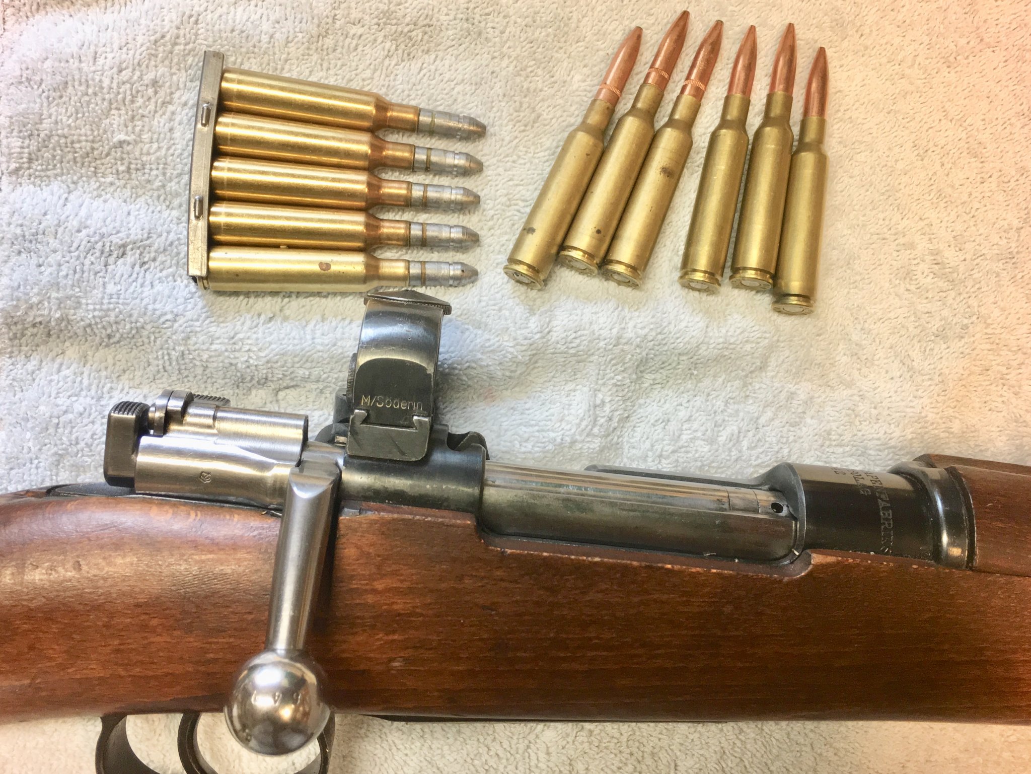

Hey everyone, I’m keen to find out about the mill ammo used by Sweden that went well with the M38. Hoping to load something will loosely along with the sights on the rifle. Thanks in advance.

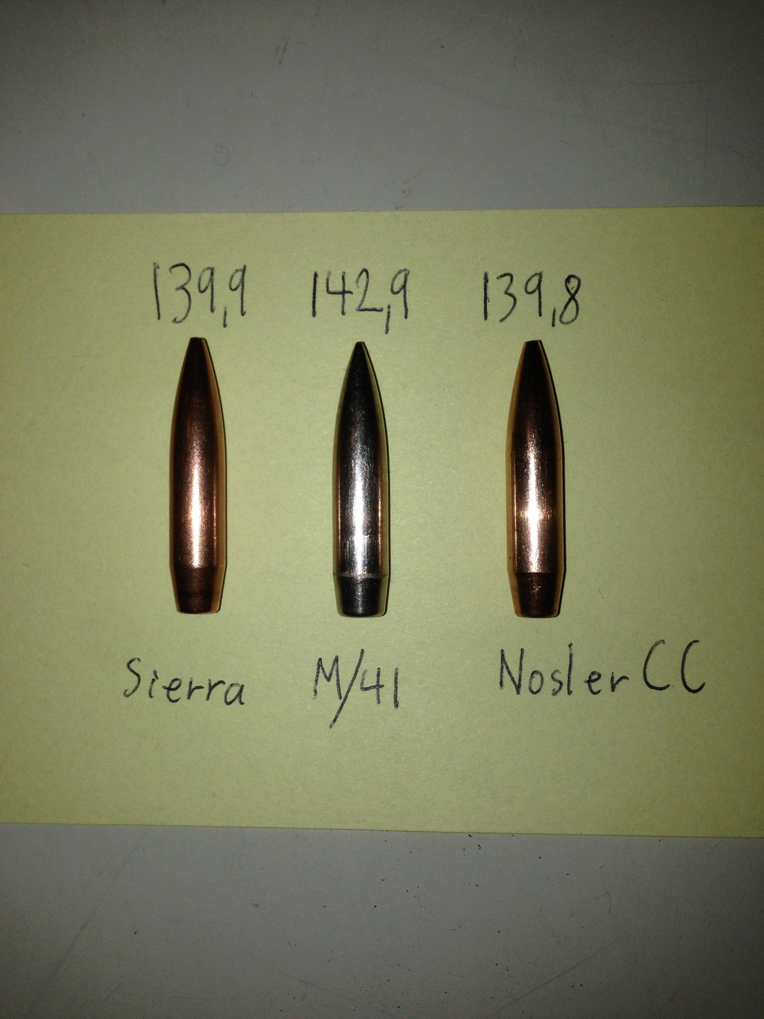

M/41 ammunition actually sported a 141.5gr bullet - took time to disassemble and carefully weight some out of different lots.
Sierra 142SMK is actually VERY close to original bullet.

This is what I found when I went downstairs. I´m just now loading for my M96 and I have genuine bullets from m/41 snipers ammo. I don´t know what factory in Sweden they were made in because the cases were thrown away some 20 years ago when I pulled the bullets. There were variations (small) in shape and weight depending on manufacturer and this bullet is heavier than normal. Might be my scale. Specification was 139,9gn.
Since I´m Swedish I have been shooting extensively with our different types of Mausers, but the most loved one is ofcourse the m/41B.. They are quite accurate and nice.
I remember the good old days when they were "abundant"and REALLY cheap..
Both Sierra MK and Nosler CC works well for me and seems close to the m/41 prick.
Greetings from Sweden!
Fredrik.

I was just ringing the 350m gong today with my Nosler CC load :D
