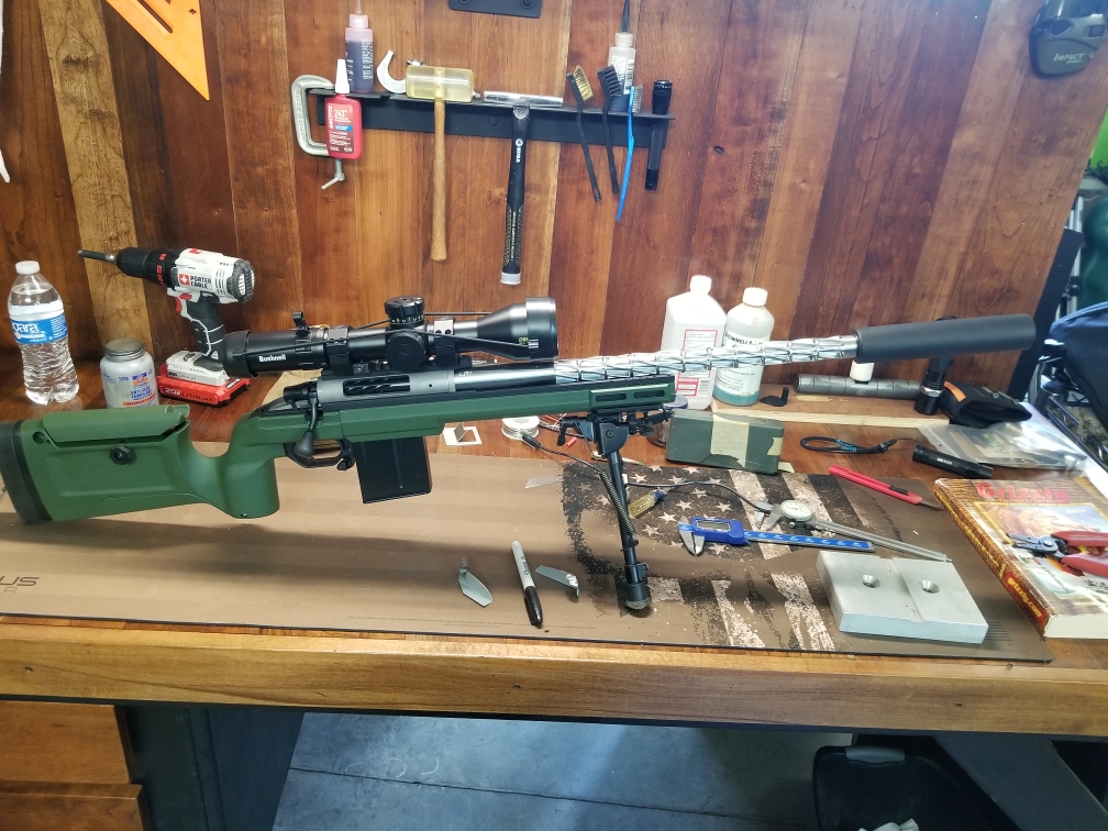

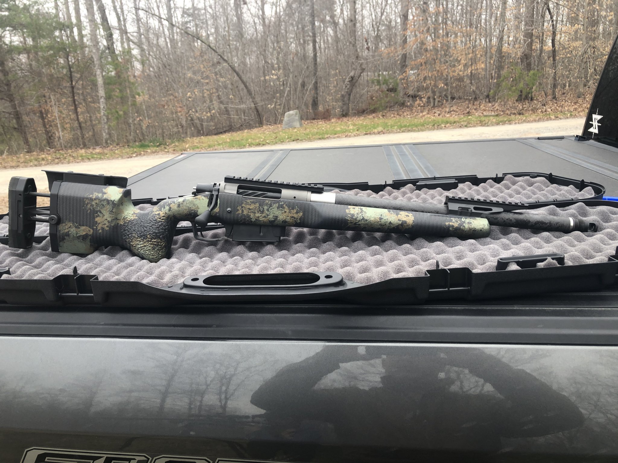

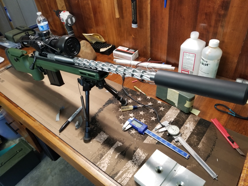

Wanted the same thing myself. Came up with two options. I went one way and my brother went the other.
I did the Mac Bros Ti action with proof Carbon Sendero profile.
Brother went with the Mac Bro SS and a Heavy Palma with LRIs X-pattern fluting
light,strong, and bad ass
My action is less, his barrel weighs less, so theyre pretty close. I’m going
lighter on my stock so mine should end up 8-12 oz less than his.
Two great looking buildings right there. Two quick questions what model manners is that on yours and what’s the barrel length on both. Thanks.
