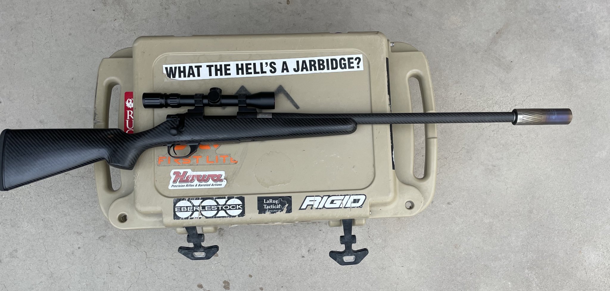

SWFA ultralight is light. That’s the good part. I don’t want to say it’s not a very good scope, but if you’re used to very good scopes you’re not going to think it’s a very good scope. I describe it as serviceable. ( and I am NOT just used to very good scopes). I’d also say it’s 2.5 x 8+, maybe 9 in the field. And only 10 on the range because eye box/alignment gets fussy all the way up. I think putting a cluttered reticle on it would probably be a waste because you’re unlikely(?) to shoot it very long range.
I have one on my Fieldcraft and I often think about taking it off and putting a better scope on it, because while it’s an extremely accurate rifle, it’s also the most difficult to shoot I’ve ever owned. The scope isn’t helping. I also don’t really need an ultralight rifle, and the added weight would probably be unnoticed and an improvement.

I have one on my 6.5 creed. It’s ok nothing special about it. I have only taken it out to 300 yards once. Tactical Timmy head hit the nail on head there’s a giant void where hunting scopes need to be updated
