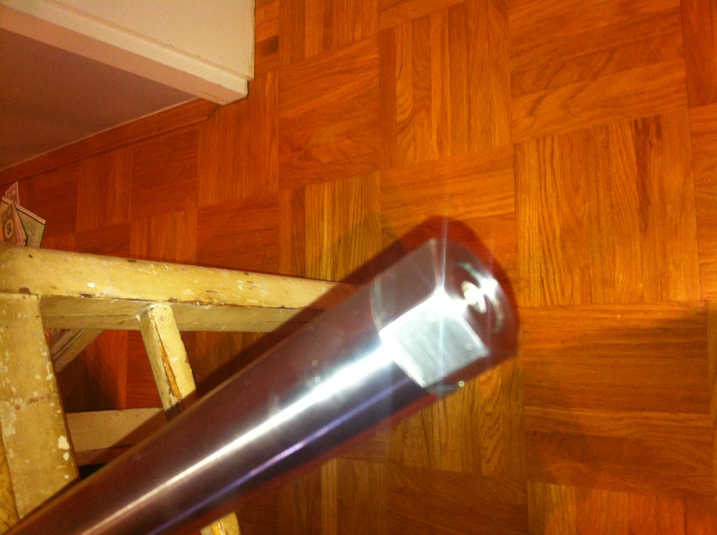

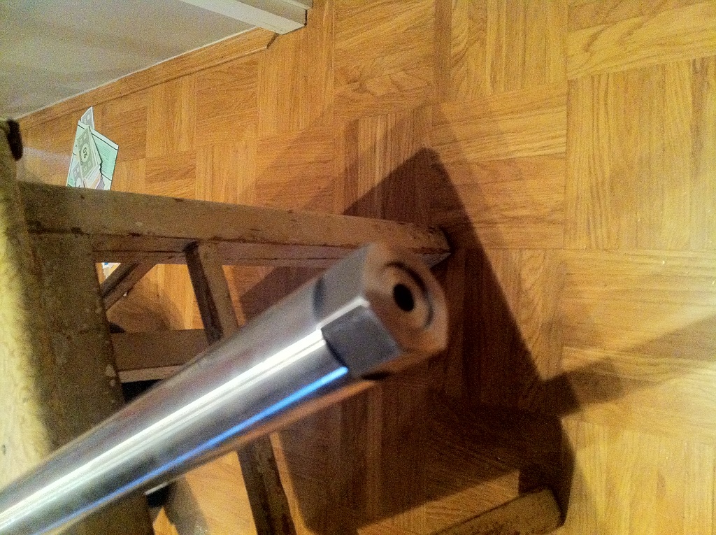

Had barrel removed and slot for 19 wrench cut right behind muzzle threads. Unfortunately my scope is pending repairs at IOR so i'm unable to test and report findings.
Had gunsmith mark the "zero" from the factory and now hand tight marks are 6mm apart with diameter being 28.7 (thread is 1"-16TPI) which means that barrel is roughly 0.1mm further from the bolt edge as it was when torqued to factory spec. Since this also translates to headspace i think i'm good to go as bullet fired will also add some torque to barrel and only decrease this amount.

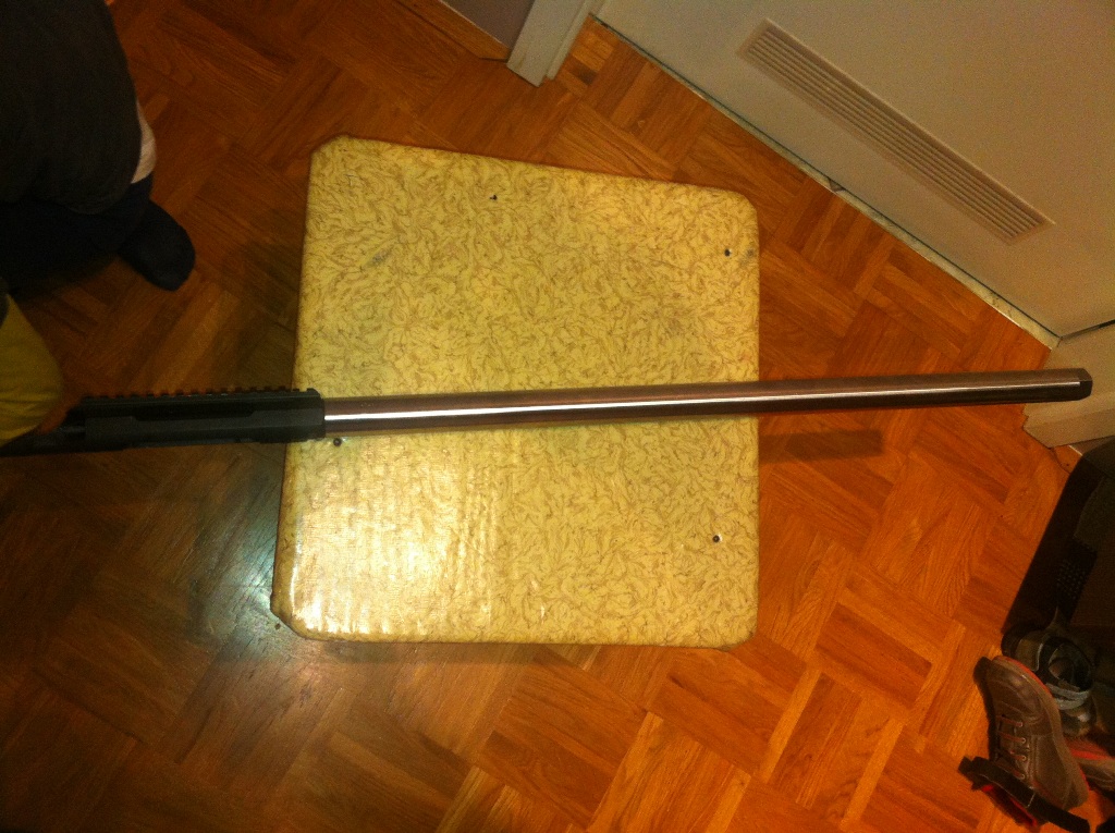

Update: Got the LW stainless barrel 28" straight 30.5mm ready in .260 and time to start the season...

I just shot a match (didn't have time to test anything) with old .308 barrel and old load and using hand tight (estimated torque ~40ftlb) with a normal wrench everything is perfect (dunno about zero as i had no time to zero the scope but first shot was 2cm higher@100m as before and the rest in the same accuracy standard as before) rifle shoots well and thats that :). After the shooting it went off with the same (estimated :) ) amount of torque so at least on Tikka receiver (no recoil lug on threads or in contact with barrel) this setup works great with "hand tight" torque. Also to note i unscrewed barrel between 100/300m relays and 300m dope was exactly the same as before (1.7mil) so to the best of my knowledge taking barrel off and screwing it back on with substantially less torque did absolutely nothing to either POI or accuracy.
