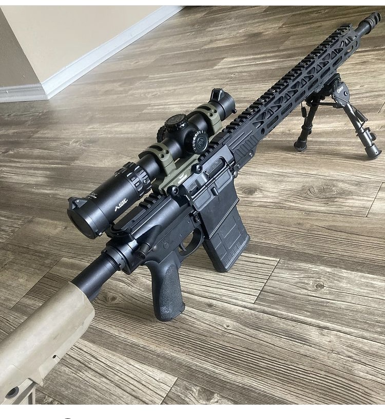

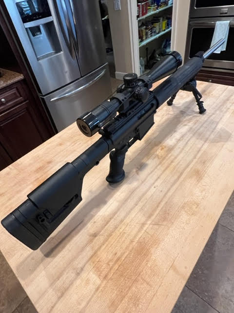

Switched AR10 to Carbine buffer with springco, and now I cant get it to lock back?
gritz55
Jul 7, 2020
72
34
Colorado Springs, CO
So I originally bought a PSA ar10 in 6.5 CM. But it down to 16'" and threw on a seekins buttstock and rifle length buffer tube.
rebarrled to 18" 308 due to ammo issues. And then switched back to a carbine length buffer tube, made more a "battle rifle" instead of a DMR rifle set up it had been in. Tried to lighten her up a bit. Shes still heavy.
Anyways, with the carbine buffer setup, it kicked hard. like, not really fun to shoot. So I got a springco spring designed for AR10 carbine buffer length. MUCH smoother shooting. Made it feel like rifle length again.
However, I had issues adjusting the seeking adj gas block. I cannot get it to lock back on an empty mag no matter how much gas I'm letting in. To the point where I've loosened out the gas to the point where the adjuster screw flies out, and I have dobe this twice now.
I'm assuming that the springco spring is making it softer shooting, but also preventing the bcg from being able to move back far enough to lock back. Its ejecting but then having issues feeding the next round, its not moving far back enough to catch the head of the case.
Any other opinions here? SHould I just switch it back to the regular spring?
Just a little frustrated here.

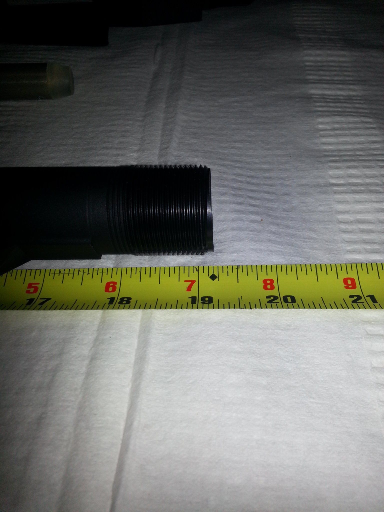

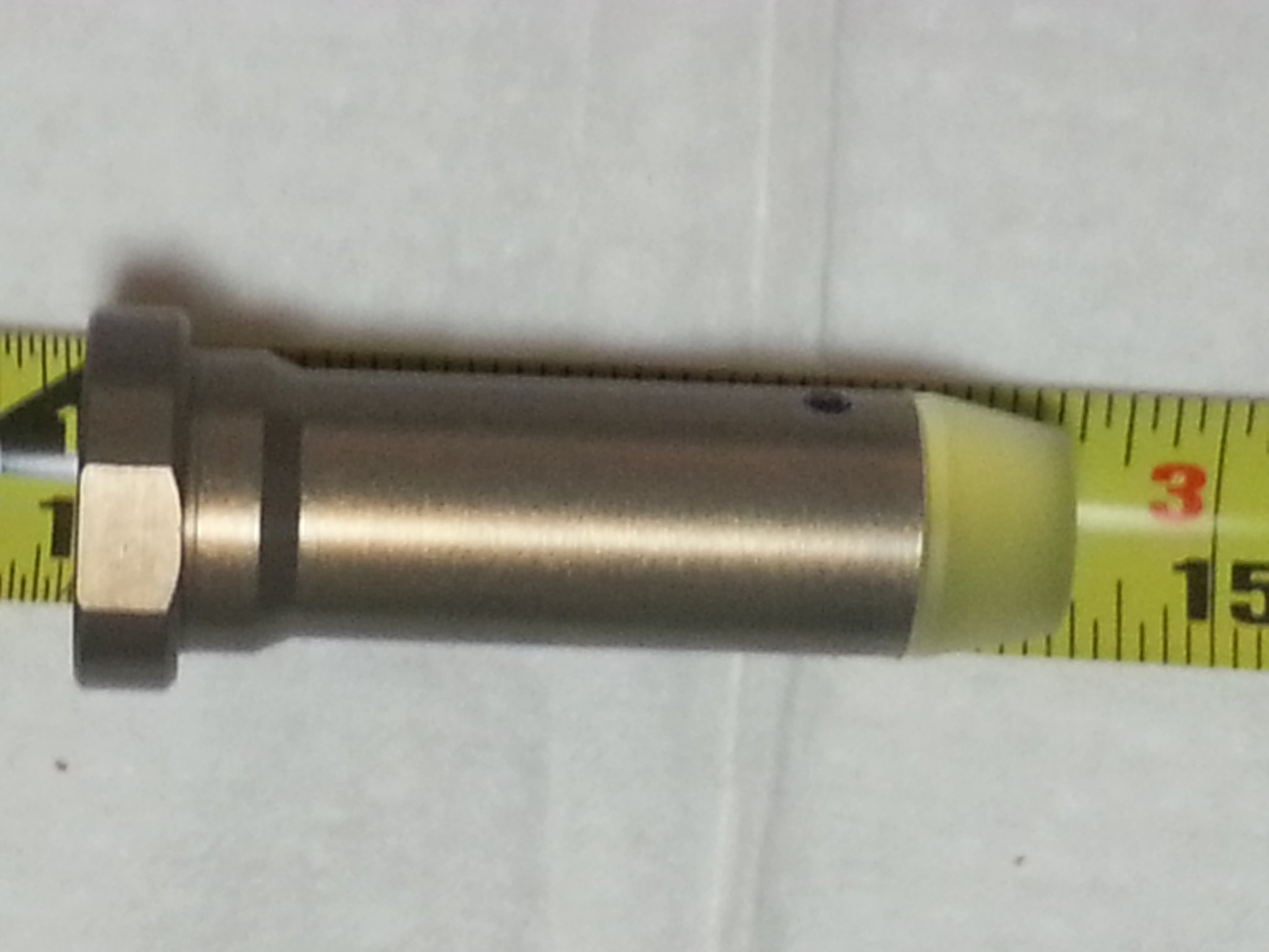

The shorter AR15 buffer tube (with a ~7" internal depth) will work on a 308 but you absolutely HAVE to use a shorter 308 buffer which is 2.5" long. You must also make 100% sure you do not use a standard AR15 carbine spring because it will bind up due to having too many coils. The BCG will not lock back on the last round and it may not even pick up the next round in the mag. You MUST use a dedicated 308 carbine spring.( I use the Sprinco orange) The buffer for a 308 SHOULD weigh about 5.4 ounces to tame the recoil impulse of the 308 round. Many, if not most, 308 carbines come with a buffer that's about 3 ounces. It'll work-most of the time.
The longer (Armalite/Vltor/etc) buffer tube is about 7.75" internal depth and it uses the 3.25" length buffer that's common to the AR
15 carbine. You do need to use a dedicated 308 spring and the 5.4 ounce (H3) buffer weight. To simplify matters and insure all the parts are correct and made to work together Armalite sells this kit with all matching parts:

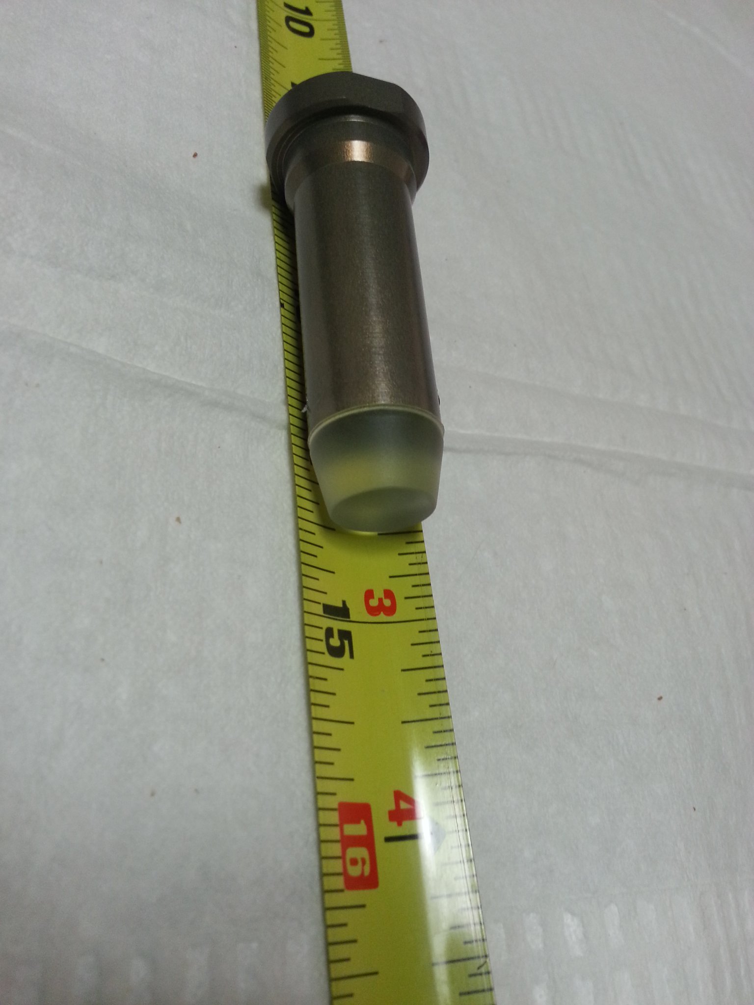

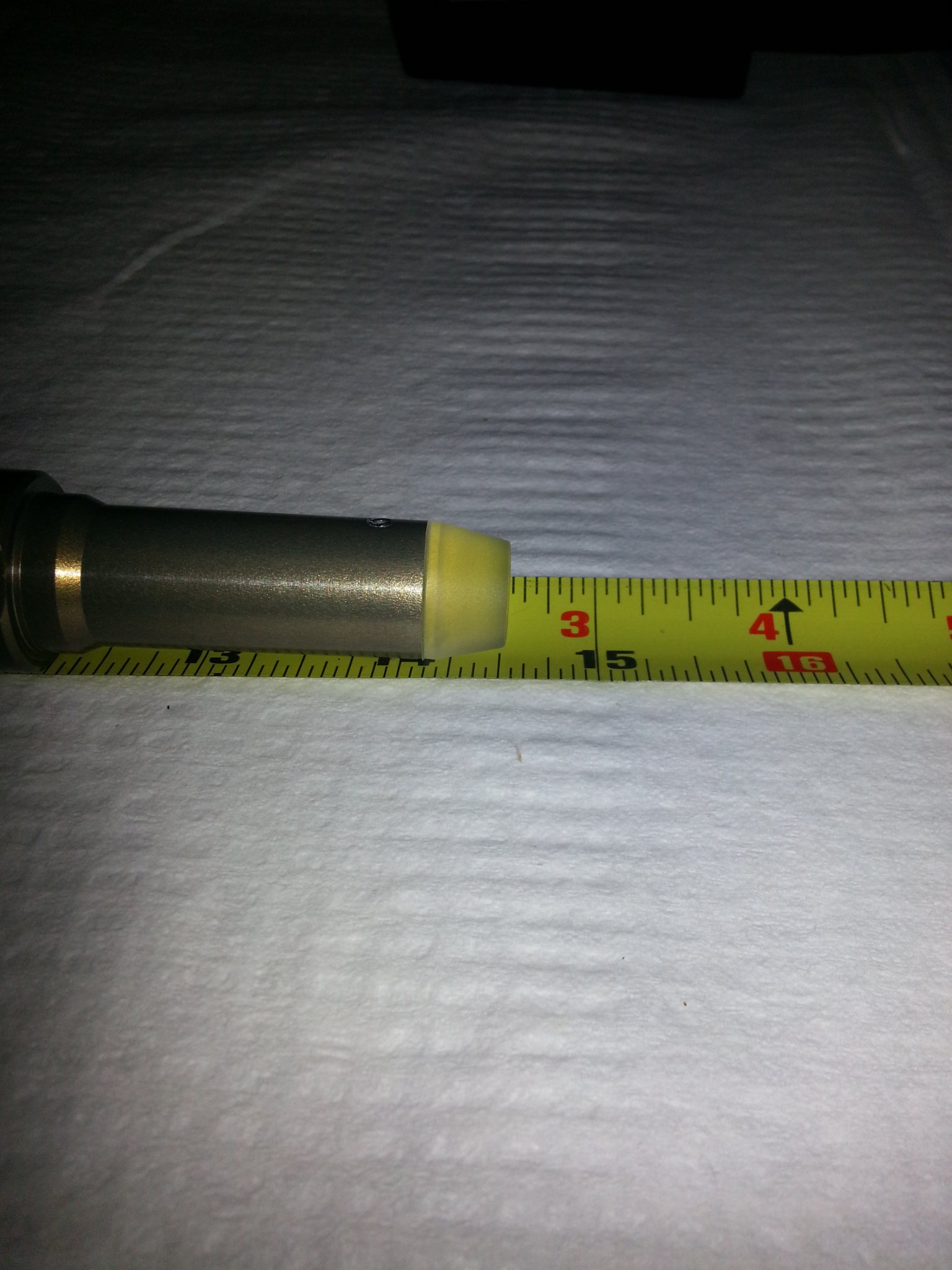

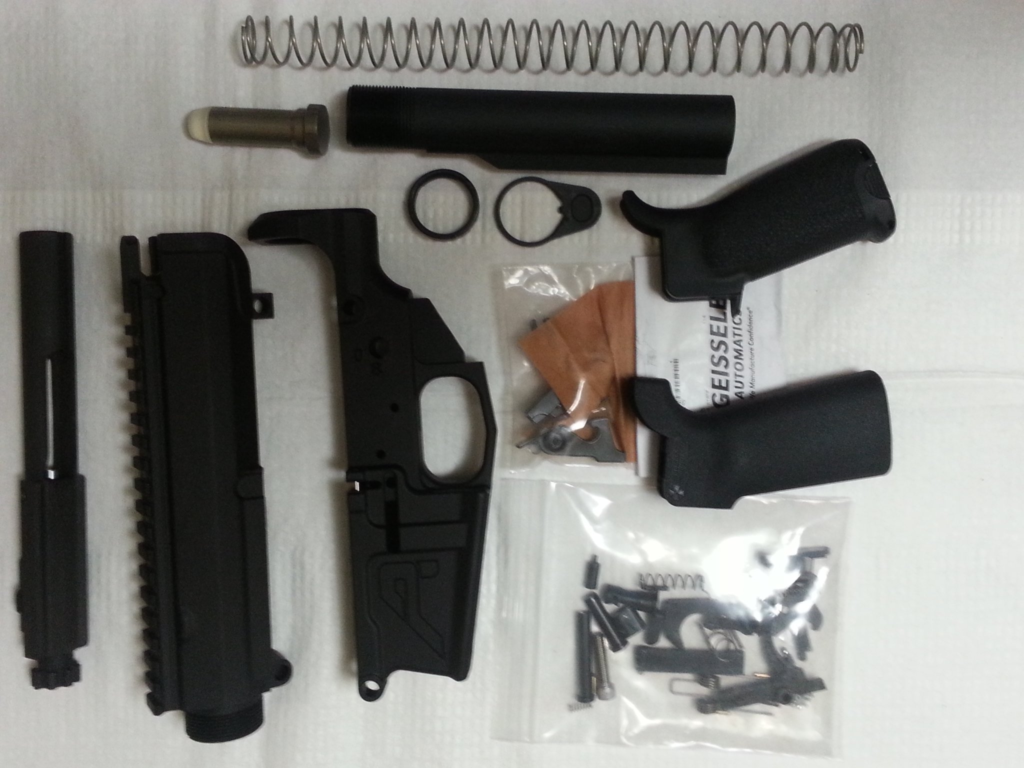

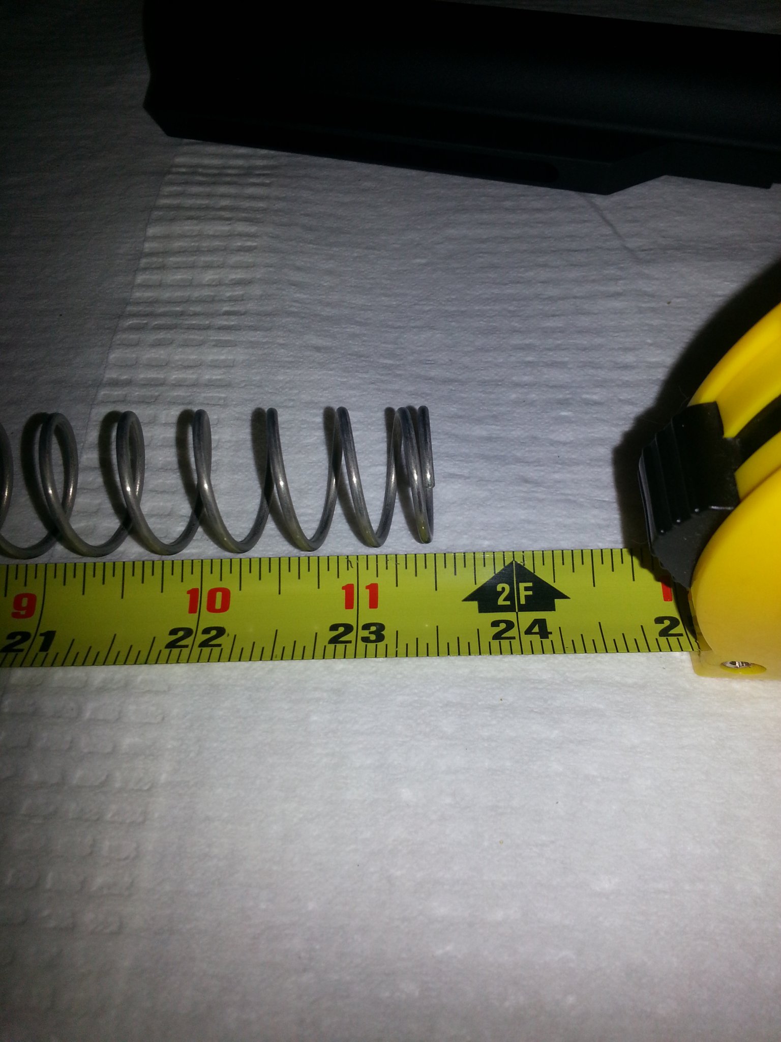

.....here are pix from 2015 when I built my large format AR using these Aero parts. There may be more than one picture of each from different angles to show the detailed measurement. You can see the numbers, make your own interpretations.
...FWIW, with a BA 16" Hanson barrel and SLR Sentry 7 Adjustable Gas Block it has functioned perfectly from it's 1st firing to today using factory M80, FGMM and my handloads w/Hdy 155, 168 & 178 projectiles. Recoil is comparable to my 556's and 6ARC and the same ejection pattern of 3:30-4:00, which I attribute primarily to the SLR AGB and the ability to control the gas at the port. I'm using the Aero "standard weight" phosphated BCG.

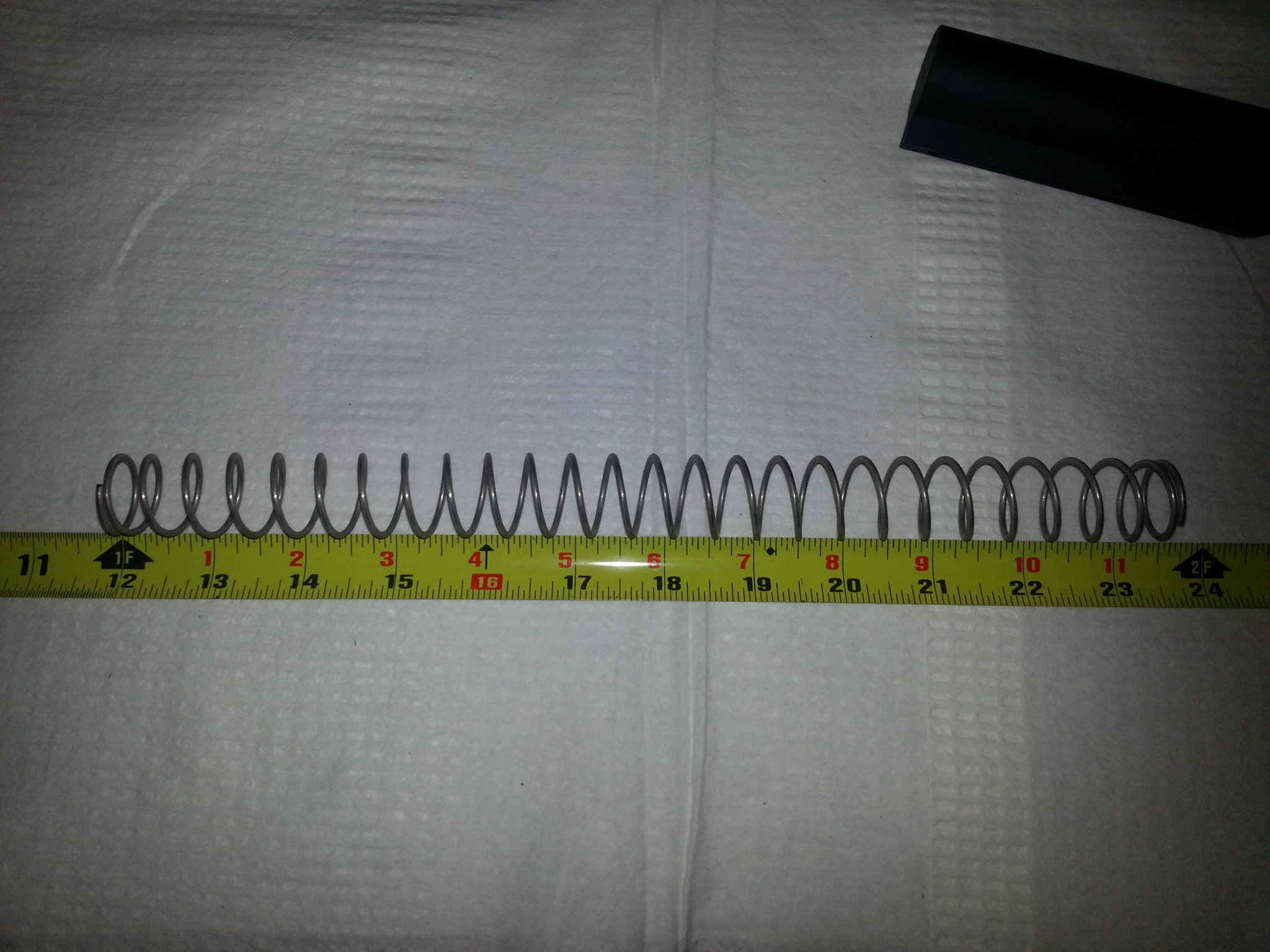

You can use an AR15 length carbine receiver extension for an LR308 however you must also use the corresponding AR308 carbine length 2.5" buffer (DPMS carbine length). AR15 carbine length buffer is 3.25" and the Armalite AR10 carbine buffer length was also 3.25" (off the top of my head). The LR308/AR308 is buffer length is not the same as the Armalite AR10 length.
Proper length allows for proper stroke. If you use an AR15 carbine length buffer (no matter what weight) in an carbine receiver extension with AR308 BCG, you'll have a physically limited stroke length. Your BCG simply won't be able to travel far enough rearward to cycle properly.
If the stroke length is too long (example - using AR308 buffer in AR15 receiver extension and AR15 BCG) your BCG gas key will impact your lower receiver. You can technically make it work using an appropriately sized spacer but why bother? Just buy the correct buffer.
Springs -
AR15 Carbine length springs are roughly around 10 1/16" to 11 1/4" long (will shorten after compression cycles). Around 39 coils.
Armalite AR10 Carbine length springs are right around 13 3/4" long (will shorten after compression cycles). Around 34 coils.
DPMS/LR308/AR308 carbine length springs are around 11 3/8" to 11 1/2" and around 29 coils.
If you mix springs, you'll screw up the stroke length just like if you mixed buffers and BCGs.
Rifle length receiver extensions, rifle buffers and rifle length springs of either AR15, AR308/LR308, or Armalite AR10 will differ as well.
Side note - if you want to get into more advanced tuning, you can play with stroke length by modifying the length of the buffer body to allow for the most stroke length without the gas key impacting the lower receiver.

....Evintos makes some good observations, but I do wish to point out that my Aero .308 specific carbine spring doesn't jibe with the "coil count" nor "length" he states. Not that he is in error, if anything it just points out the lack of a "standard" when it comes to the .308 platform. A possible explanation for the differences in coil count and length is what the "spring weight". i.e. the compression rate of the spring material that Aero springs are made of and the distance between coils, which will determine it's overall resting length and fully compressed length under load. This is one reason why, when asked, I recommend using buffer tube, spring and buffer from the same manufacturer....one presumes the manufacturer has engineered those parts to be compatible and work in concert properly.
...the comment about the gas key impacting the receiver ring is real, I have witnessed it in .308 builds that the users had done a "mix & match" of divergent brands...I've seen from light marks to a receiver that cracked.
reason number 10000 why the std milspec buffer/spring are all you'll ever need. and as for recoil? come on man, a gas 308 is a joke, put the stock spring and buffer back in it, and go. other issue that's very common is those things should be drowned in oil. had issues with a brand new dpms and literally was a matter of breaking down the bcg clean soak in oil till you think its too much then oil some more. they do not like dirt , or an lack of lubrication in the 308s
also heres all the buffer info you'll ever need
below at 18.7 pounds loaded, this is heavy
