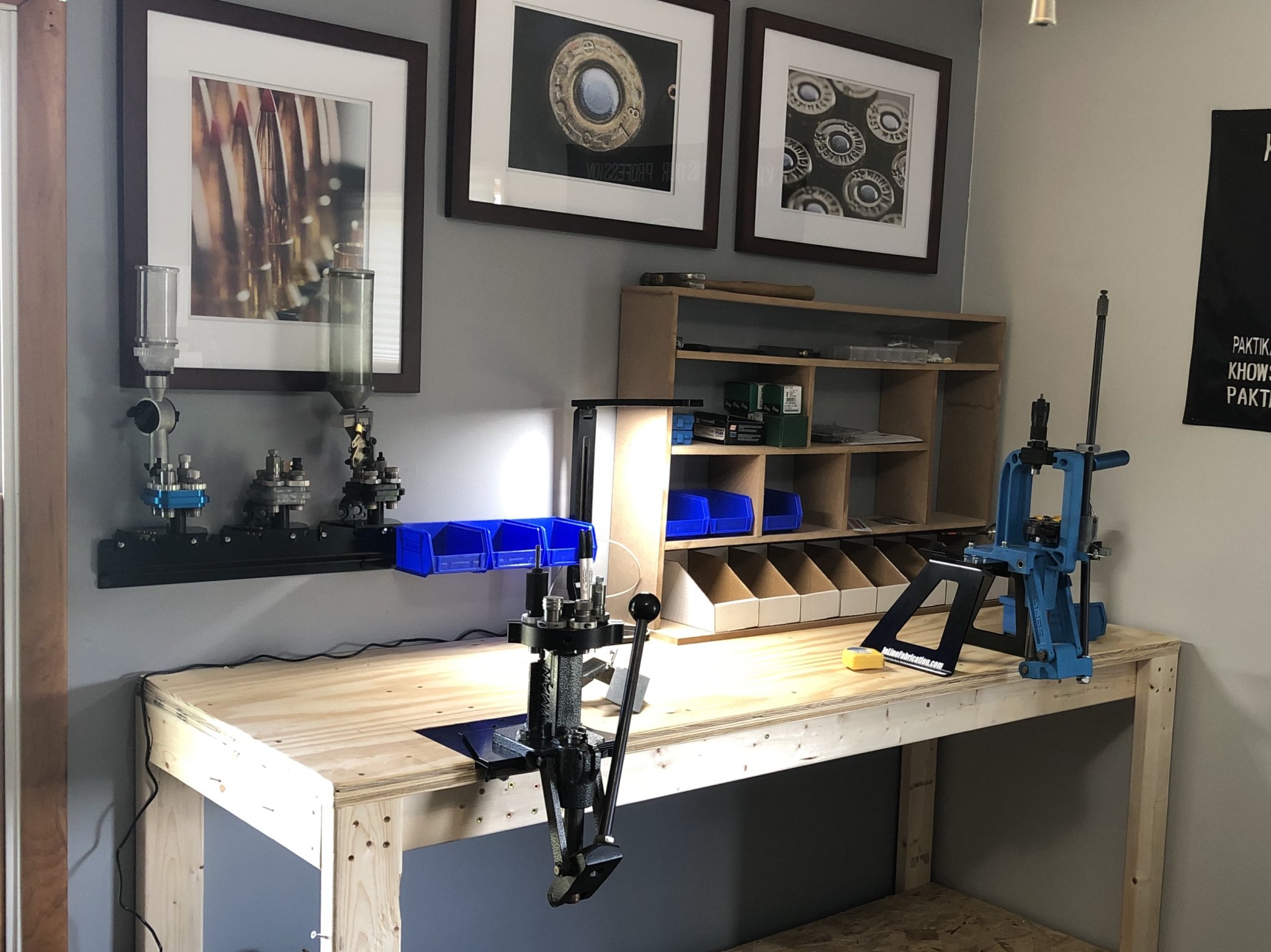

Big fan of the Inline Fab mount. I reload in an upstairs office and out in my shop, so I move presses back and forth. I have one of the standard (~8" tall) mounts in my shop and I have the flush mount in the office (bench sits 44" high).
Provided your bench is solid, the IF mounts are very solid. Everything gets bolted through the bench with a hefty washer so the wood doesn't flex as much. I have T-tracks on my drill press table and I like it for that, but I felt going the IF route was sturdier. I have not had any issues with wishing my reloaders were in a different spot or something, and the raised mounts are easy to take off if I do want it out of the way.
The Dillon 550 stays out in the shop mostly now, but it'll come in handy more when I pick up a 750 as well.

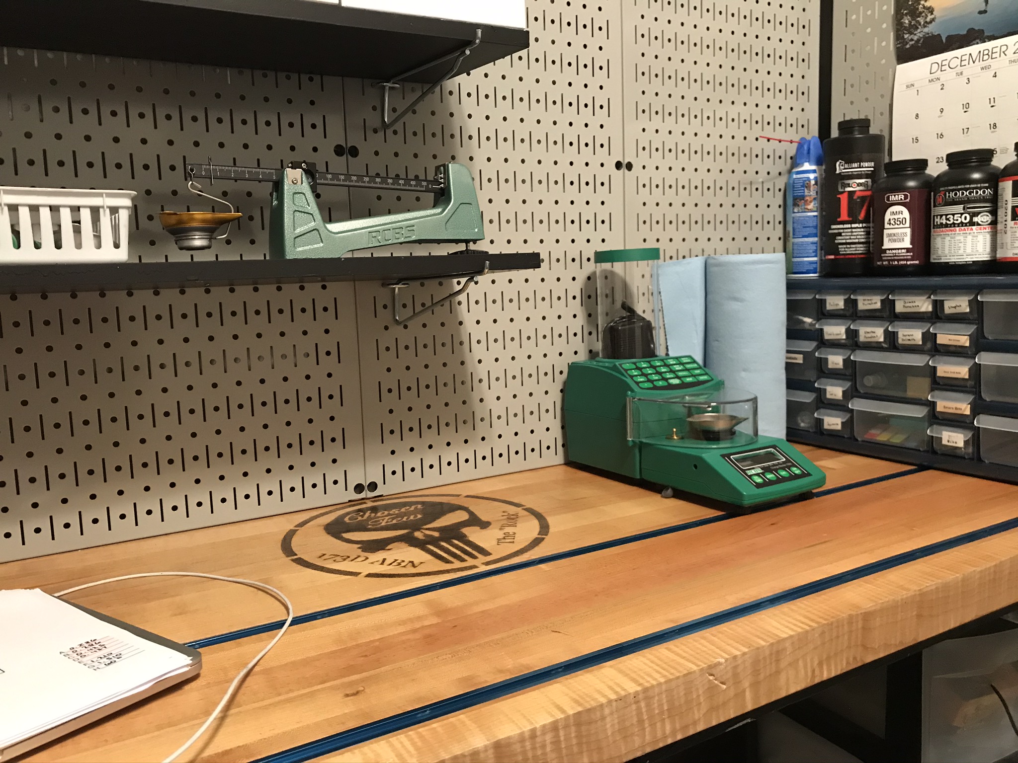

I went the t-track route and I dig it. I use a IF mount for my press and everything else (vice, trimmer, etc) is secured via the ttrack and 1/4-20 track bolts. Locks down plenty tight. I made plates from plywood that span the two tracks which gives even more holding power, though I’ve found it to be unnecessary generally. The IF plate might be good for presses, but it seems like a lot of moving around to me.View attachment 7769164
Man that’s a great looking bench and I like the wall control peg board. I got some of the wall control for my birthday recently. Now trying to figure out my bench build. Did you build that bench yourself? Would love to see the whole bench and get details on how you built it.
Thanks, yea I did most of it. I bought the top off Grizzly, had a stencil made and my brother used smokeless powder to burn the stencil into the hardwood top. Then clearcoated over it. It turned out really well. The rest is a 2x4 frame. I’m actually adding WC shelves and making some changes. If you’re interested, I’ll send you some pics when it’s done.

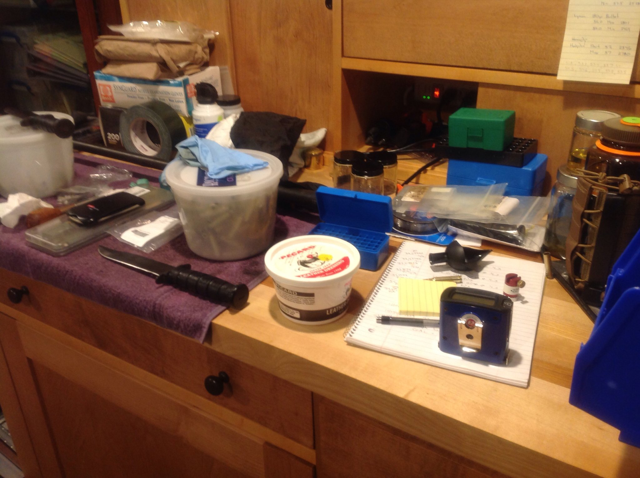

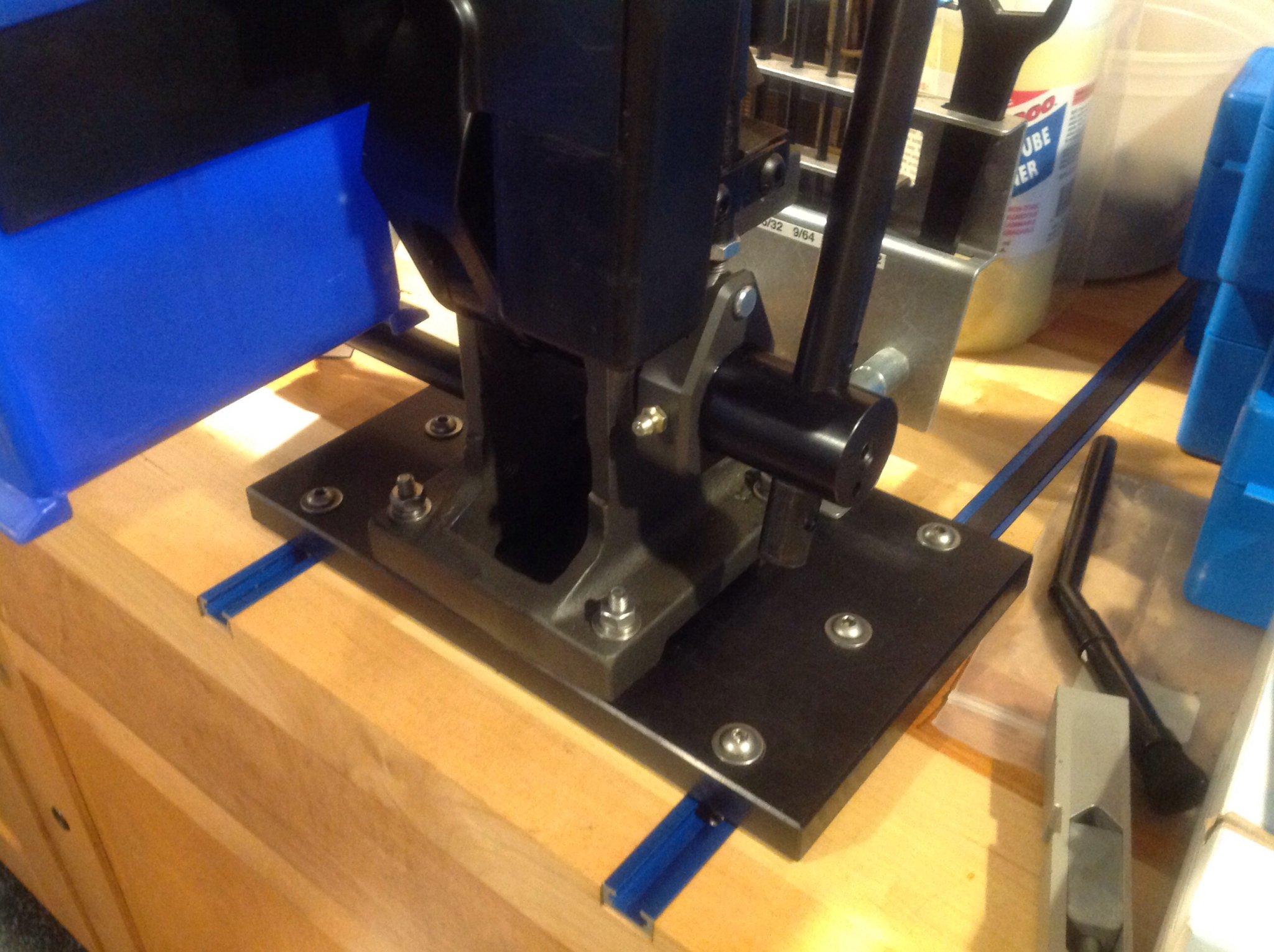

I went with T-Track but only use it north and south not east and west.....
I can push my press back and mount a vice in front if I need it.
I found some plastic filler to cover the T-Track slots...
Can't remember where I got them. They fit under my my press mount plate and under my back cabinet pretty tight so I can't pull them to get a picture of the profile. They keep everything clean in the track.
I went north/south for install cause I didn't want the rest of my bench cluttered up....
Right.....
