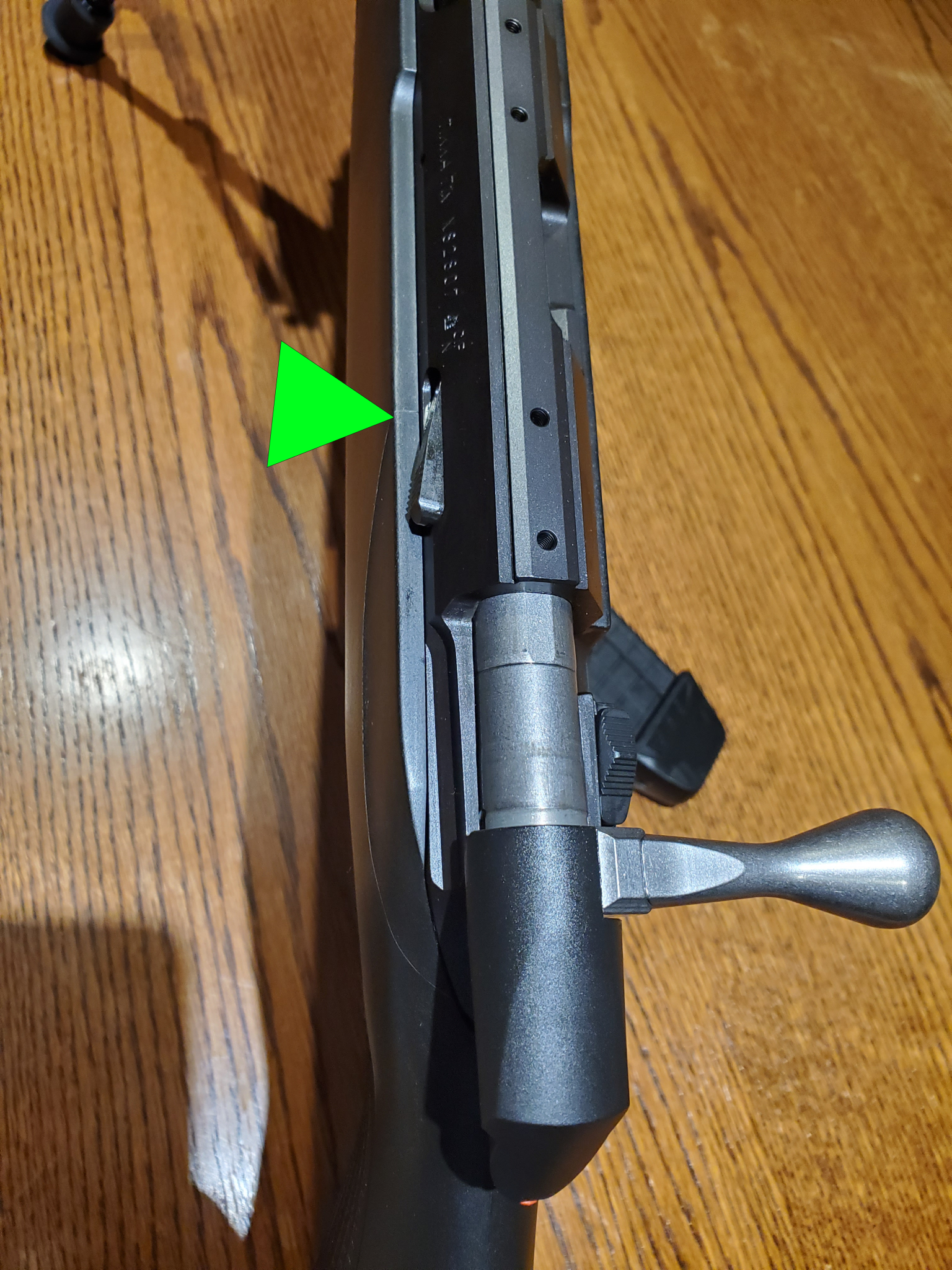

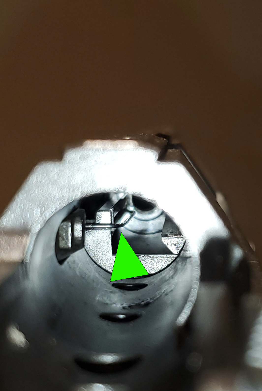

Hey Guys,
First off I am new to the site, and fairly new to guns in general, so please forgive my lack of terminology. I recently purchased a T1x after already owning a t3. The action on the t3 is very smooth, the bolt will slide back with the slightest tilt of the gun. Purchasing the T1x I am a little disappointed with how (not) smooth the bolt is. After further inspection I am noticing there is a tiny little bar that applies pressure to the side of the bolt as it slides forward and back. Also, the bolt release button collapses as the bolt is pulled backward, seemingly causing more friction as the bolt is pulled back forward. I am wondering what the purpose of these changes are? And is there anything I can do to mitigate these effects? Photos attached for what is hopefully a better explanation of what I am trying to ask. Thanks!

The "bar" appears to be the ejector, though I've never messed with a Tikka, so I don't know for sure.
Keep in mind, the T1X action is much bigger than a typical rimfire (since it's designed to use centerfire stocks), you have oversized components for the tiny .22 rimfire.
The bolt release is spring loaded, it must keep pressure laterally in order to function correctly. If it didn't apply force to the side of the bolt, then the bolt would just pull out.
Your centerfire bolt is much larger and heavier, mass has a way of overcoming resistance when force is applied.

It will become smoother as you shoot it.
The bar indeed is the ejector which is not really going anywhere.
The bolt release can be finesanded for smoother contact but it needs the angle and spring to keep the bolt from dropping out.

thanks. with the bolt release i just found it odd as on the t3 it doesn't seem to collapse in the same way. i appreciate the help!

You definitely have a problem with your bolt release from looking at the picture.
Pull your action and see if your pin that holds it in place is seated correctly....

I don't have my T1X anymore, but your bolt release does look a little odd. I don't recall mine being that deep. The ejector wire is the one causing the friction on the bolt and why the bolt doesn't just slide in and out like the T3X. I felt the exact same way when I got my T1X thinking it would be super smooth like the T3X. It isn't.
Now in a competition or actually in practice, I rarely notice it at all. The more concern is that the ejector wire puts pressure on the bullet which causes feeding of rounds to not be the best. This is really prominent if you get a really tight match chamber. You won't notice it much on a factory barrel.
My friend and I are still looking at engineering ways to re-engineer that ejector wire to be smoother on feeding, and have good ejection capability.

fresh out of the box that way :/ i found it odd too. though the same level of depth seems to be apparent with this t1x as he cycles.
