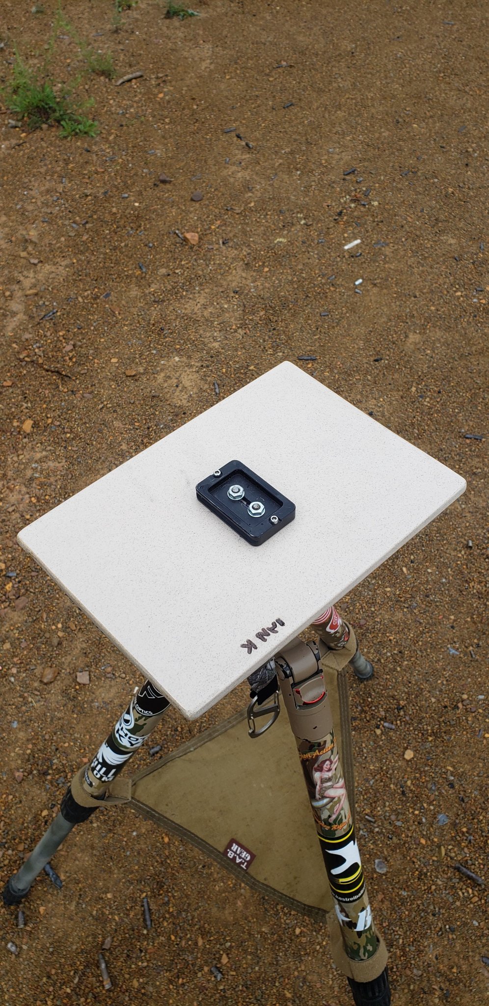

I made one from an $8 poly cutting board from Target and some anti-skid tape I’d bought years back. I dunno, I might have $15 in it all together.
This one actually, it’s from Made By Design, it’s 7” X 12”
I cut the handle end off the cutting board and sanded it down before locating the center of the “table”. I drilled and countersunk two holes for the 10-32 flat head screws that secured a spare ARCA plate that I had, held on with a #10 washer and nut. Then I roughed up the surface of the top and laid down strips of anti-skid tape, overlapping them about 1/8” and cutting them flush with the edge. The width of the cutting board is just a little wider than my OG Game Changer so I can run the straps around it if I want so it doesn’t go anywhere if I move the tripod around.

2nd the cutting board. Same concept for me.

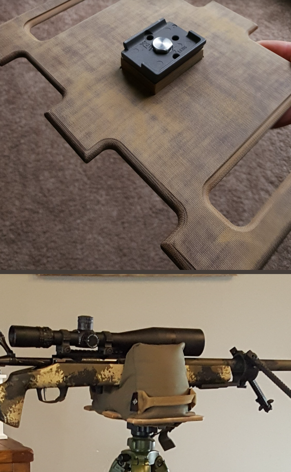

I made a few arca-coins. Double adaptor type deals. So any arca clamp item you have can adapt to a tripod, like bags or gamer plates.

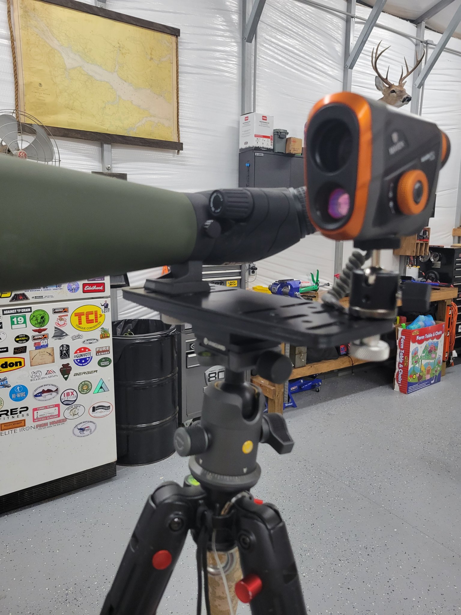

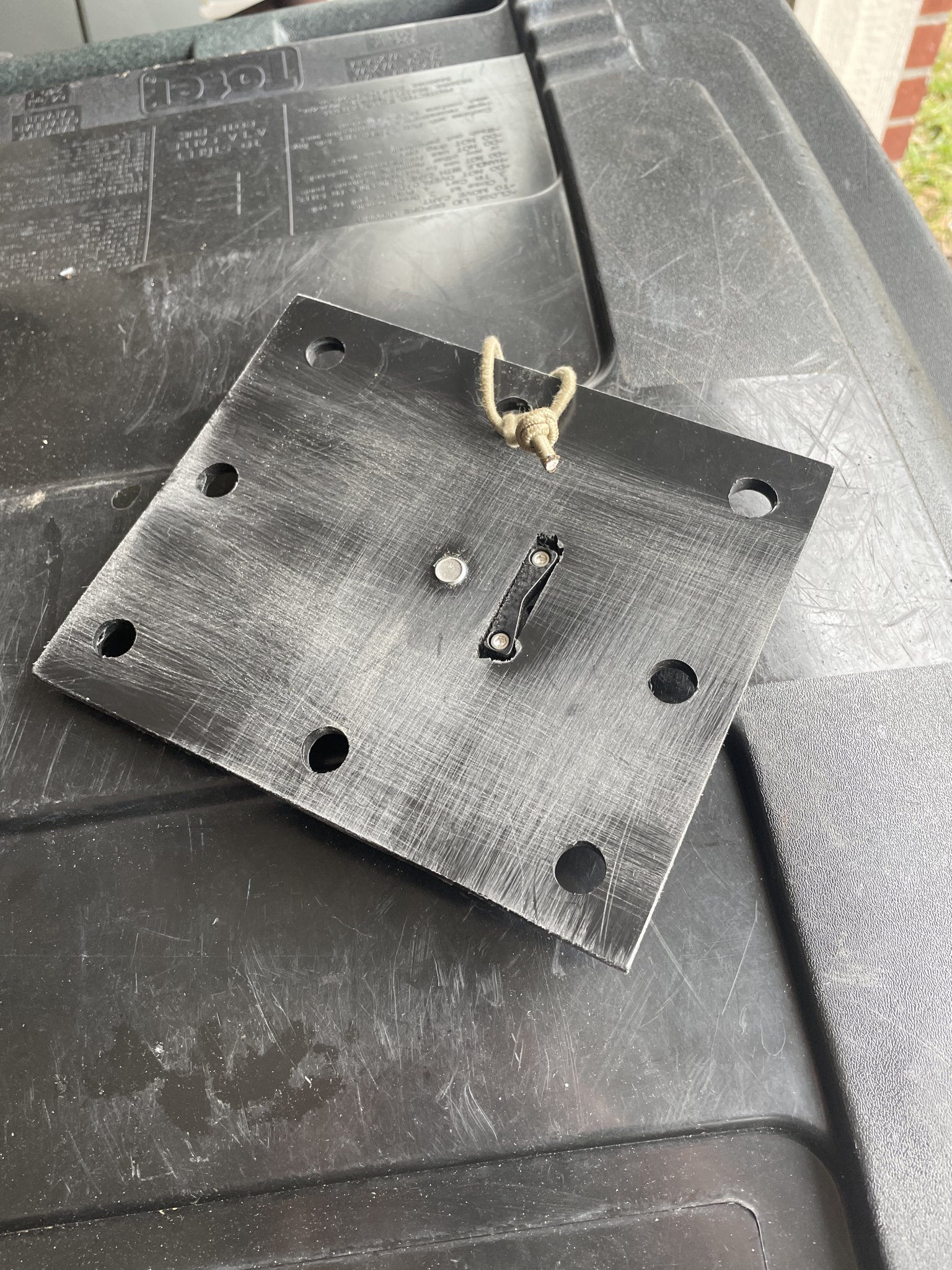

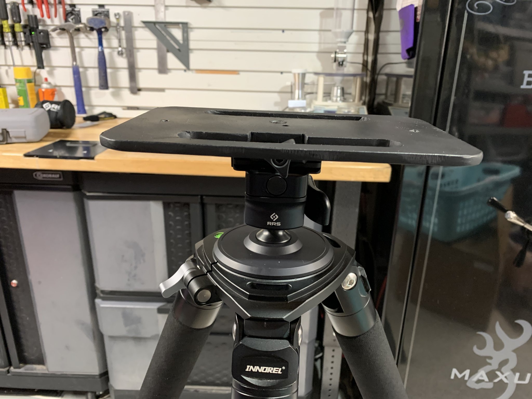

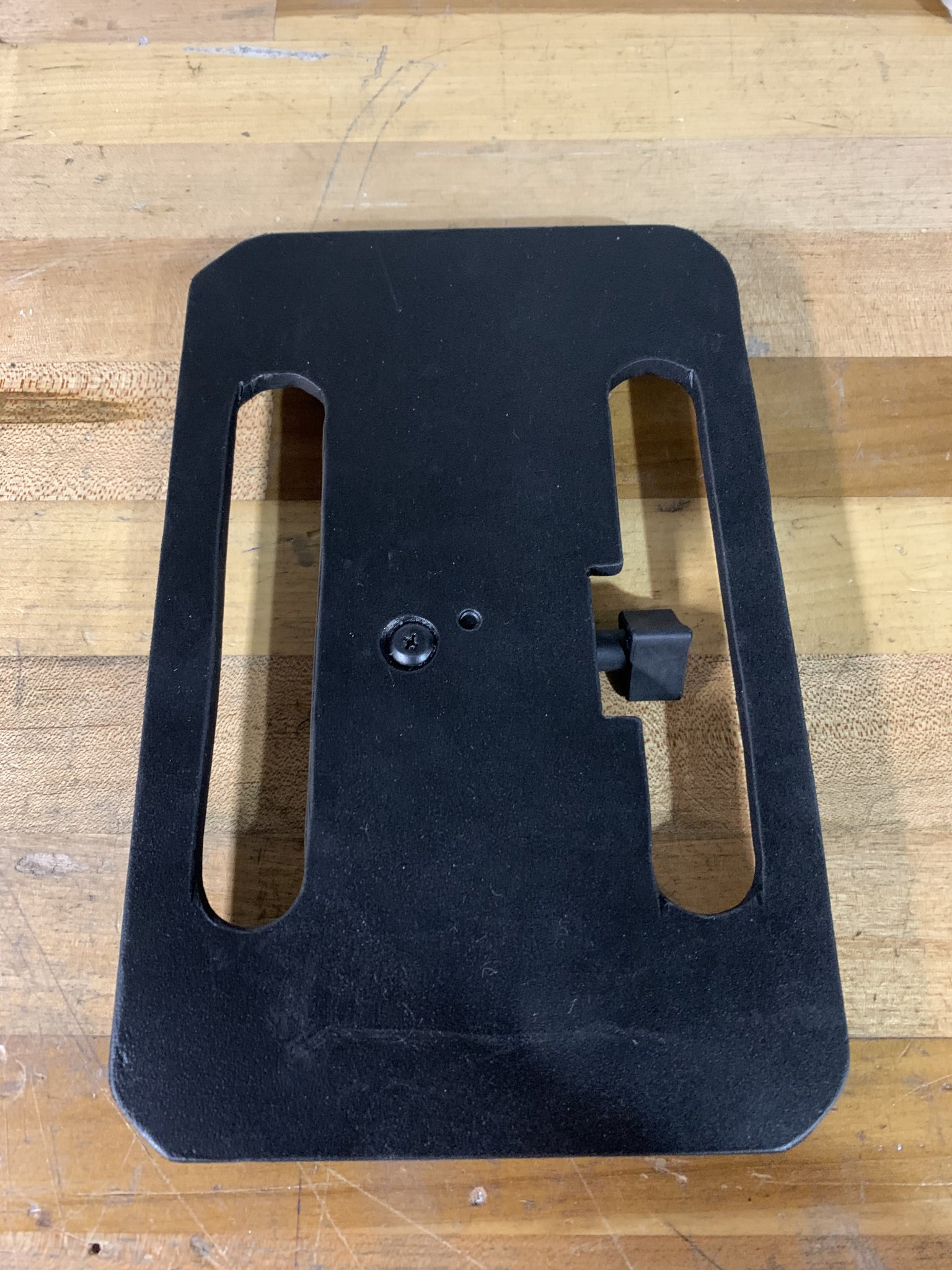

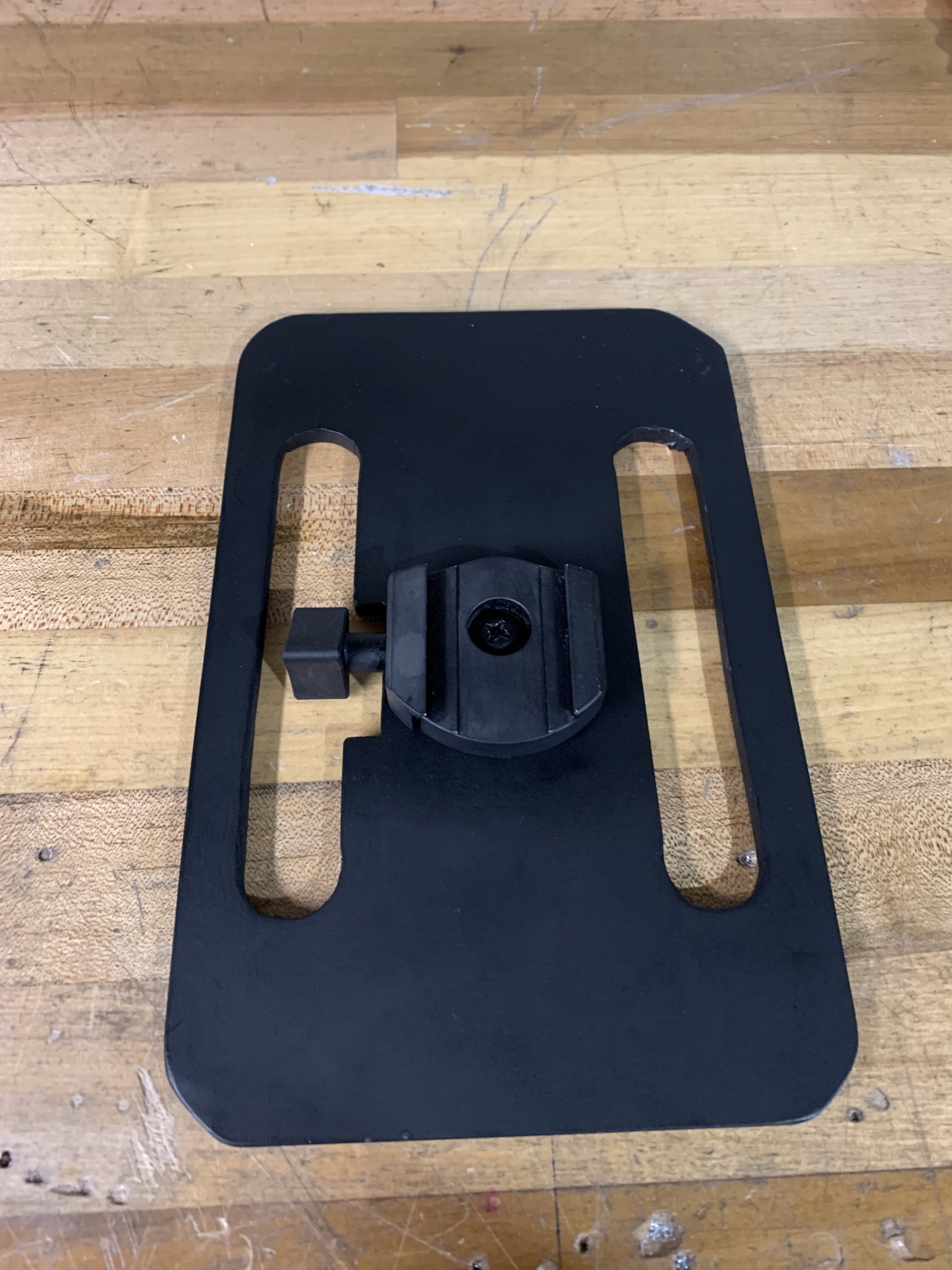

I made this one out of aluminum. I might make a smaller one also pretty happy how it turned out. I used spray on plastic dip for the bottom side so when I throw a bag on top of it's grippy and won't slide. Ordered the grey ops double arca adapter so I can clamp it on my tripod and also use it on my arca rail on my rifle. Will probably add another couple threaded holes in case I want to put spitting scope/range finder on it. Looks like cole Tac has flat bag that would fit it perfectly for $35. So far all I'm in it for is $50. I had an old arca clamp from ckyepod I used and had the aluminum laying around.
Adapter came in! The plate is solid cannot wait to try it out. Should fit a schmedium perfectly a little big for my pint size.

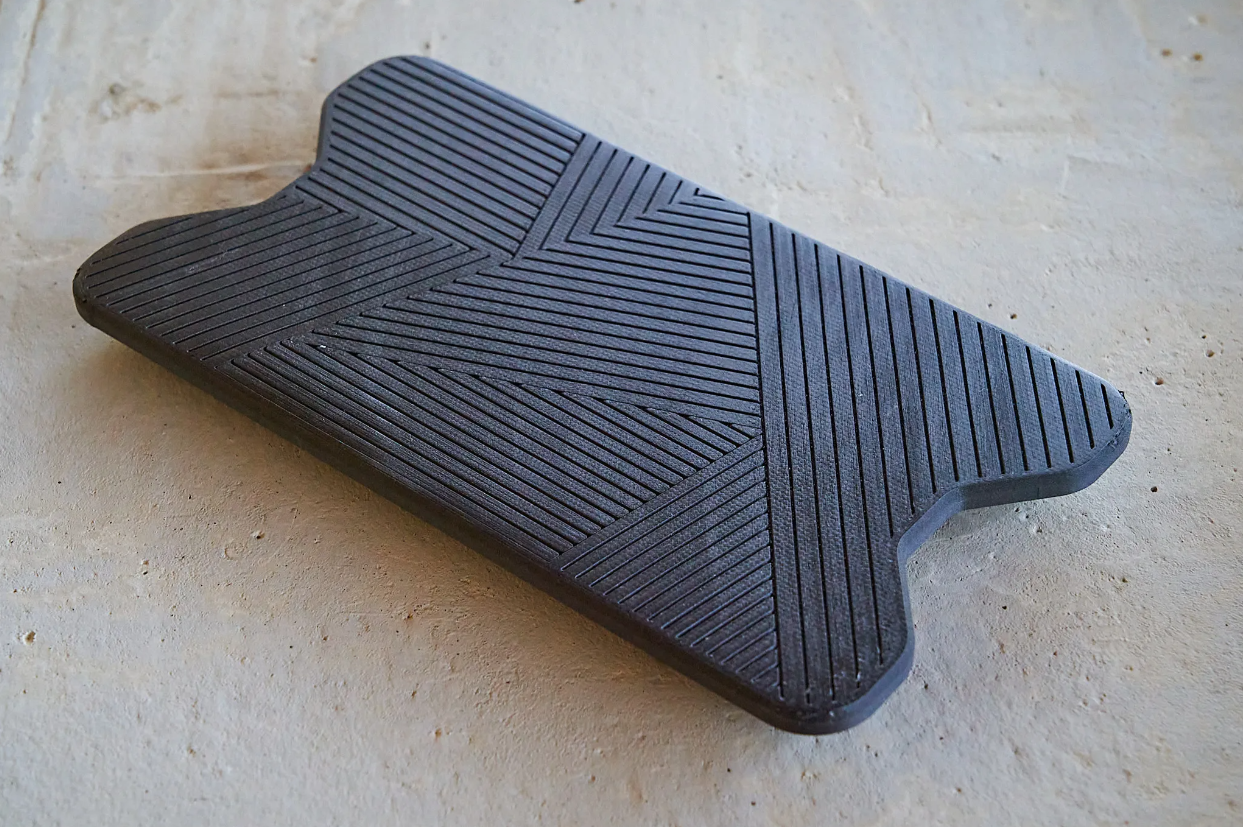

Threw these together last night.
Haven't tested them out yet, since I don't have a direct access to a 3D printer at home.
