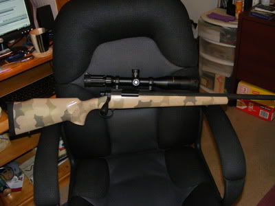

Remington 700 XCR Tactical SA Compact Fluted 20" barrel
Cal 308 win
McMillian HTG Stock
Seekins 20 MOA base
Burris 30MM Signature Zee Rings
HS Precision DBM
SWFA 3-9x42mm FFP MIL/MIL
Badger Bolt Knob
Weight 9.9 lbs.

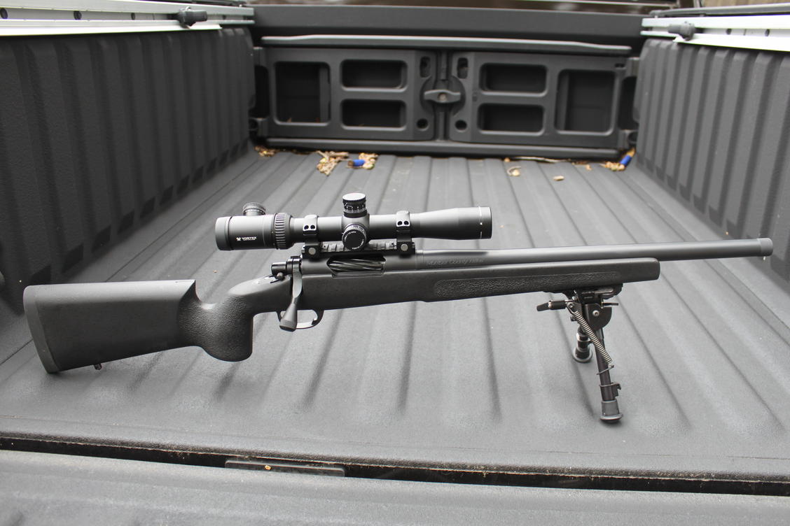

Oh.. I almost forgot; Or, get a McMillan Lazzaroni Thumbhole. Looks super comfy!
Stiller Tac 30 .308
Brux 18" 1:12 Remington Varmint Contour
Shilen Trigger
McMillan A3 with Edge Technology
Williams bottom metal
Nightforce Lightweight rings
Vortex PST 2.5-10x32
The whole rig weighs 9lbs 10oz minus the bipod
