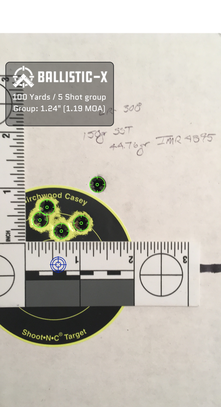

    I swapped out my old heavy ass 24" DPMS barrel (5.7lbs) for the 18" Criterion Nitride barrel (2.6lbs) earlier this year. I've found accuracy to be about 1 MOA with 150gr Hornady SST's. I didn't really try to develop any other loads for it sorry. I have two other Criterion barrels (Remage prefits in 223 Wylde and 308Win) and ever one has had excellent speed and accuracy. They are my go to off the shelf prefits these days.
