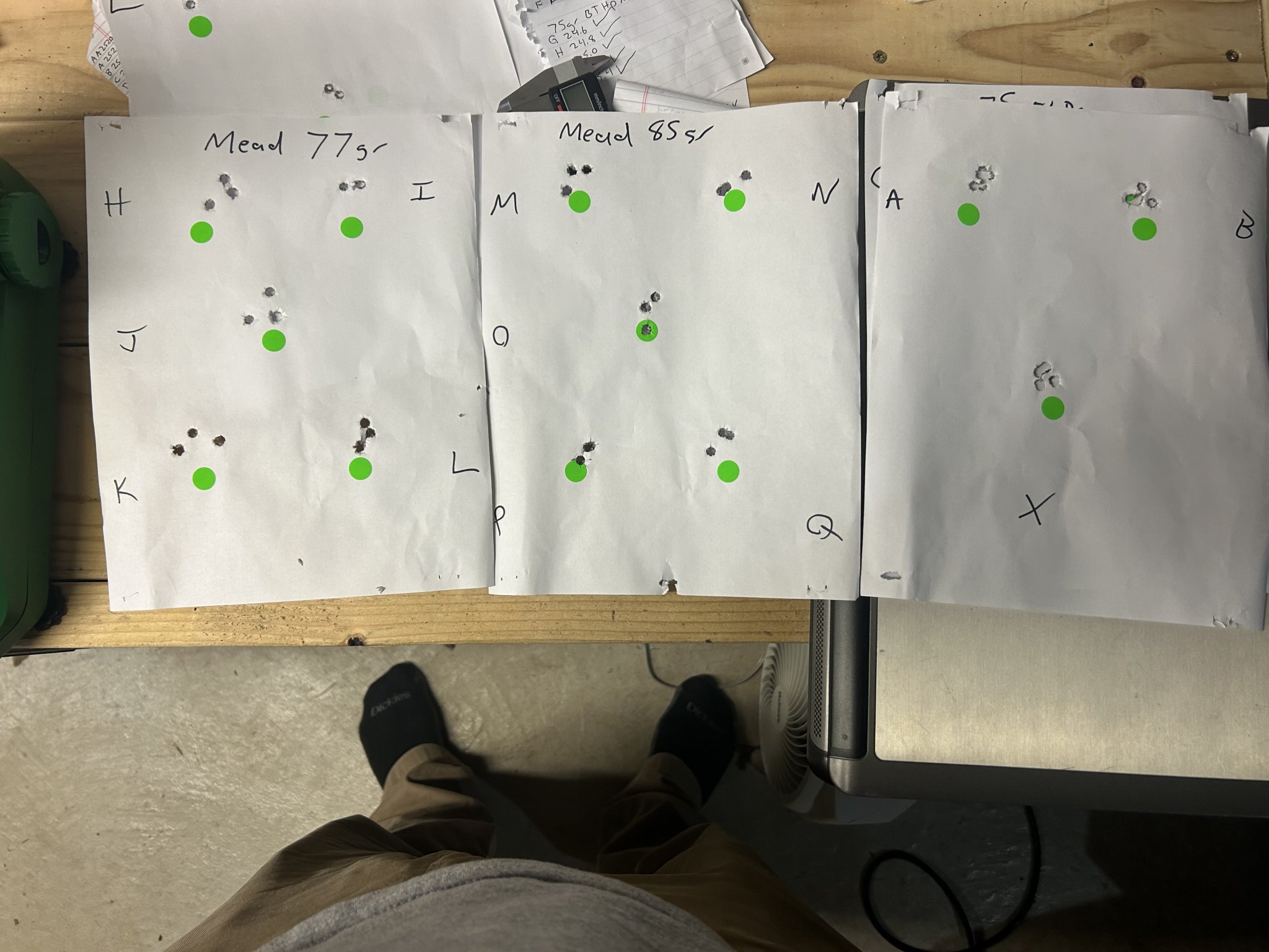

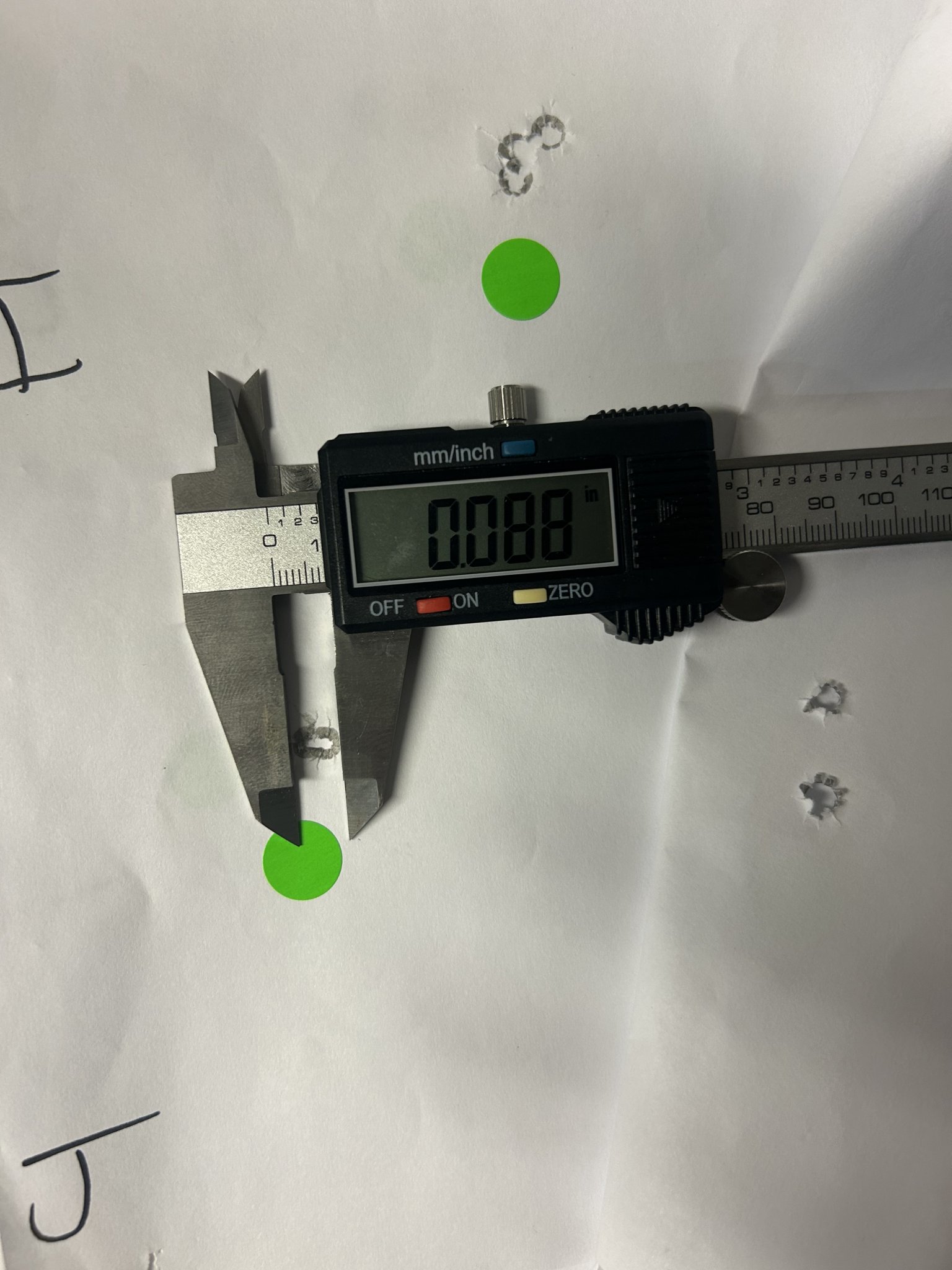

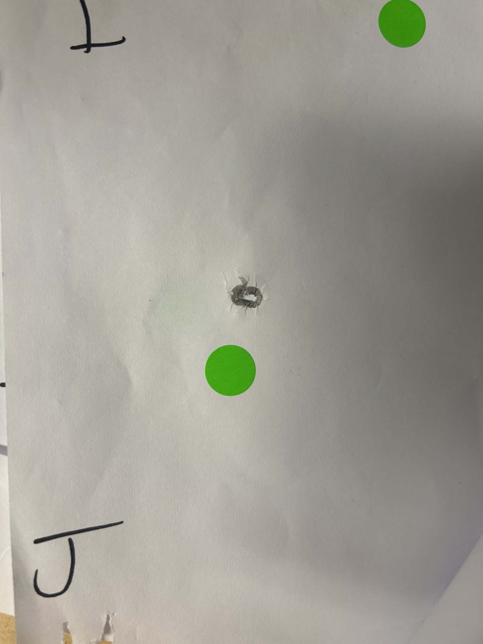

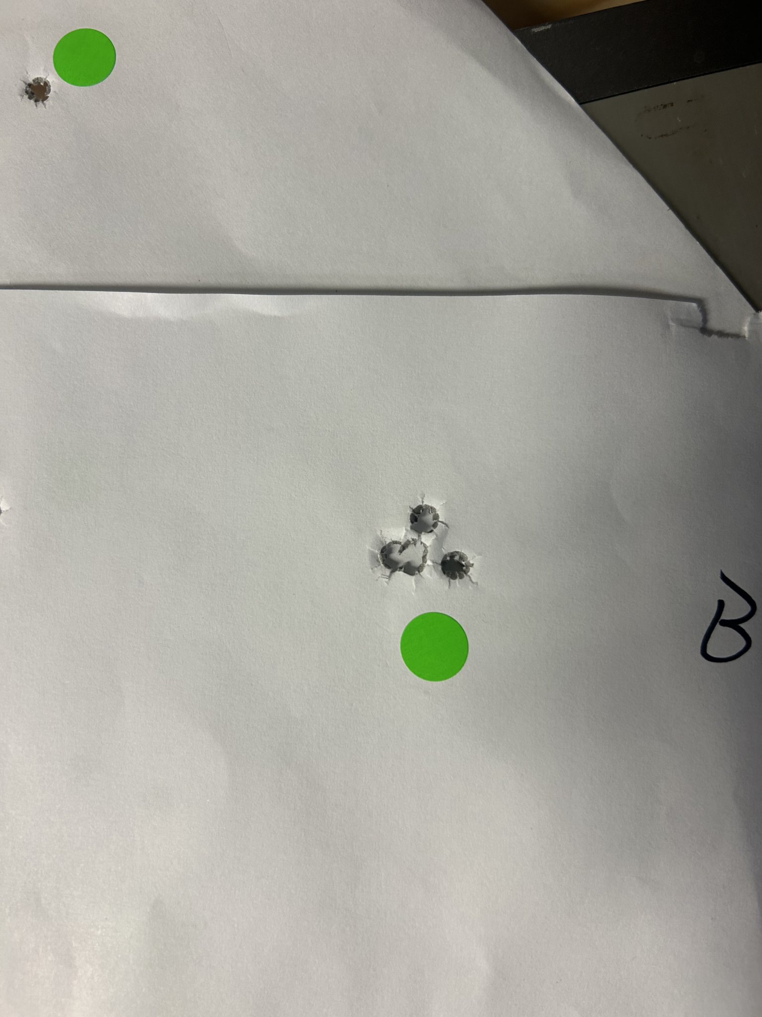

I loaded up 6 different bullets to try and THE ones I didn’t want to work hammered. So I loaded it again for a 5 shot group while trying to make other bullets work. The first 3 hammered again, but then I got excited and pulled 2. Hornady 75gr bthp’s. Terrible bc (.395?) compared to other bullets but I primarily shoot 600 and in, and maby once a year 1k. So, should I let it eat with what it likes, or try my best to get something with a good bc to respectable results? These are cheap and I use pmc brass I process the hell out of. I always told myself if I was shooting expensive bullets or brass, it would be in a 6br or 6.5 creed, etc. which will come down the road.
26” 1:7 twist bolt gun.

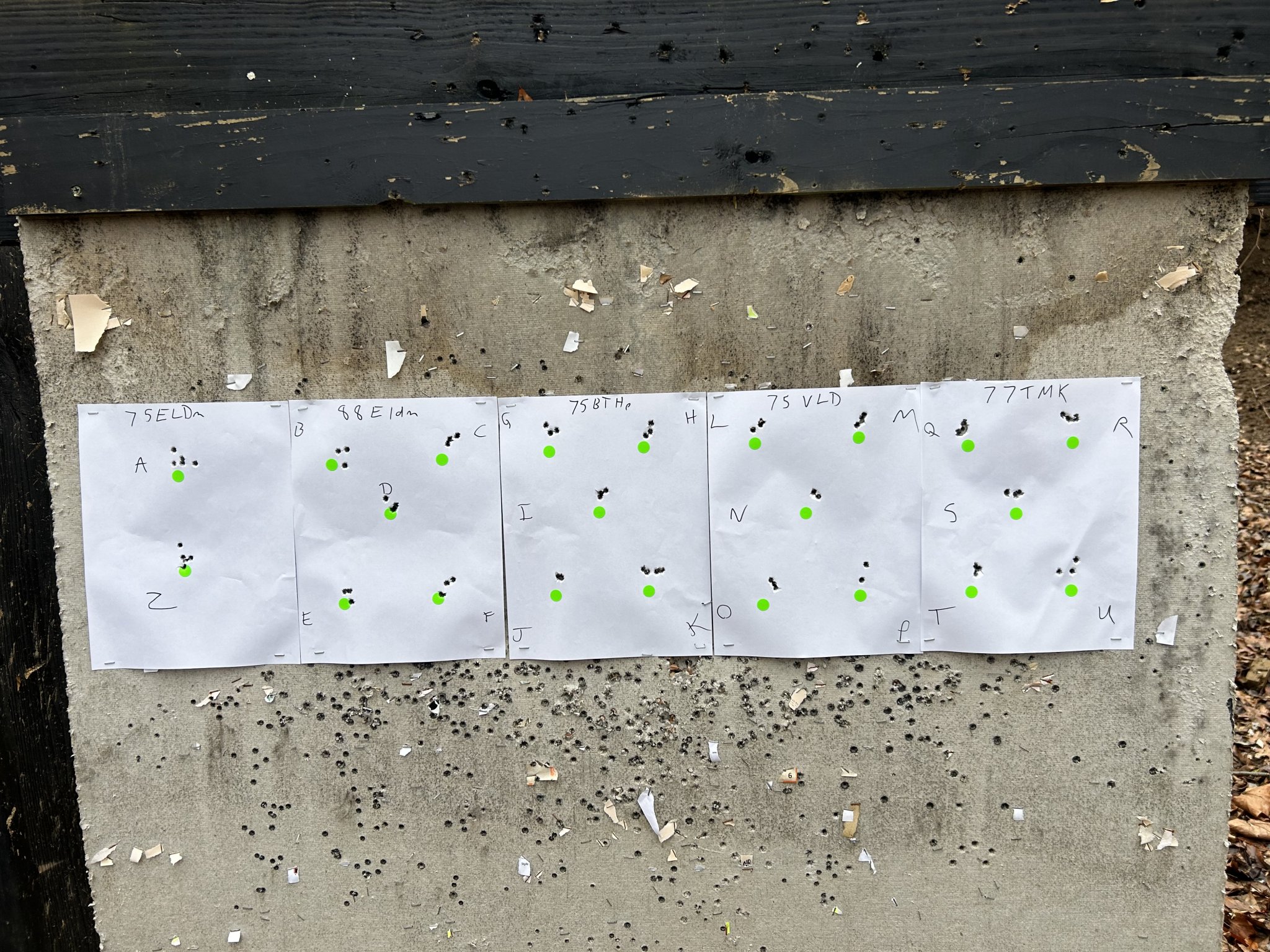

Hornady 75 eldm’s, Hornady 88 eldm’s, Berger 75 vid’s, Sierra 77TMK’s, mead 77gr bthp, mead 85gr bthp, and the 75gr bthp’s were discussing. Everything but the 75gr eldm’s shot half decent/good, and could definitely be tuned to work, but some are much more expensive, and the 75 bthp’s have been hammering. Before any further load development.
Vlds and TMK’s shot well, but are almost twice the price.
