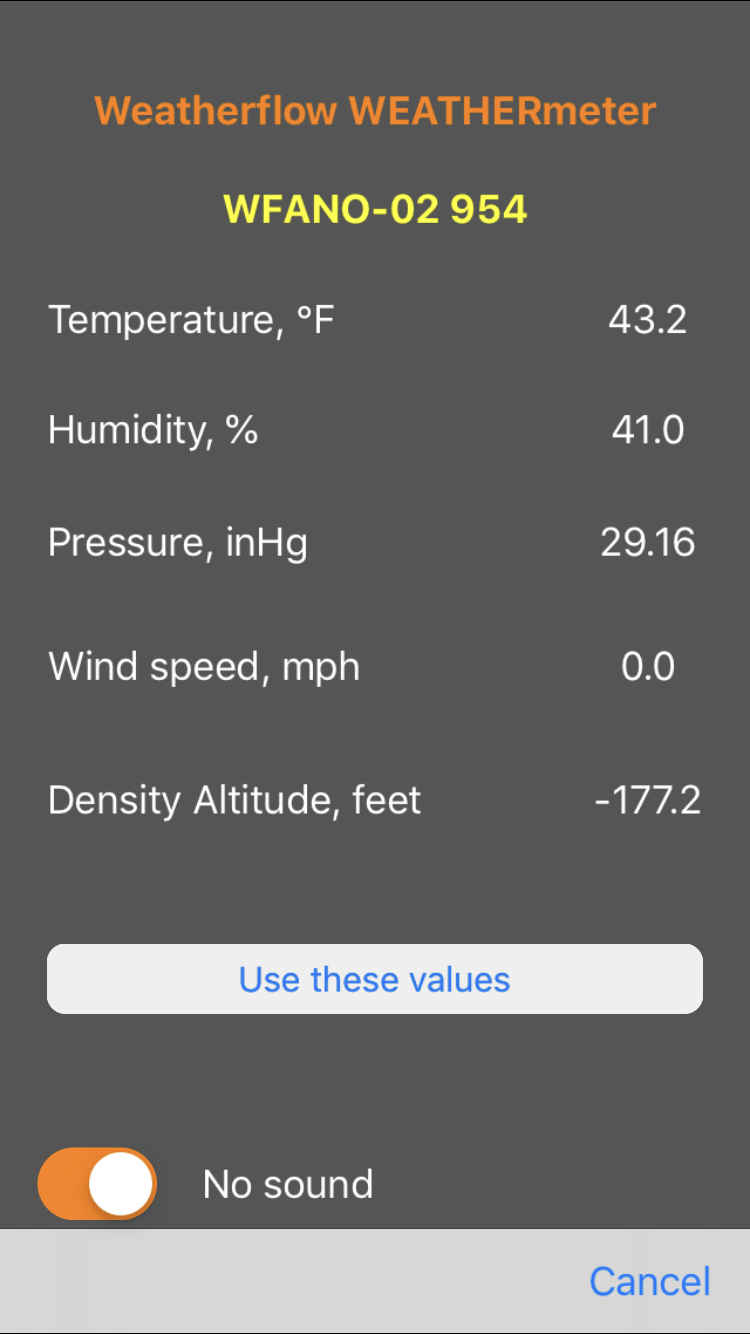

So, today I got my hands on a weatherflow weathermeter, about $60:
(https://www.amazon.com/Weatherflow-Handheld-Smart-Phone-Weather/dp/B011WT29HO)
(https://shop.weatherflow.com/collections/meters/products/weathermeter)
In my backyard, I shoved it in a Kestrel 4000 weathervane mount ($50), with a block of wood as a spacer to keep it in position.
(https://www.amazon.com/Kestrel-4000-Rotating-Vane-Mount/dp/B001JEPK2E)
I paired it with my iPhone, calibrated the compass and was able to get the following data wirelessly via bluetooth into
4DOF (I shoot mainly Hornady bullets.)
Windspeed
Wind Direction relative to True North (0-360)
Temperature
Station Pressure
Humidity
Seems all that is left is to input the range, angle to target and a target azimuth.

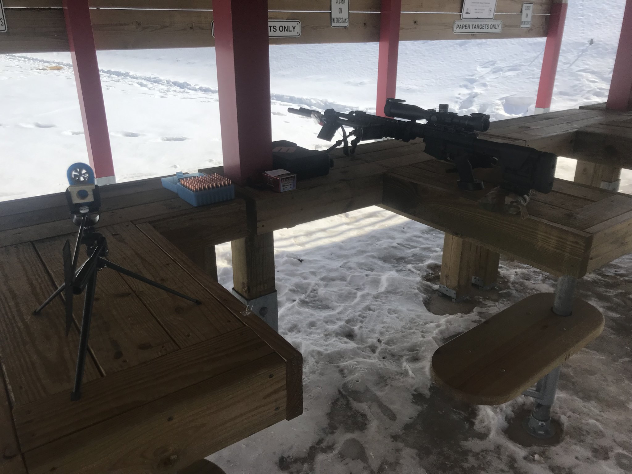

Took the weathermeter contraption out to the range for zero conditions. Set it up for a test on the bench. Spun itself into the mild wind (3mph) and reported environmentals like a champ.
4DOF crashes when no data available on the phone. StrelokPro worked great.
I’m looking into getting a cheap used iPhone with a rugged case for a dedicated setup, maybe attach it to the rail.
