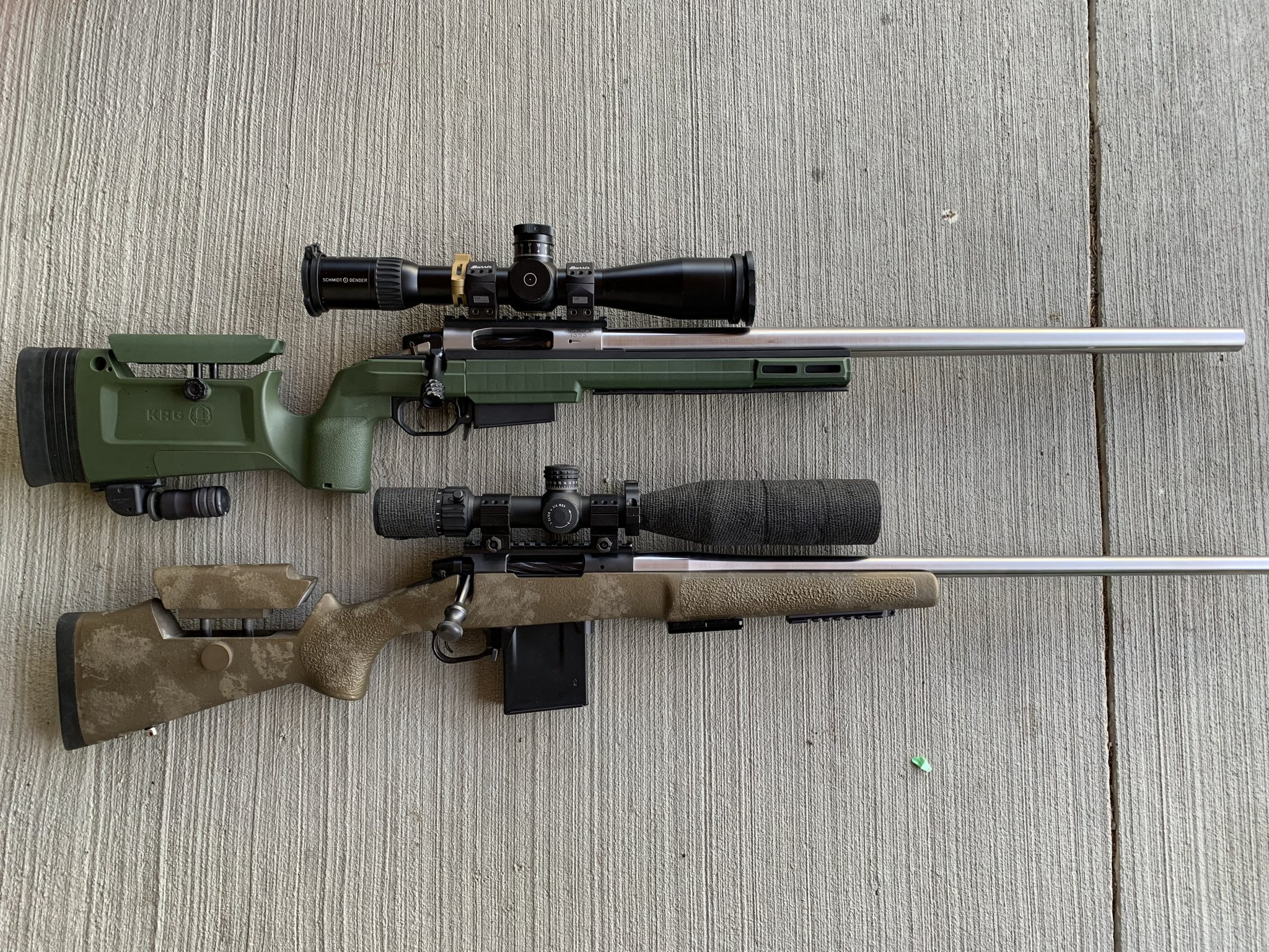

These are the two currently. 223 tl3 (bravo) target/practice gun weighing in at 17lbs and then my 20 tac ks arms sar action weighing in at 11.5lbs if I recall. I don’t like dragging out the 223 due to weight so would like to add another
