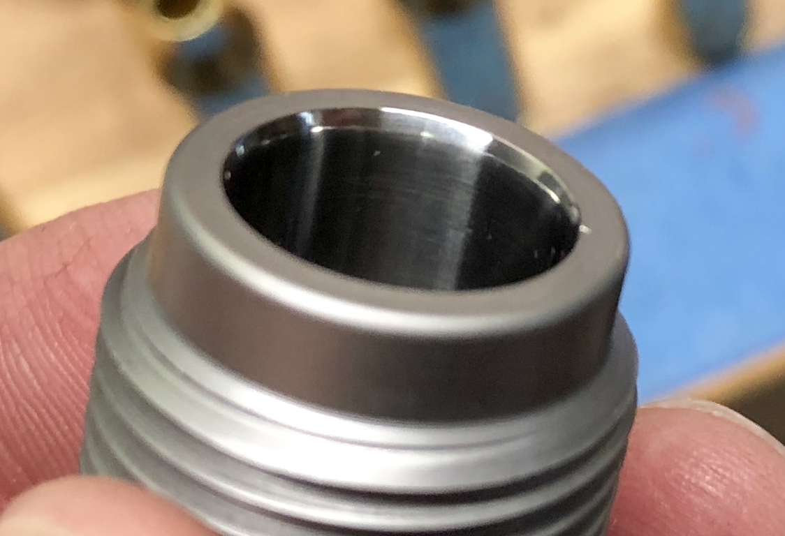

    Here is a pic of Hornady match 6.5prc FL sizer I bought on sale at midway for $24 bucks about a week ago. I own four sets of Hornady match dies in various cartridges, and every one of them look like my custom dies inside. Low effort sizing, not hungry for lube, and dimensionally very good(opposite of Redding lately). Couldn’t be happier.

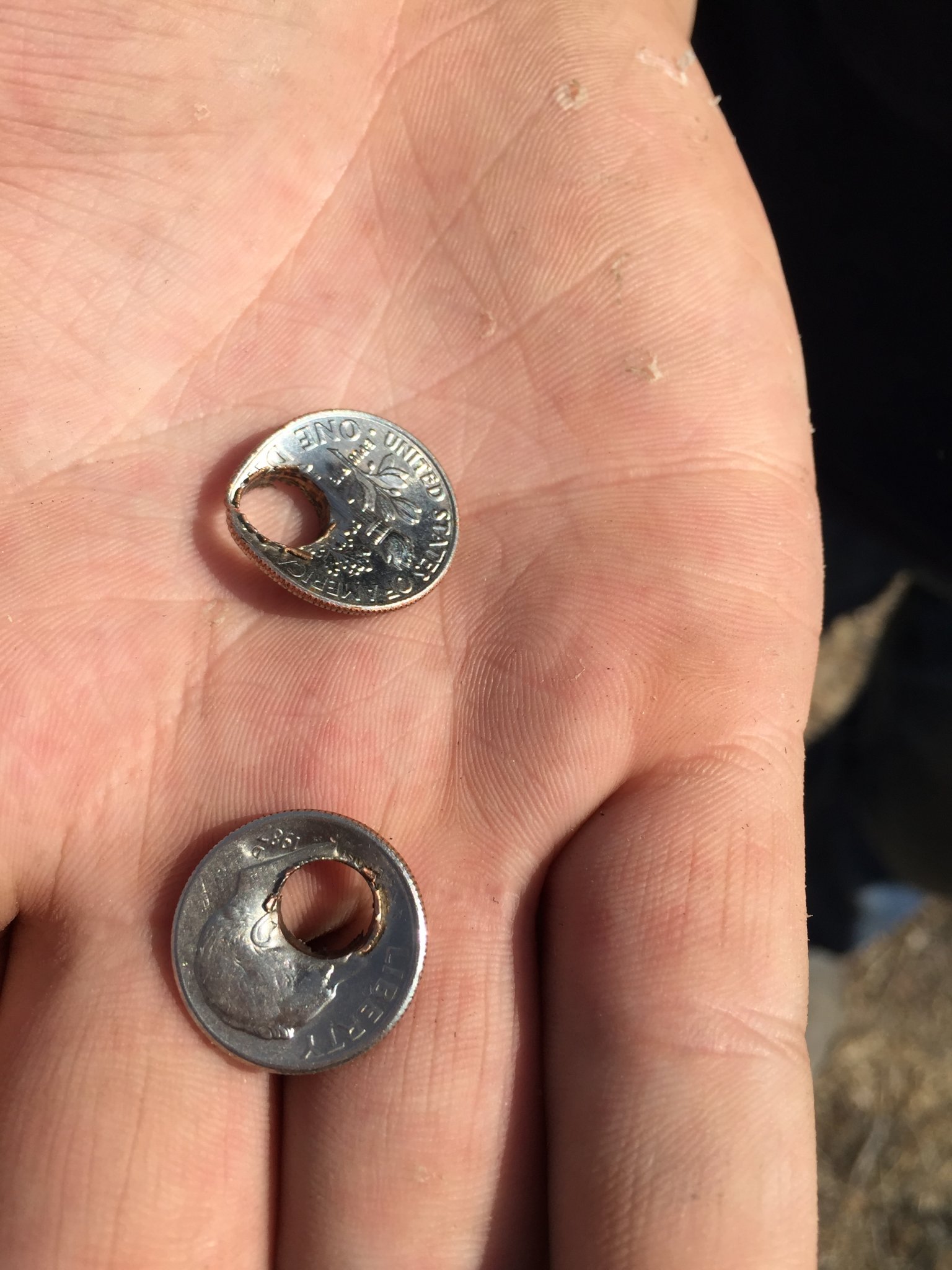

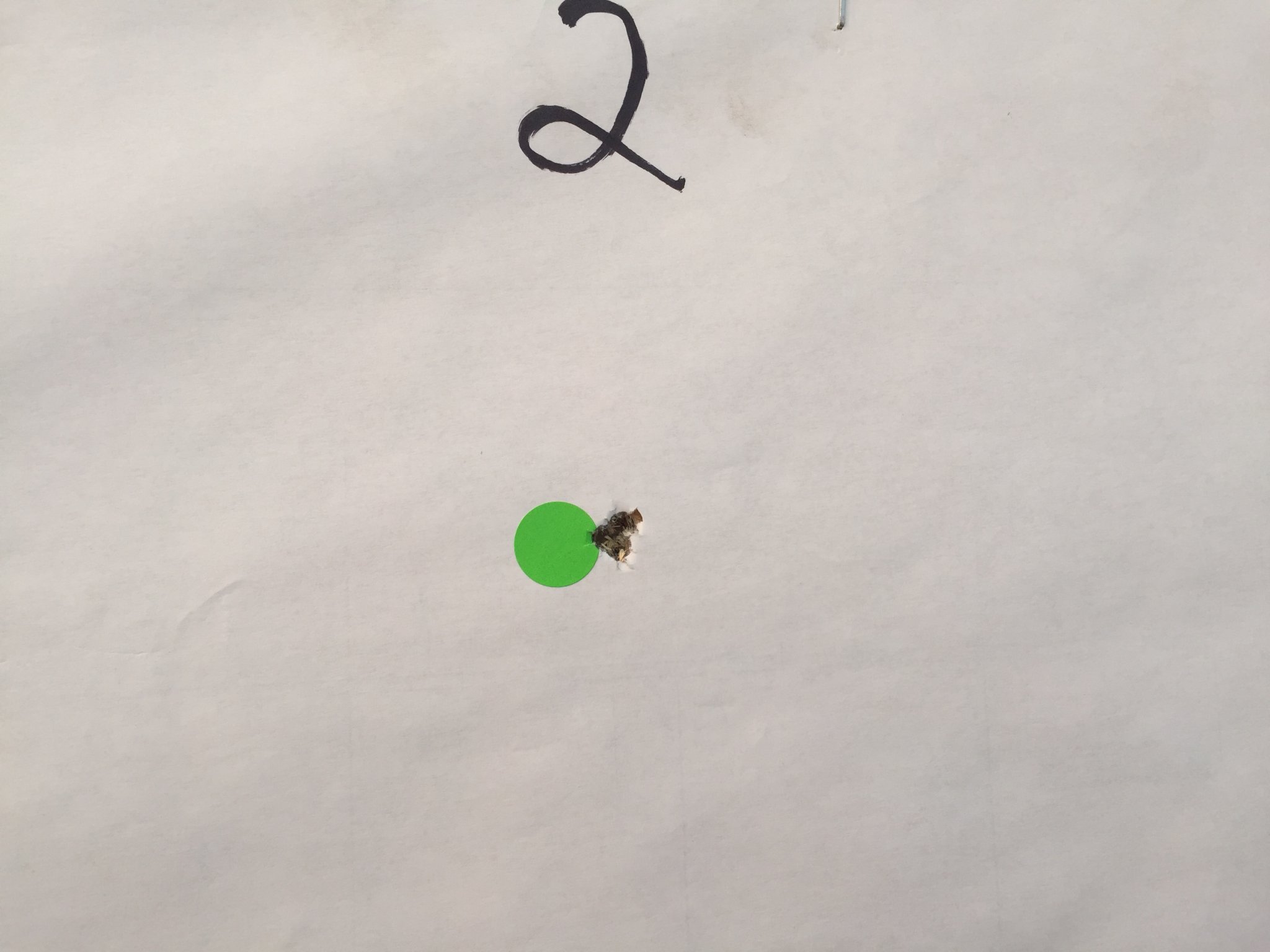

    I am not a group shooter but here’s 6 at 100 out of my 47
    Or how about cold bore dimes outta my buddies 6.5CM with 5x fired never annealed no prep outta the gun FL sized primed charged seated and shot Hornady brass
