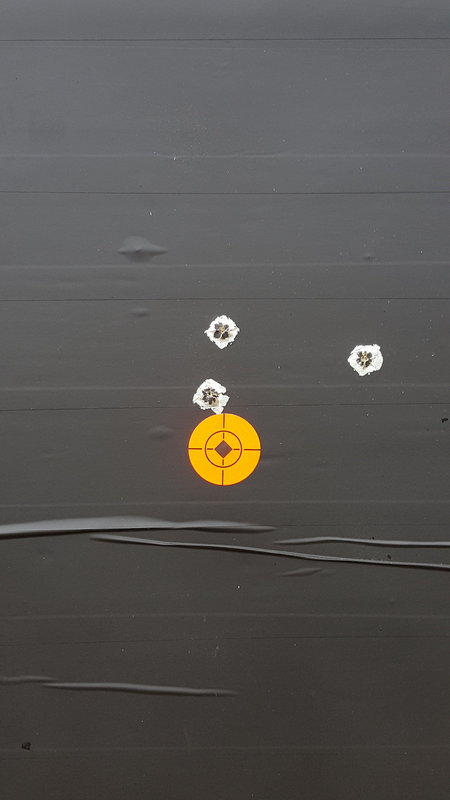

Ok I've got your answer. I got this idea from a bench rest shooter at my local range and it works great. I made a giant shoot and see board. Here's how...
Go to H Depot and buy a 4x8 sheet of foam board insulation with the reflective aluminum on one side. Like this stuff I just found in a quick google search: http://doverprojects.blogspot.com/2008/12/insulate-attic-door.html
On the reflective side, cover the whole thing with clear packing tape. I had 2" tape so that's what I used but I think you can get wider tape. Then paint over all the tape with flat black spray paint. That's it, now you have a shoot and see board that's 4X8. Unless you want to cut it down for transport, then just make a few smaller ones. Bring along your can of black spray paint to cover your shots and renew your target. Get creative with how to stand it up, shove rebar or t-posts in the ground and attach it to them. I use mine at 600 yards and can see the hits just fine. I put sticker dots on it but you could easily do what you want and use it as a backer for spotting.
The only pic I have of it is the one I'm attaching, sorry I don't have a pic of the whole thing. This was a few shots from 600. If you google search how to make shoot and see targets, you will see people making smaller versions.
