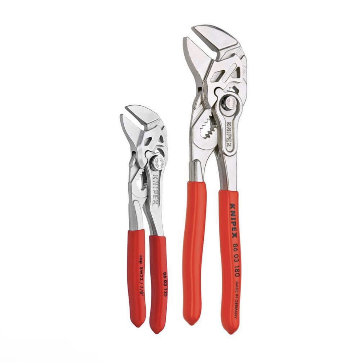

    Btw instead of plastidipping a wrench with serrations, for applicstions like this try a German Knipex Pliers Wrench. They have smooth and flat jaws. Something like +1:10power ratio to really grip stuff (go easy on suppressors!).
    They also sorta replace a bunch of sockets in a lightweight tool bag (unless you’ve got some nuts in tight places).
    I like the 150mm for gun stuff. They also make them with fat handles (don’t like them). https://www.knipex.com/products/pip...&sort_by=field_top_product&items_per_page=100

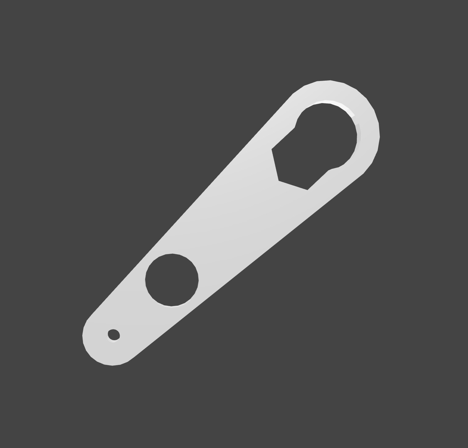

    I designed this for my 22TD and had my brother 3d print one for me. Works great! I did leave out the middle hole on the 3D print version though.
    Oh, hey! So it looks like it’s big enough to fit over the can while it’s attached to the gun and then you move it fwd to engage, right? Nice. I’d prob buy one (without the middle hole, good call).
    Yea that was the idea, to have it slide down the can but retain some of the strength of a closed wrench design. The final revision looks a little different but you get the idea.
