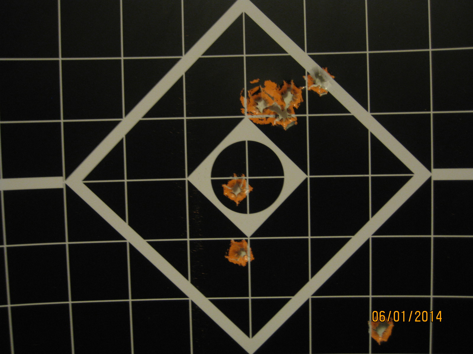

Well the advise from Zak regarding the shoulder of the barrel was exactly the problem. As you may recall Zak asked that I send him a picture of the barrel particularly the shoulder were the threads terminate. His critique was spot on and the barrel went into the smith and was modified per the detail Zak posted.
As I stated in my beginning post I was having problems with a windage POI shift as I increased distance and was not comfortable sending rounds downrange and not trusting the equipment enough to know where they were going.
Here is a picture of the results of the 200 yard suppressed string. The first one at the lower right had me going again because that is POI is exactly what lead me to question the equipment with the POI shift in windage being about 2" to 2-1/2" right. Then I stopped and remembered what Zak said after you shoot awhile... "Check the can to make sure it is tight against the barrel". Well once again Zak was spot on, the suppressor was loose, tightened it up and you can see from the target the rest is history and the problem has been solved.
So in closing I have to say as I said that many many thanks go out to Zak and the crew at TBAC for helping me get to the root problem and it was my equipment not TBAC that was causing the POI shift, and to the gunsmiths at Wright Amory at C2 Tactical in Phoenix that not only knew exactly what Zak was talking about and took the barrel in on Saturday morning with a quoted price to turn it down and said it could be ready the same day but really look for it on Tuesday after Memorial Day because of the backlog. Well I got a text message about 45 minutes later the barrel was done. Headed back to Wright Amory to pick the barrel up and they charged me half of the quoted price. So to anyone in the Phoenix area please check out Wright Armory, stand up people and quality service .
Many thanks to all of the professionals that help me find the root cause of the problem, get it corrected and back on target.
