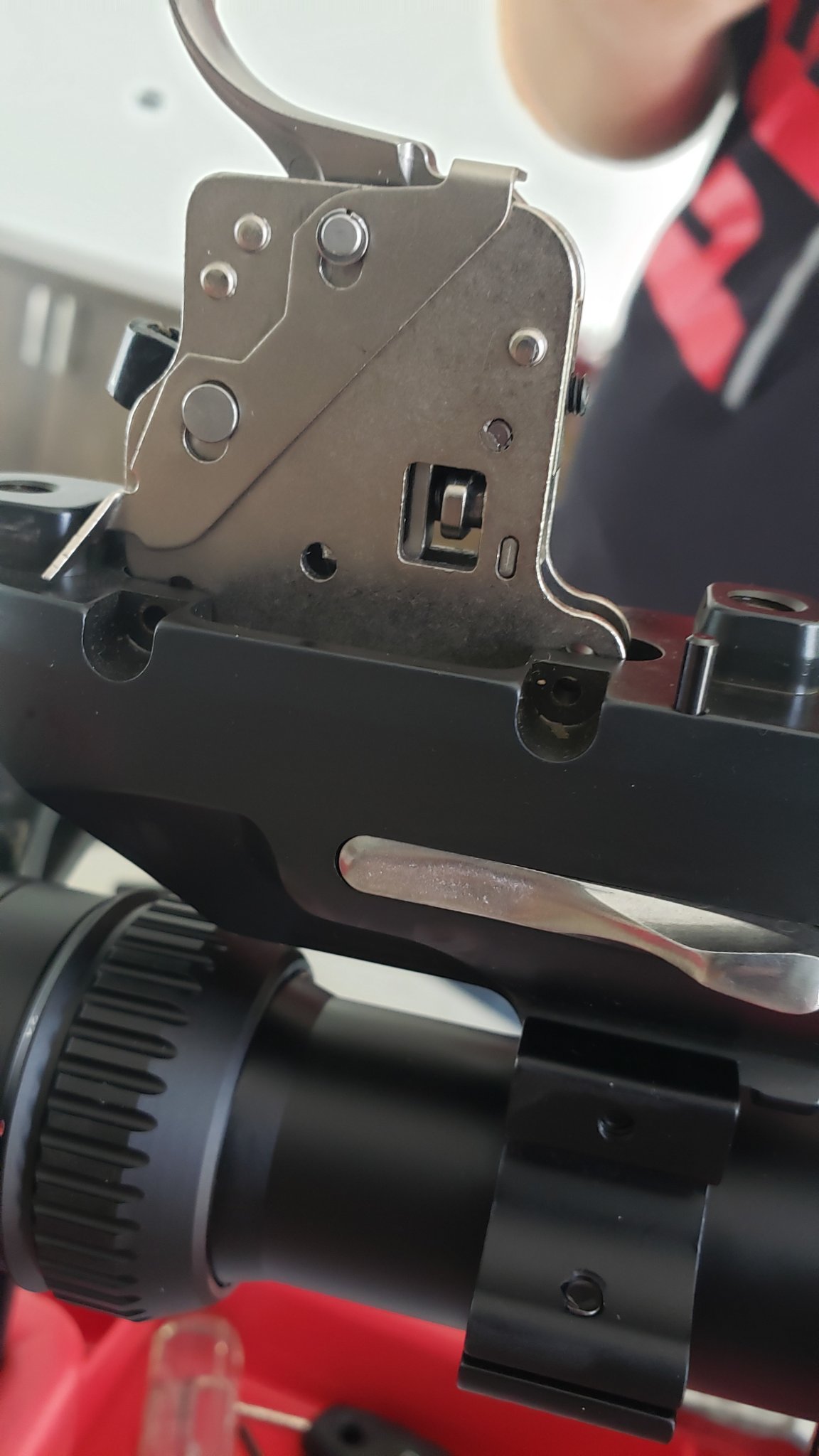

I also wanted to change the trigger on this rifle, but nobody sells one, what would be a near fit, I was told maybe anchutz but i find it fairly similar to REM 700 trigger, I wonder if I could make this trigger work. Please help.
7112818
REM 700
this is a pretty close fit, i would have to machine the top piece that holds the bolt back, I would also need to shave the top of the trigger for the holes to match properly, and modify the stock a little, trigger is longer so I dont know if it will fit the trigger guard, maybe someone with a little more skills than me can help.
I have one, but don't know off the top of my head what the action screw size/pitch is, nor do I have an easy way to determine what it is even if I pull my rifle apart.
As for the trigger, I cut what I can only describe as the trigger pre-load spring (behind the trigger pull weight adjustment screw/nut on the trigger housing) a bit and noticeably lightened the pull (I was inspired by the Howa HACT trigger mod).

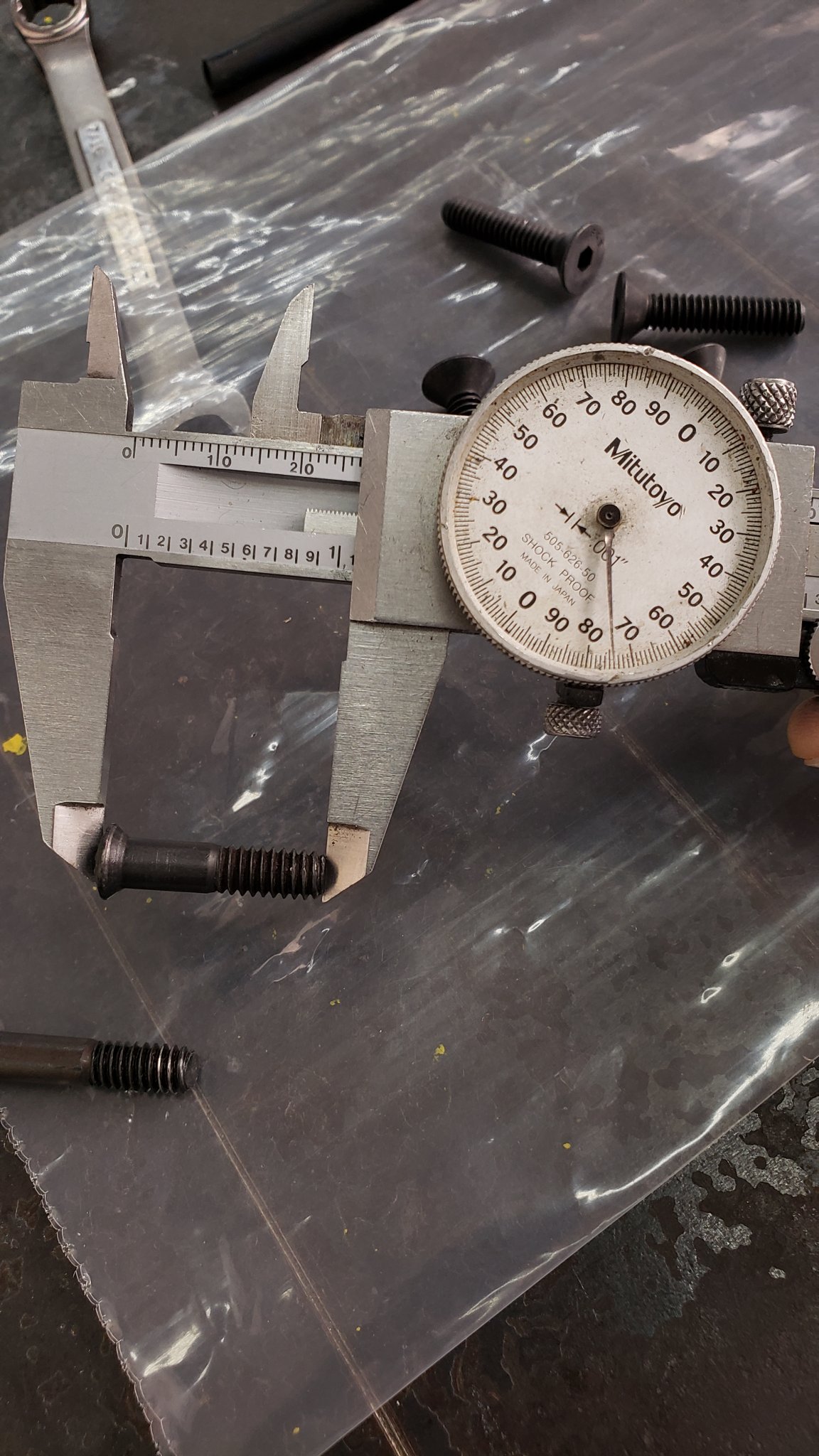

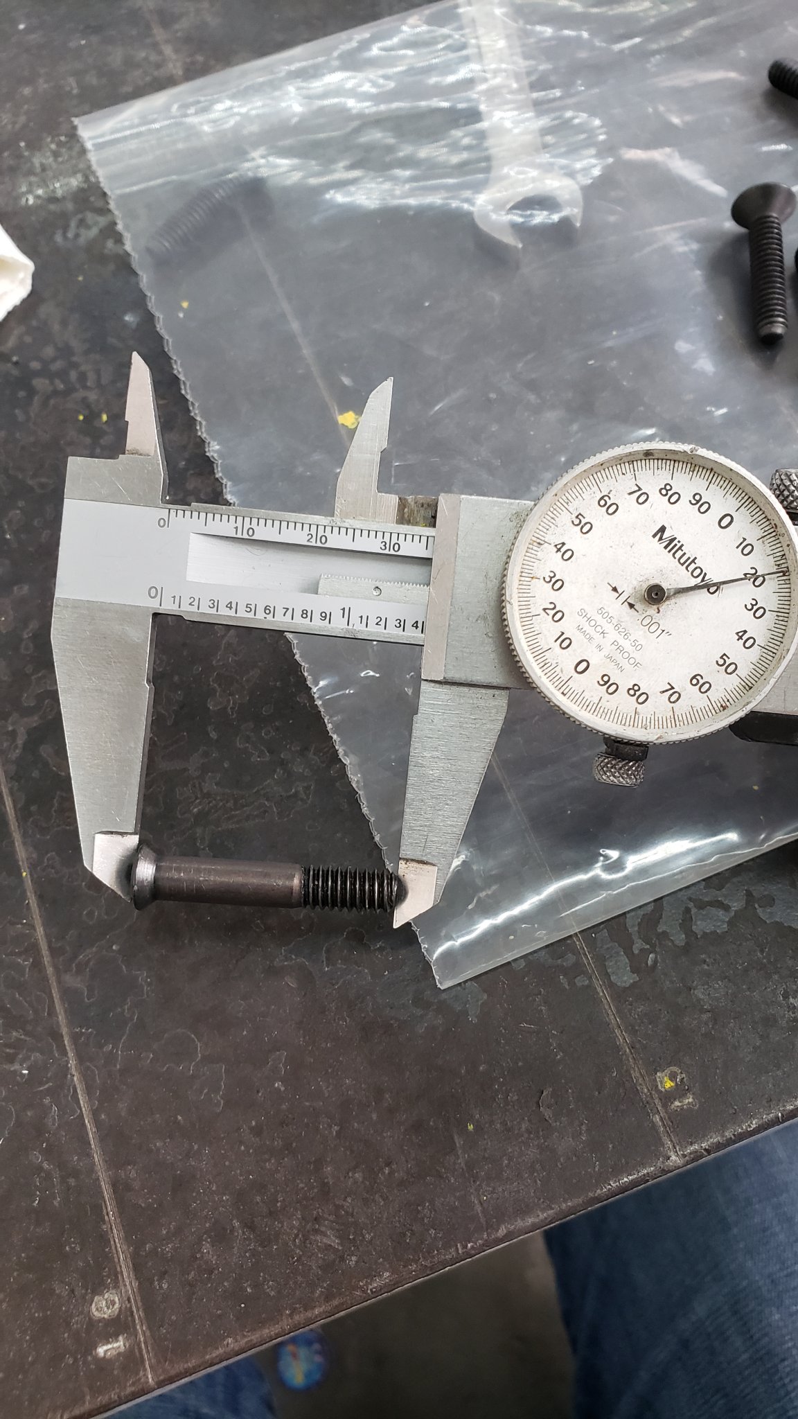

For TC Icon action screw are as follows
Short front:
1/4 inch diameter
thread pitch is 20
shank length .460
Full Length 1.075
Long rear x 2
1/4 inch diameter
thread pitch 20
Shank length .80
Full Length: 1.420
