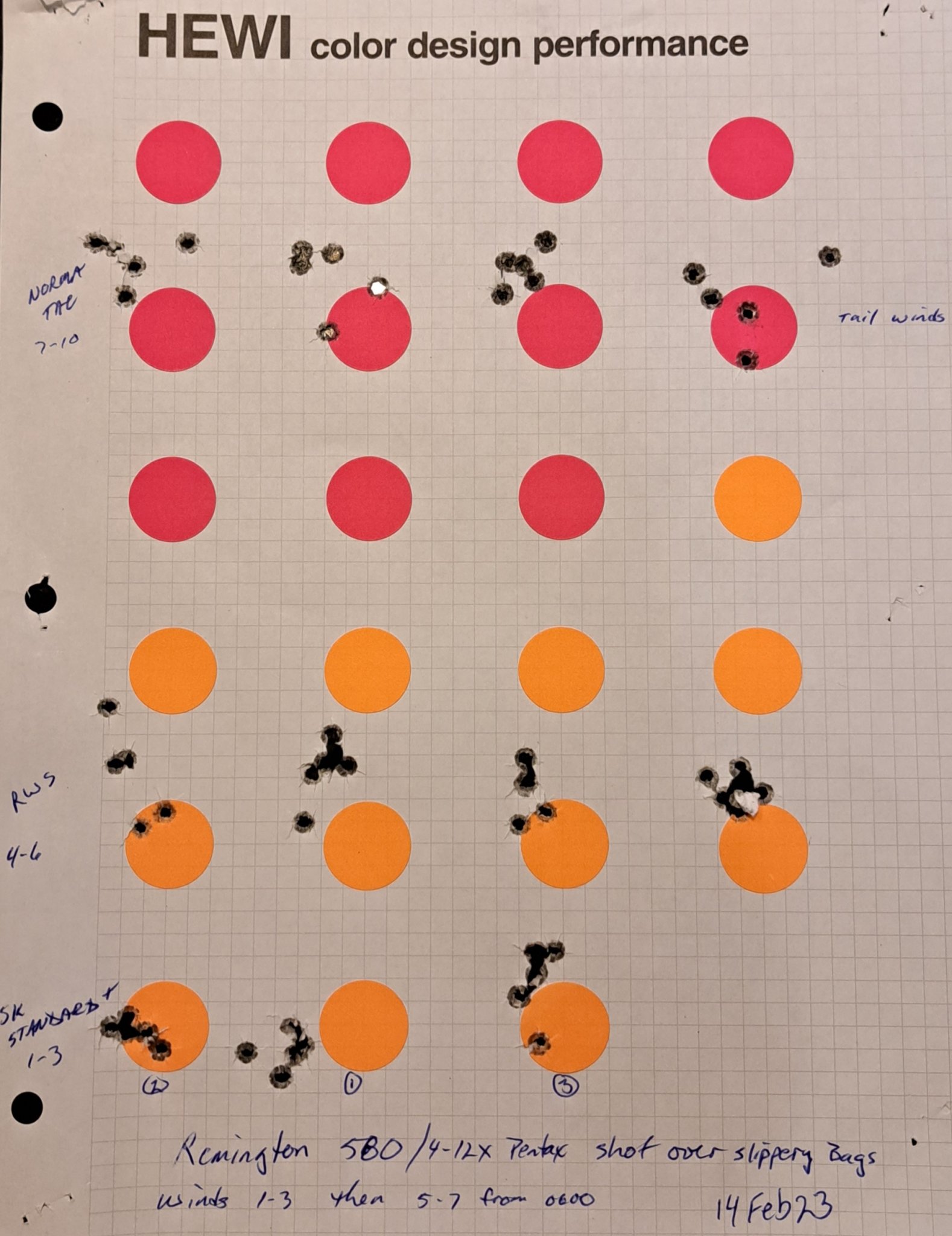

The target below was shot @50yds with a pencil-barreled Remington 580.
It has a compact Pentax mini 4-12X and a beyond horrible trigger that must be 9lbs or more.
The groups were shot over Cordura bags, so maintaining a good hold was difficult to say the least.
It needs either better bags or a bipod, but I'm reluctant to drill it for a stud.
I used 7 or 8 shots of the SK to get a decent zero and then shot the three groups on the bottom as they are numbered. Yes, I did correct impact point before the second group. No changes were made after that.
By all appearances, as I was shooting the third group, velocity went up.
Notice that the group sizes were relatively the same with the exception of the lowest shot on group three. Remember the previous 7-8 "foulers."
Next up was RWS Target Rifle.
Groups shot were left to right. Bigger to smaller.
Last was Norma Tac. By the third group, it started to settle down. Just as I started the fourth group, the winds picked up to 5-7 mph from the 6:00. Group size immediately went to shit.
Like you, (and most others) I noticed after a group or two, the gathering would begin and get better as groups were fired.
I've heard that RWS and SK use the same coating, but in this case I'm pretty sure it's not true.
I have shot SK and Lapua with no seasoning issues though.
