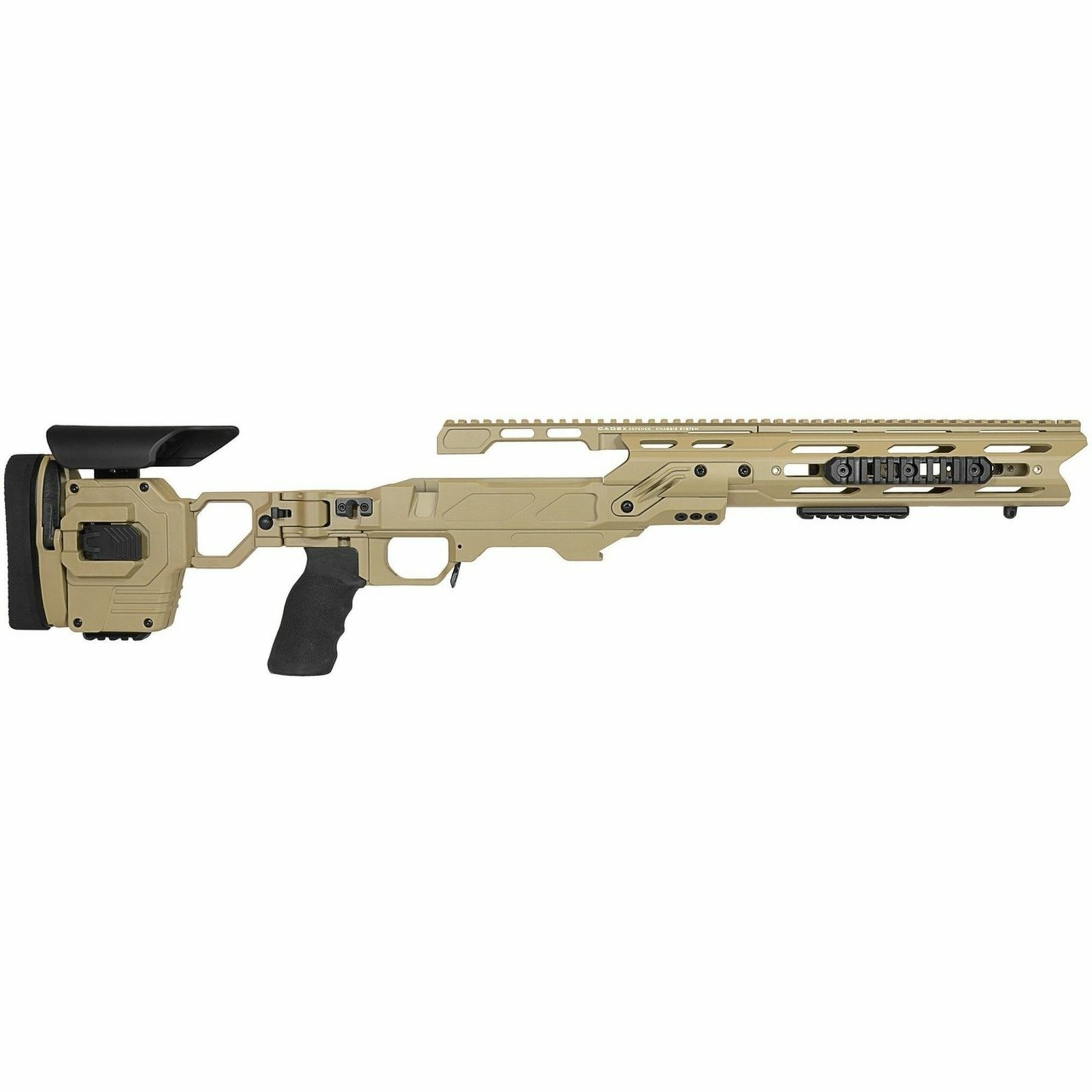

    They are not using the chassis pic rail extension. They are using the tempest supplied rail. This is the 50cal I quickly found, same concept.
    cadex-precision-rifle-chassis-tan-cadex-dual-strike-50-cal-chassis-for-mcmillan-tac-50-receive...jpg

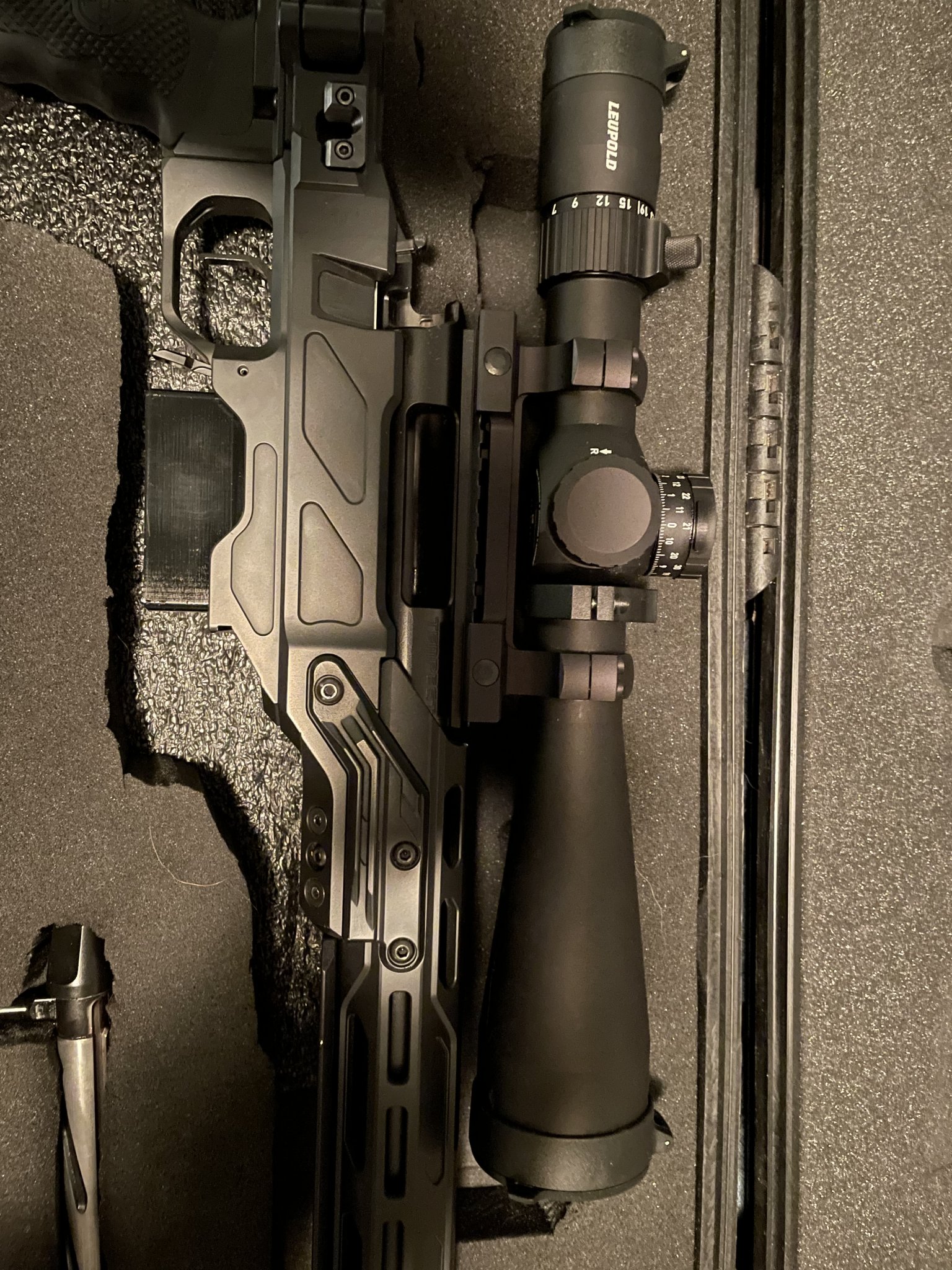

    I had the chassis prior to owning a Tempest action. I ended up getting a competition forend, and left the 20moa rail, I did have to modify the rail so the forend would fit. I’m bummed that the top rail didn’t work out, However, stoked how the competition forend worked out.
    In the end I’m moving on and looking to sell the Cadex go to a Manners PRS.
