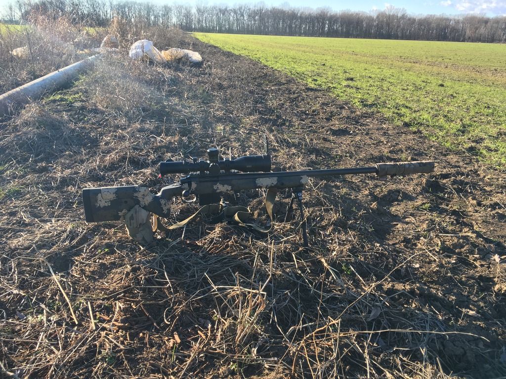

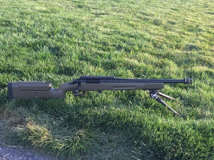

    Old picture of the tempest. She looks different now. I'll post that photo eventually.

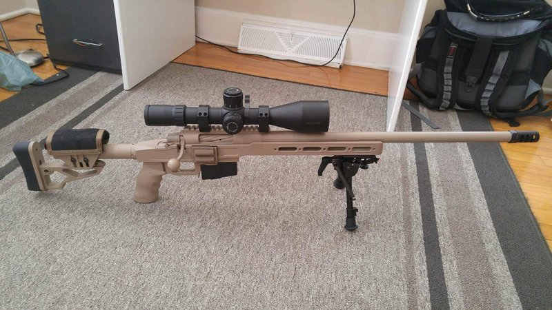

    Mine will be as follows (hoping to have it done by the of the month):
    Tempest (Nitrided)
    Bix'n Andy Comp
    J Allen Enterprises (custom colors)
    Atlas PSR
    Proof Stainless for now, will chamber a couple barrels for it.
    MPA 1 piece mount and self timing 6.5 premium brake
    Vortex G2 Razor 4.5-27

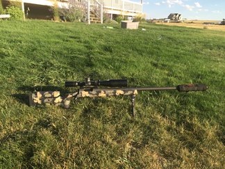

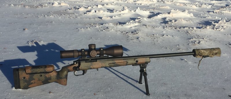

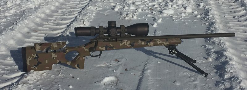

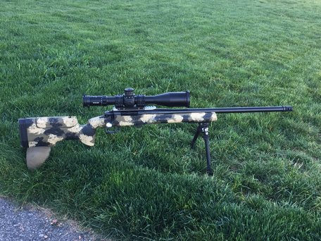

    A few that I built last year. One for me and the rest for customers

    Finally the completed rifle

    Looks amazing Shane, how's she shoot?
    No load development yet, just a base load at 41.7 with 4451 to get some rounds on the barrel It shot about 1/2 moa. Maybe a little over half. I am going to try to knock out load development tomorrow morning. The mirage was too bad to do it over the weekend.
    Loaded up some groups with the 130gr hybrids and IMR 4166 from 36-37gr in 1/2gr increments. Thus far much more consistent than the Normas. I'm going to see if i can manage to push further as i haven't come across pressure signs yet and other than my fault with fliers 36 and 37 look pretty decent. I think i can tighten up 37gr. I hope i can get 2900fps this time around.
