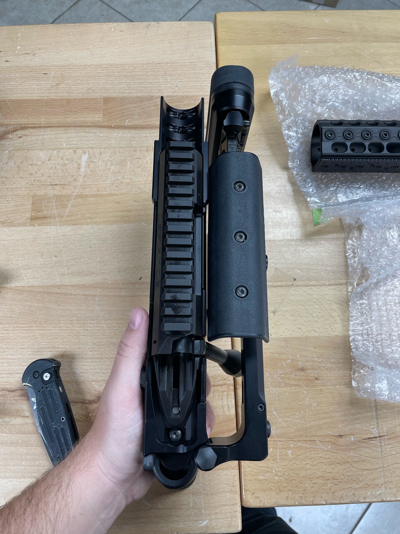

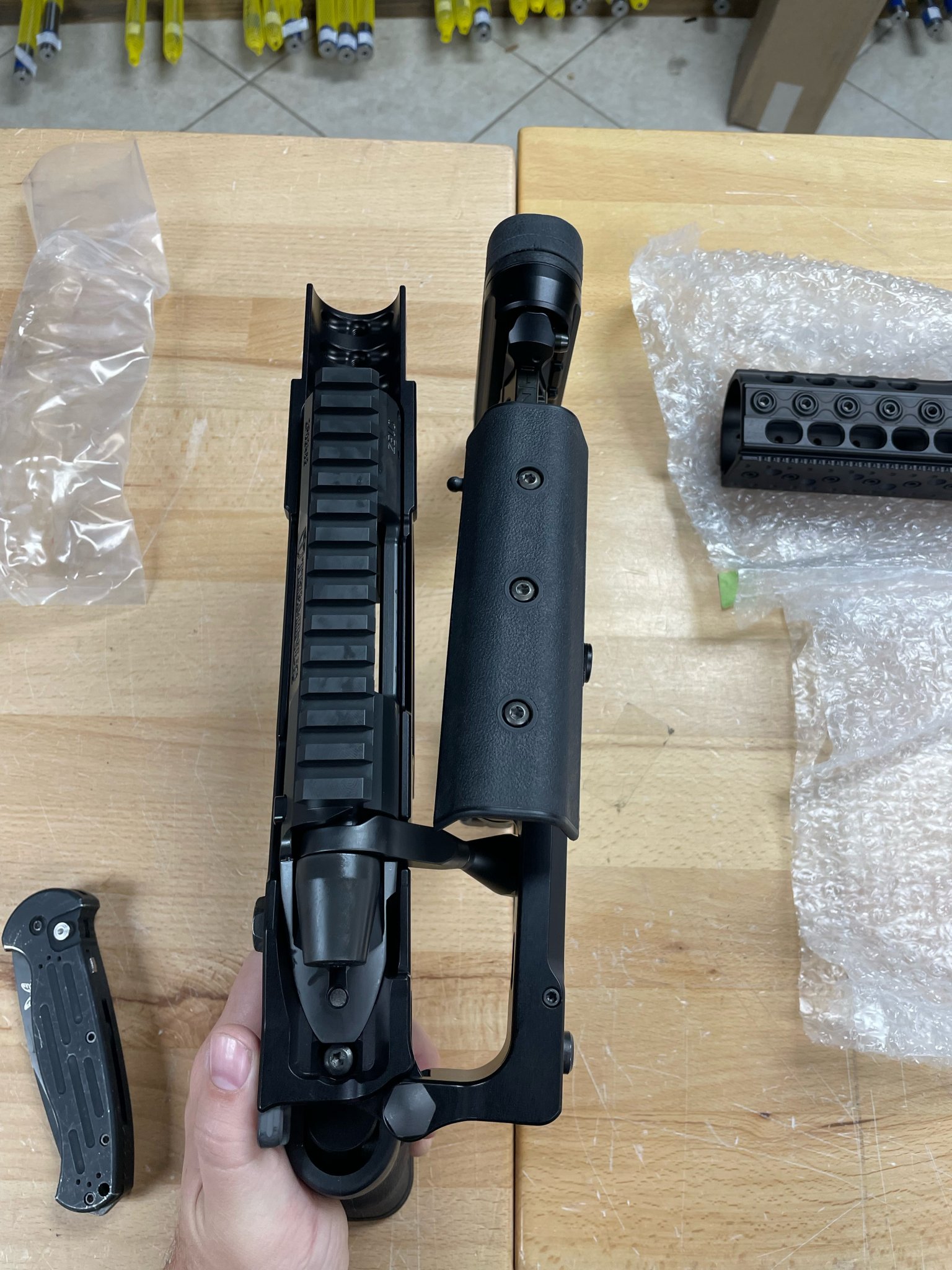

I slightly ground my cadex and it clears the terminus. It won't clear without a little mod

Thanks, I was looking at a Cadex good to know. JP may be the best bet, I was also considering an AI chassis, SICS, or Vision but don’t really want to not be sure.

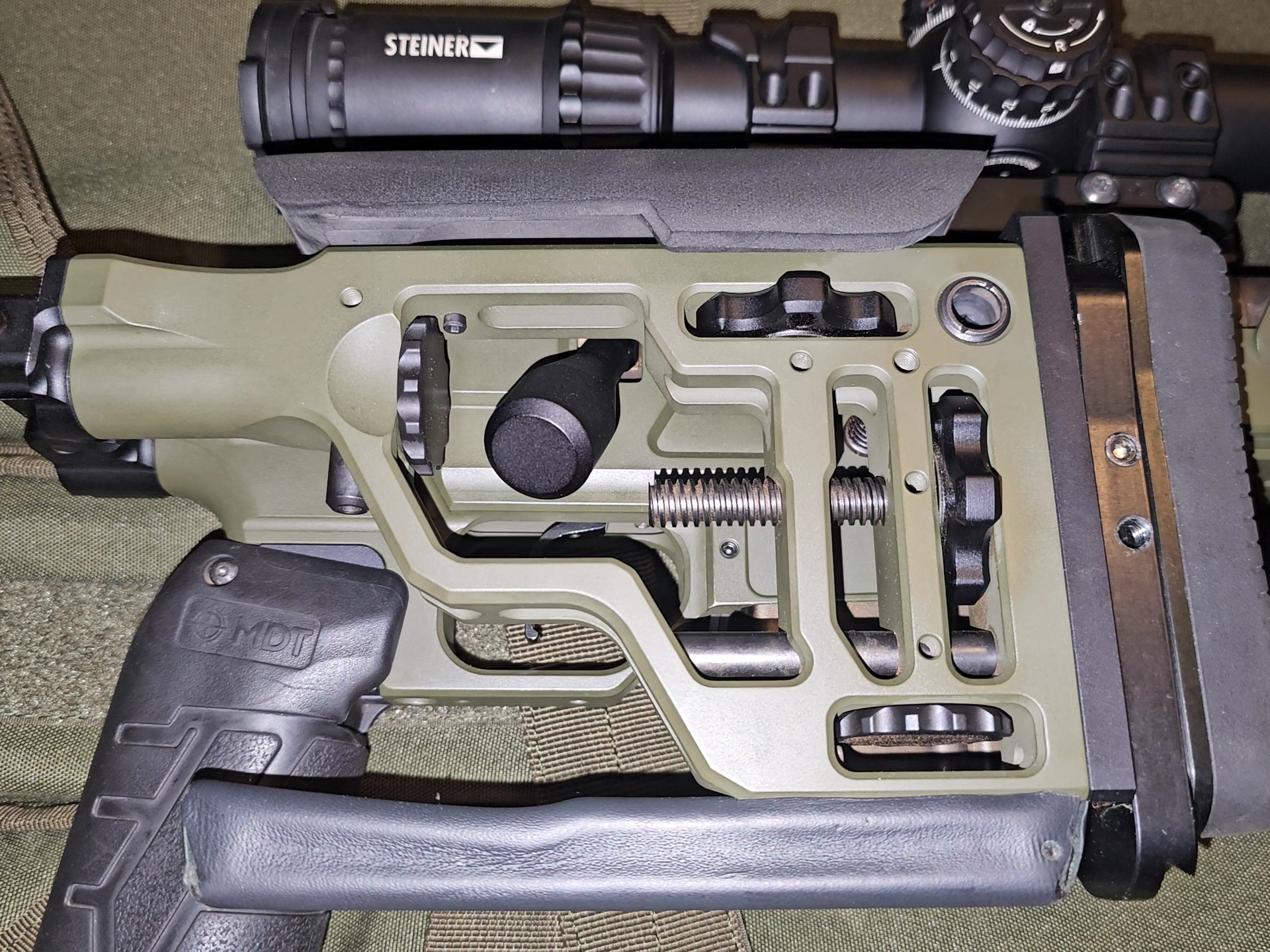

My visions work great with Zues and Valor. You shouldn't have any issues there. The W3 folder also worked but I like the Vision mechanisms better because it so streamlined. Vision is a really good one. Ive not used a JP but it's more AR like I think. It's hard to beat the Vision imo

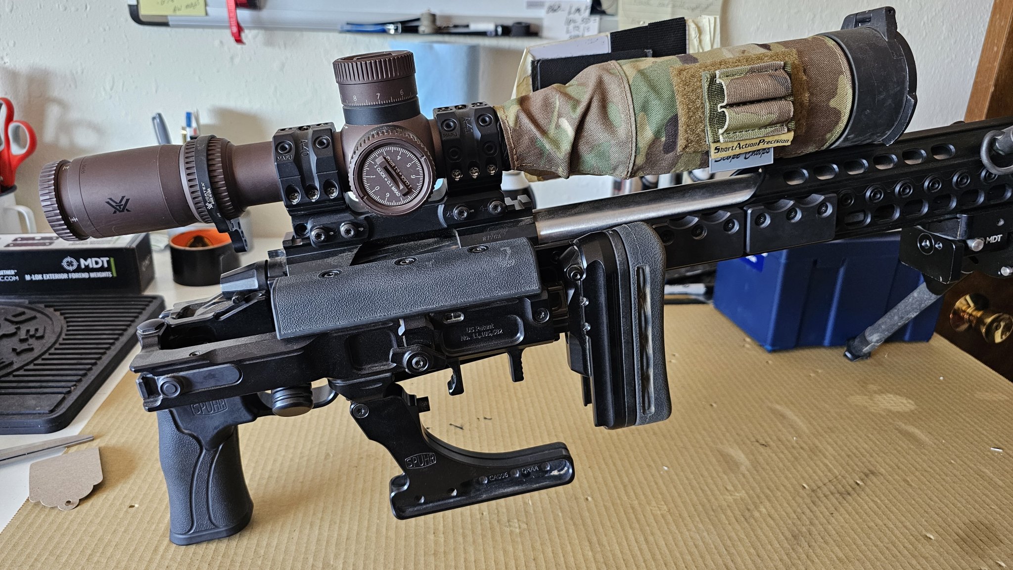

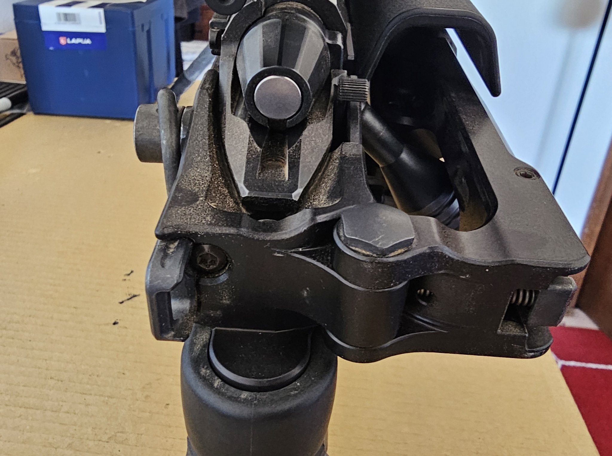

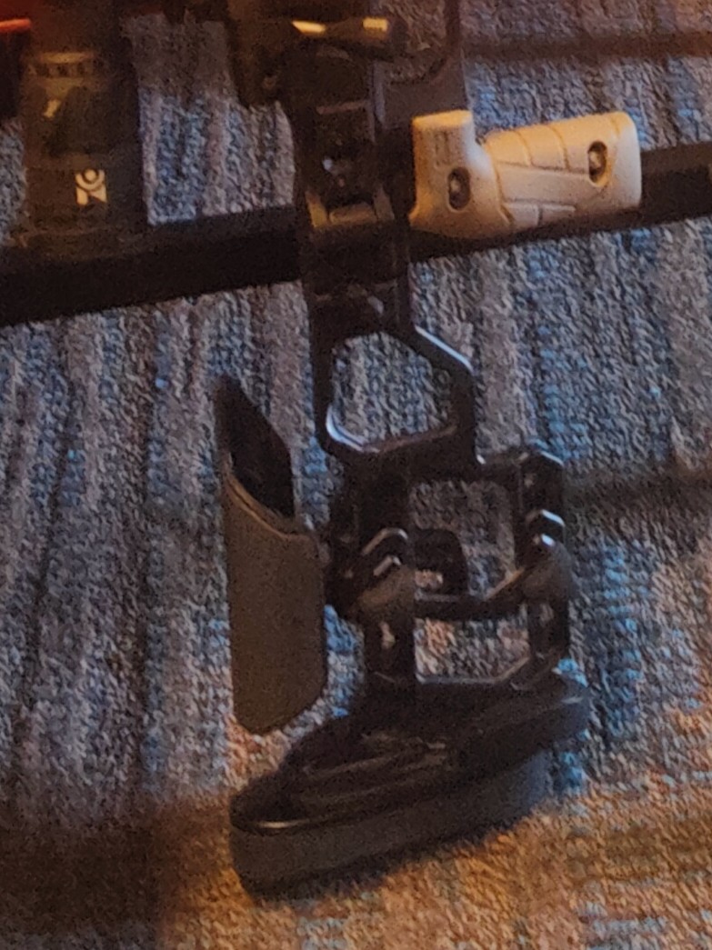

Pictured is my Impact 737. It perfectly captures that bolt handle.

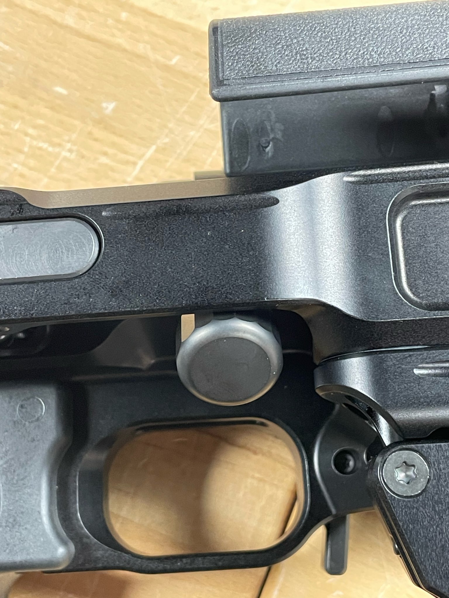

I guess it would depend on where the bolt handle stopped on the downward travel. I have the JP APAC with a Zermatt Origin (90 degree) and it has about 3/16ish of play before it hits the stock
