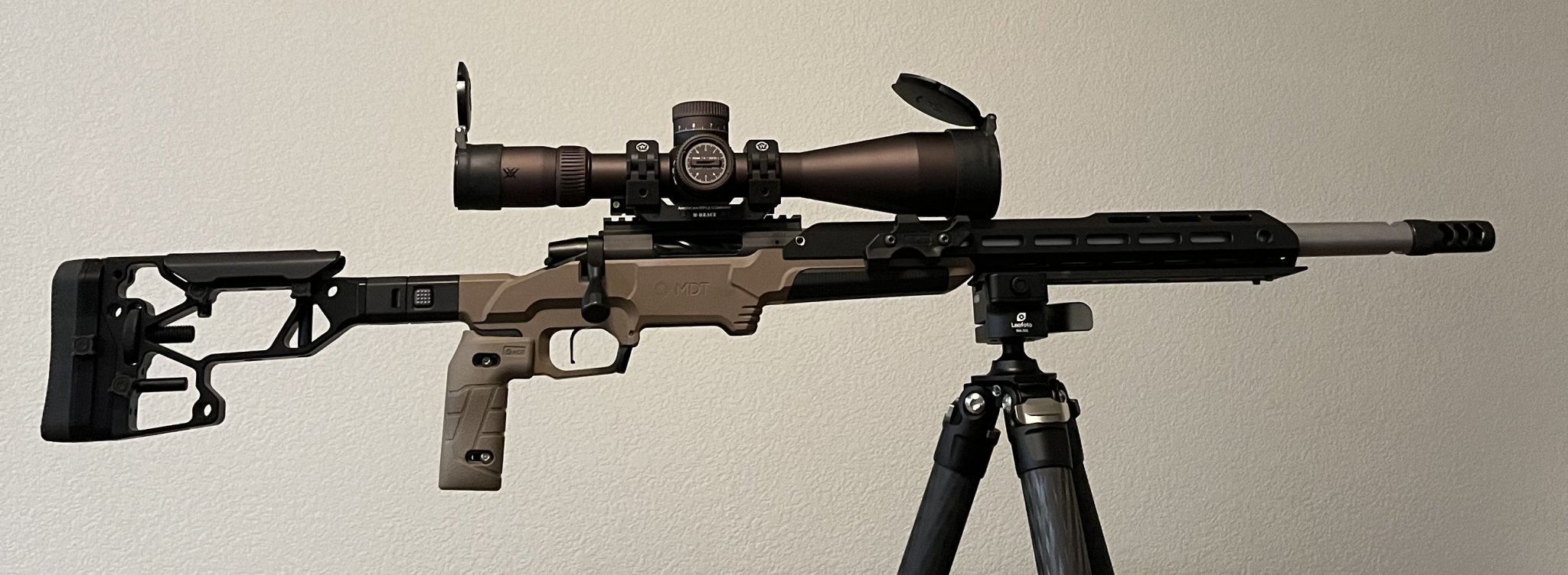

Similar question, but on a Zeus SA quick change and an ESS Chassis with the fore end, would I be able to access the allen bits to change the barrel?
Sorry for the late response. From what I can see you won’t be able to. However, a small drill bit would solve that issue and would probably be unnoticeable to most.
Also, the ESS forend is only held in place by two screws so it shouldn’t be too hard to slide the forend forward to access the barrel screws when changing the barrel.
I had to add holes for screws in mine
Reactions: Screach
Once you colour the bare aluminum it’s barely noticeable. Trick is to get the hole placement just right so you can use a smaller drill size
