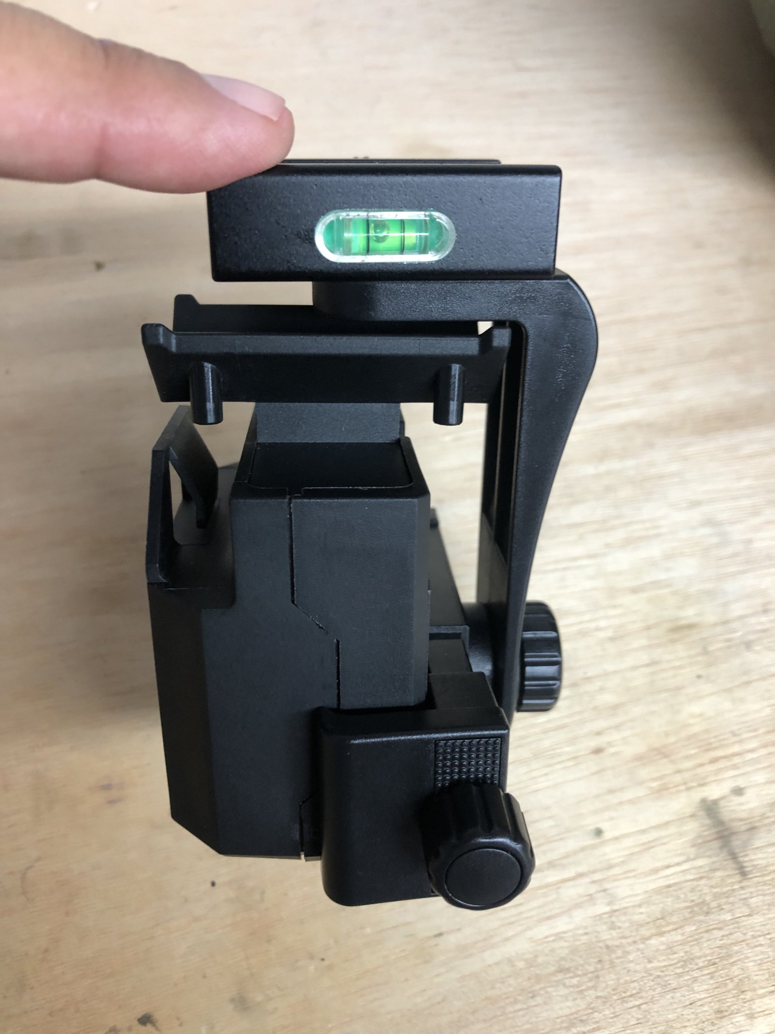

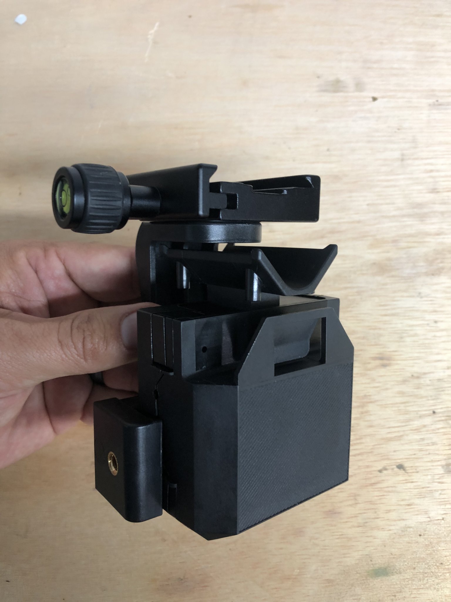

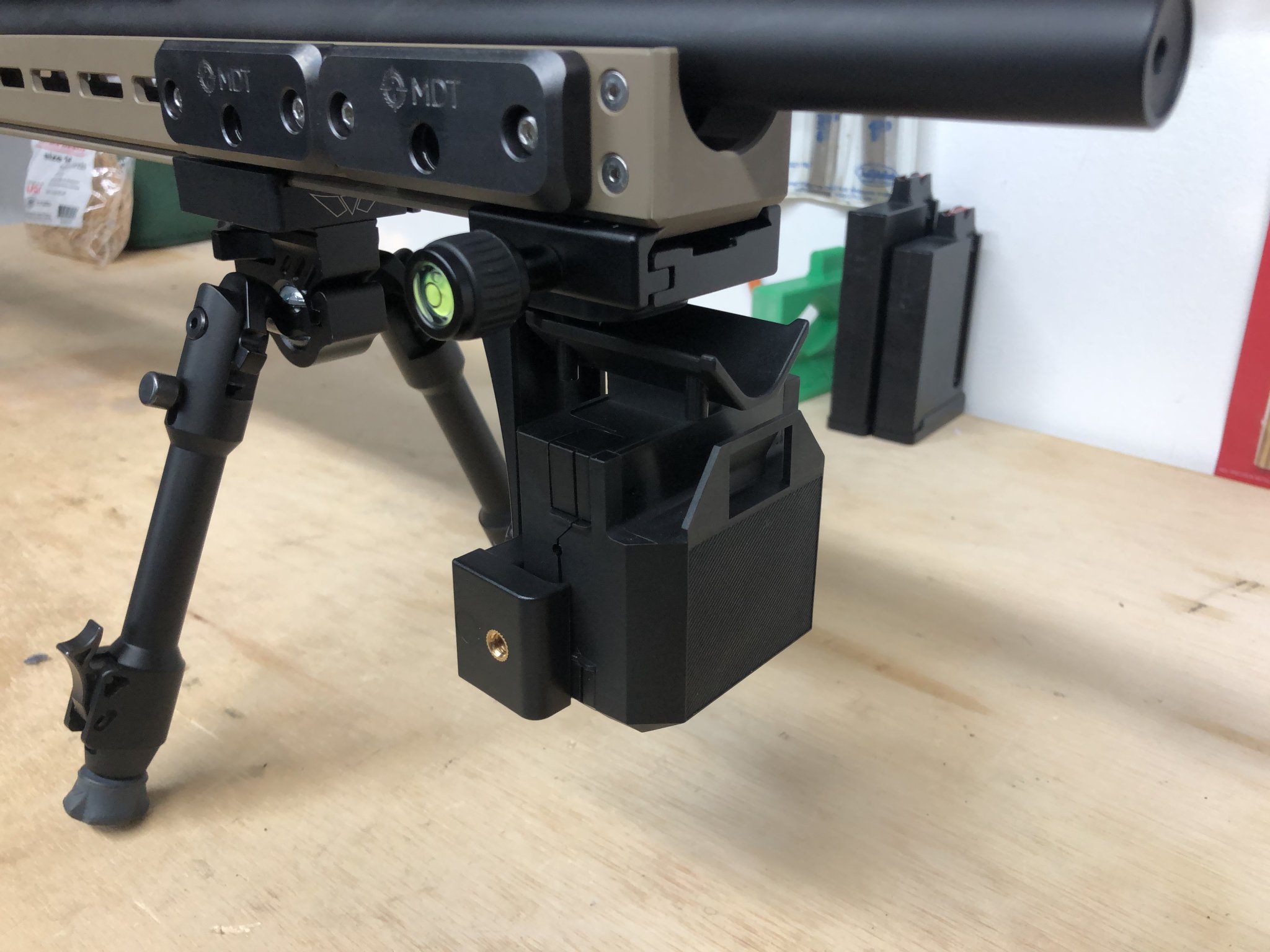

$12 worth of ARCA parts off Amazon and I’ve got a rig that I so badly want to work. Tomorrow I will make a simultaneous comparison between the FX radar and MS unit.
My hope is that it is accurate and repeatable. I want to put this on during match zeroing time and quickly gather data while sighting without the poi shift of a MS or the headache of assembling the wiser or mk machining mounts. This thing is so small and compact that it could even be ran during a prone or non “porthole” style stage to verify speeds mid match. Wirelessly. Phone in your pocket or anywhere within Bluetooth range.
More testing to follow.

I was able to get to the range briefly this morning. 58 degrees, heavy mist/drizzle. 800’ DA. I fired over 60 rounds through the FX and Magneto Speed chronos. I tried sliding the FX fore and aft in the ARCA rail about 3” (nose to bipod) and found no impact on measurements. In the video you can see a 10 shot string measured by the FX and MS simultaneously. I am quite amazed by the accuracy of the little radar. I feel like the differences between the two devices is well within the accuracy margins of the MS. You be the judge. More testing to follow over a variety of atmospheric conditions, but initial impressions are promising.
Nice! When you removed the Magnetospeed, did it still end up with the same averages? I guess my magnetospeed mount was arca so it got blocked the chrono a little bit.
No change. I had the MS bayonet rotated 90 degrees to one aide. I did have to increase the sensitivity of the FX unit in order to work from the more reward location when attached to the ARCA rail instead of directly behind the crown. Went down one click on sensitivity and it never missed a shot and gathered the data shown in the video.

What sensitivity did you use on the arca and when you had it attached to the barrel?
Thanks
The default 20% works fine right behind the muzzle. 10% sensitivity was required to work from the ARCA. -1% calibration had it matching not only my MS sporter as shown in the video but also a V3 that I compared to simultaneously. I have been very happy with the unit.

Do you have a list of parts you bought to make the arca clamp?
Thanks
Good morning and thanks for posting this...how is the unit doing for you since December?
Unit is performing absolutely flawlessly. I only shoot subsonic match grade ammo. Every match I travel to I put my little puck on my ARCA and confirm MV. Without fail people take notice, ask about it, and have said they are getting one as well. It’s just too easy. Too small. Too convenient.
