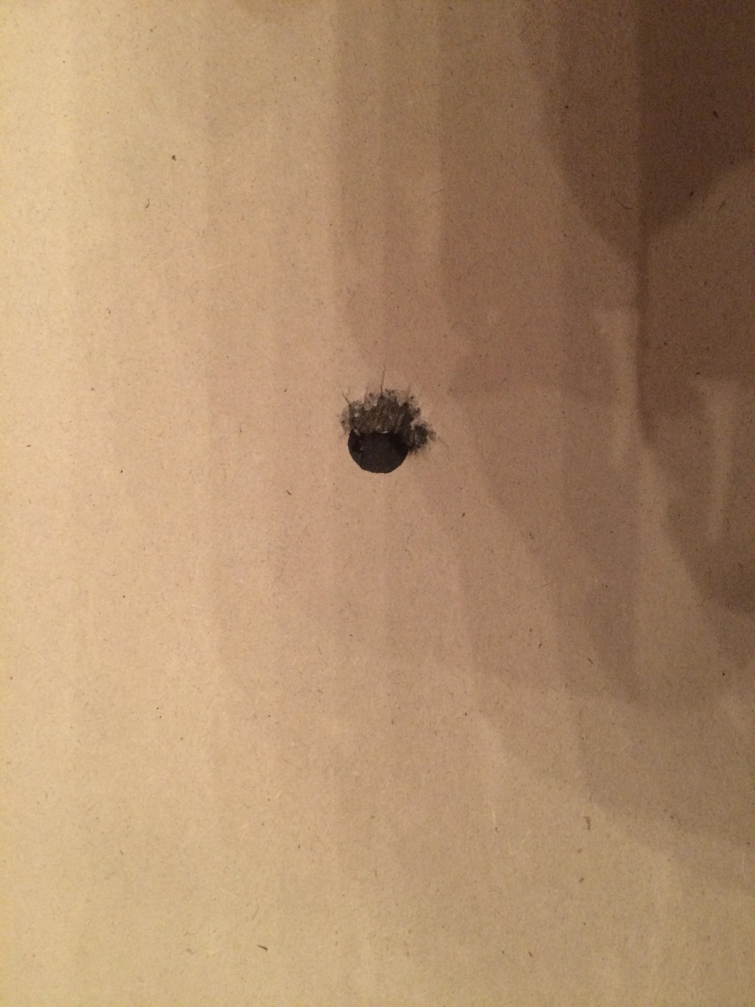

I don’t shoot 50 shot groups and what few groups I have posted here were ridiculed as “wallet groups”. They were not specially selected. Just things I have shot. If I shoot at 100 yards and 3 or 5 shots hit a 1/4” dot I’m good. I know my data is good and accuracy good. If I put 3 or 5 shots in a 1” dot at 200 same thing. I’m ready to go crow hunting. I don’t need 50 shots to prove stat 50 shot groups are going to be larger than 5 or 10 shot groups. They cannot get smaller. Only larger. Ymmv
This “wallet group” is 5 shots at 100 yards.
And no, I don’t have a 50 shot group. And no, you don’t want to bet against this rifle.

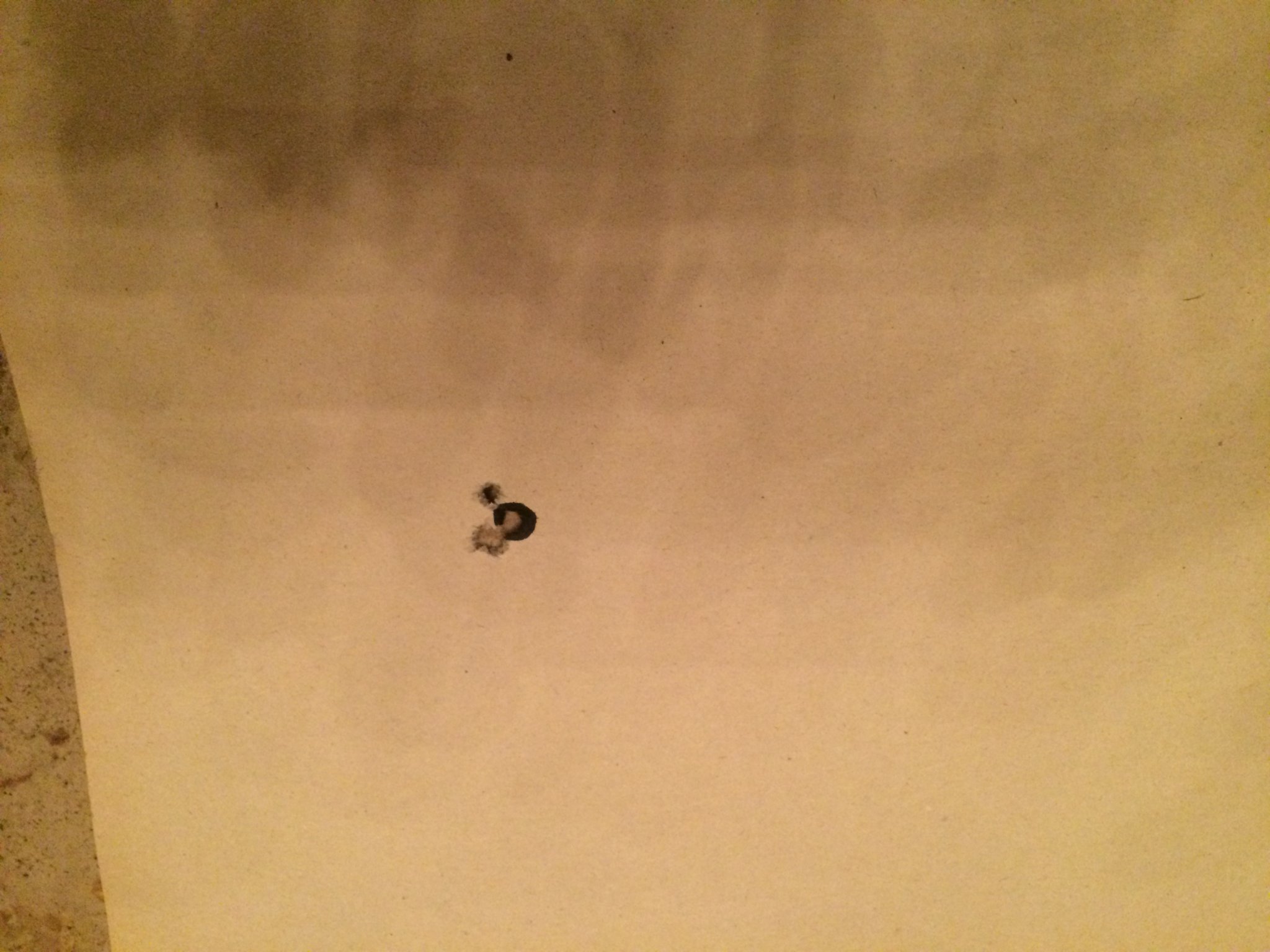

It commonly shoots like that. Outdoors. I shoot at dawn or dusk. The rifle was selected from literally dozens of very accurate rifles with years of testing to determine accuracy.

This rifle was tested over a 2-3 year period against dozens of other high end target rifles. 40X's, Win 52's and several Vudoo rifles. Rifles were culled as they failed to sustain the accuracy I was seeking. Ammo was selected at Eley testing center. No effort was spared.
BTW, none of the Vudoo's were in the top 3 rifles. They were good shooters but clearly not the best. All Vudoo's went through Eley testing. I am not bashing Vudoo and my sample size was only 3 rifles.
