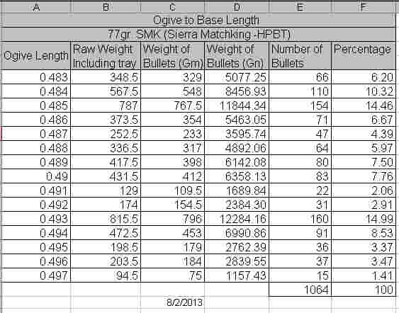

  • Sort bullets by Ogive to Base length (0.001" groups) just curious-how much variation from ogive datum to base did you find in a lot of bullets? which bullets?

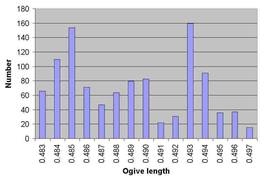

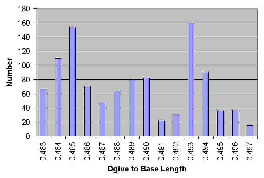

For your second question, I started with 1000 .224 77gn Siera Matchkings without Cannelure and ended up with about 15 groups ranging from about .483" to .497" with three obvious nodes. I am assuming that they have three bullet lines producing this calibre. I have the numbers at home, I'll try to remember to update this info.

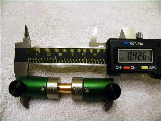

.014" ogive to base spread. That is a good bit.
I know, that's what I thought. Thankfully it is something I can get around with a little work (sorting). I have 700 or so 80gn JLK VLDs sitting around that won't shoot in my 1:8 barrel (opens up to a 1.5 moa group or worse at 200 yd.) I haven't checked them, but I assume that they would be much more accurate in length considering that they are hand-made.

Here is my data from sorting 1064 77gn .224 SMK bullets for Ogive to Base Length using a Sinclair bullet sorting stand. You can ignore columns B, C & D. They are there solely for the purpose of counting the bullets.
I like SMK bullets for FT/R, but they obviously are not Benchrest bullets.
