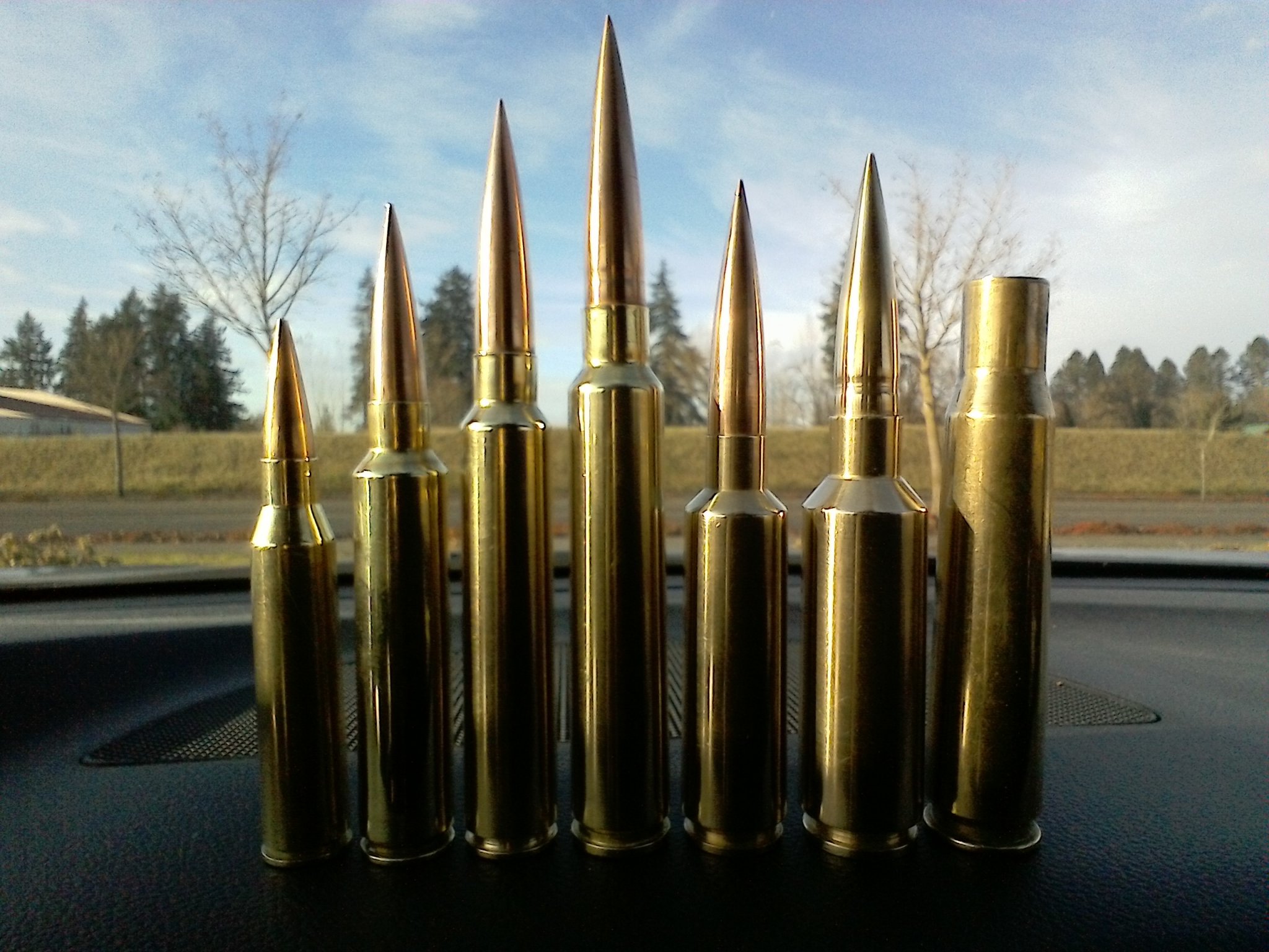

Some designs in general yes. But not all cartridges are equal. Take for example the 6mm ppc. or the 338 lapua or the cheytac all if them can be run at much higher pressures with no issues then saami limits. Some of it is design some is who made the brass. Another example out side of the box is the new 300 prc or lapua improved brass made from Rcc the Hornady Prc 4 shots at high density loads where the Rcc 20 plus shots at even higher velocity. There are several ways to obtain greater performance but the desire to greatness must be desired and targeted. simply doing a modified virsion of a obsolete design will gain but is only good as the base line in what you used. Here is some example of what we are doing and yes I am working with Theis to devlope his own designs. for his end results. In the photo The cartridge on the lt is the 338 lapua 2nd from lt is the 375 Mercenary revised from the failure from a unnamed cartridge manufactor . 3rd is the 400 warlord also comes in 416 4th the 420 Blitzkrieg also in 416 known as the 416 Destroyer. 5th 408 colossu
s also comes in 416 known as the 416 colossus. 6th 458 Goliath . and last is the bmg case . and there are many other cartridges not listed and many others in the works WIN_20191127_09_40_38_Pro.jpg

I enjoy conversations like this when their civil as much can be learned from them when ears and hearts and minds are open. As far as the ppc in benchtest psi is psi at 70,000plus psi Guys are shooting their brass 30 plus shots as I am one of them and it’s super Safe of not you would not have the case life. Several reasons why it works the way it does. 1 the tennon in relation to case OD 2 Quality brass and a small primer 3 tight chamber . all allow for a higher pressure allowance. You are correct the industry is not advancing fast enough and one of the reasons is being satisfied with what is feed to us by the mass marketing industry. It is the desire to excell that drives the industry . Not being satisfied what your being feed . If you look at the lapua for example it was beefed up beyond the original 416 rigby glorified black powder design so was the cheytac. granted there is less difference between current made rigby Jeffrey’s and Gibbs cause current manufactoring is now made to those new standards. Saami is simply a way of standardizing basic design not a ruler for true measurement. But some live and die by wiki information as well. I never said bmg sucks just that it’s obsolete and it is. Could the basic OD Demintions be used in a upgrade of case head and ID yes but why when it was never designed for accuracy or performance. Just a lead slinging hard hitting automatic weapon cartridge If your going to go to the trouble of re working it just scratch the old design and start over from the ground up. Is that sac religious to the John m browning menions that are stuck in the nastalgic past ? perhaps.... We are only limited by the lack of desire to excell in the late 1800’s to the early 1900’s there were those who would not give up their horse. There is a lot more to development in performance then just the cartridge as you stated earlier but it must start somewhere.

In short no it’s not that I know of written down some have spoken on it in writings but I can tell you this much the wider columns burn powder more even and thus more accurate they will also require less powder to produce more energy and velocity proven in every cartridge that had close to a equil in capacity in a shorter wider column Those are facts. Proven over and over again As powder ignites threw flash holes if it can burn a larger % of powder of the over all capacity by burning out and forward vrs down a long narrow column that is obviously more efficient. not rocket science. Guys like my self gain from doing vrs reading 90 % of my knowledge is experance in suscess and failures with a little understanding of cartridge dynamics In turn creates lots of knowledge over time. In the past 10 years I have focused lots of my time on understand why Thing work as they do and how to improve it

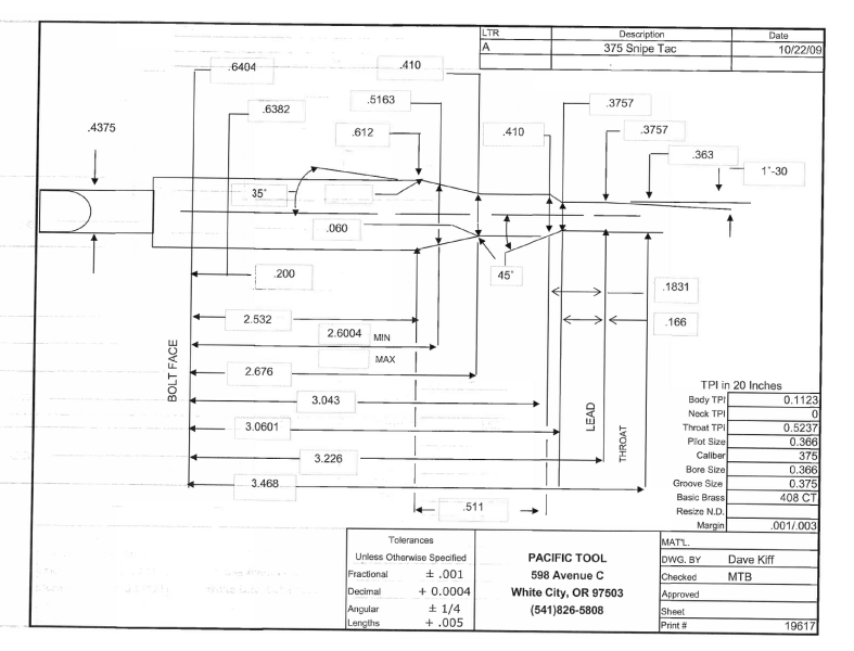

Dave Viers’ cartridges included:
.375 SnipeTac:
http://www.municion.org/375/375SnipeTac.htm
.375 SnipeTac:
