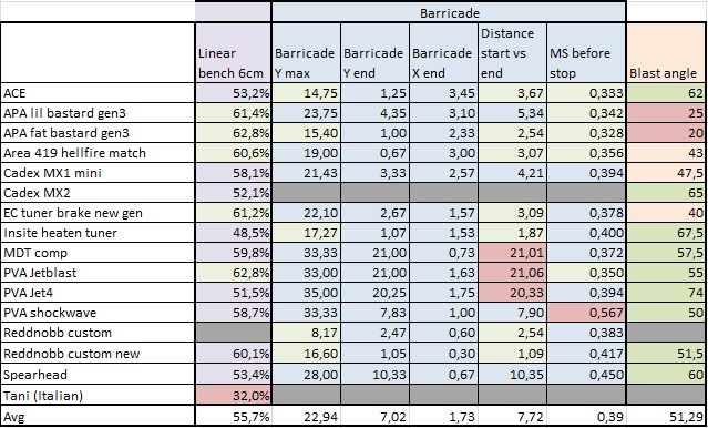

Really good video. Could you post up the data in the video here?
In your opinion, which brake had the least blowback to the shooter while having the best reduction? Or should I say, which one is the happy medium, emphasis on not so obnoxious to the shooter?
Here is the summary table of content.
I try to stay away from giving a personnal opinion as much as possible, but green meaning "top brake" for each test, and red mean "red flag", I would say, depending on you shooting style, good options would be: ACE, Insite, Reddnobb new are the 3 best performers with a nice blast away, and if you just don't want the "APA" kind of blast angle, you can add to this list the Area419 and EC tuner.
If you want the must comfortable blast with still a decent recoil management : ACE, Insite, PVA Jet4

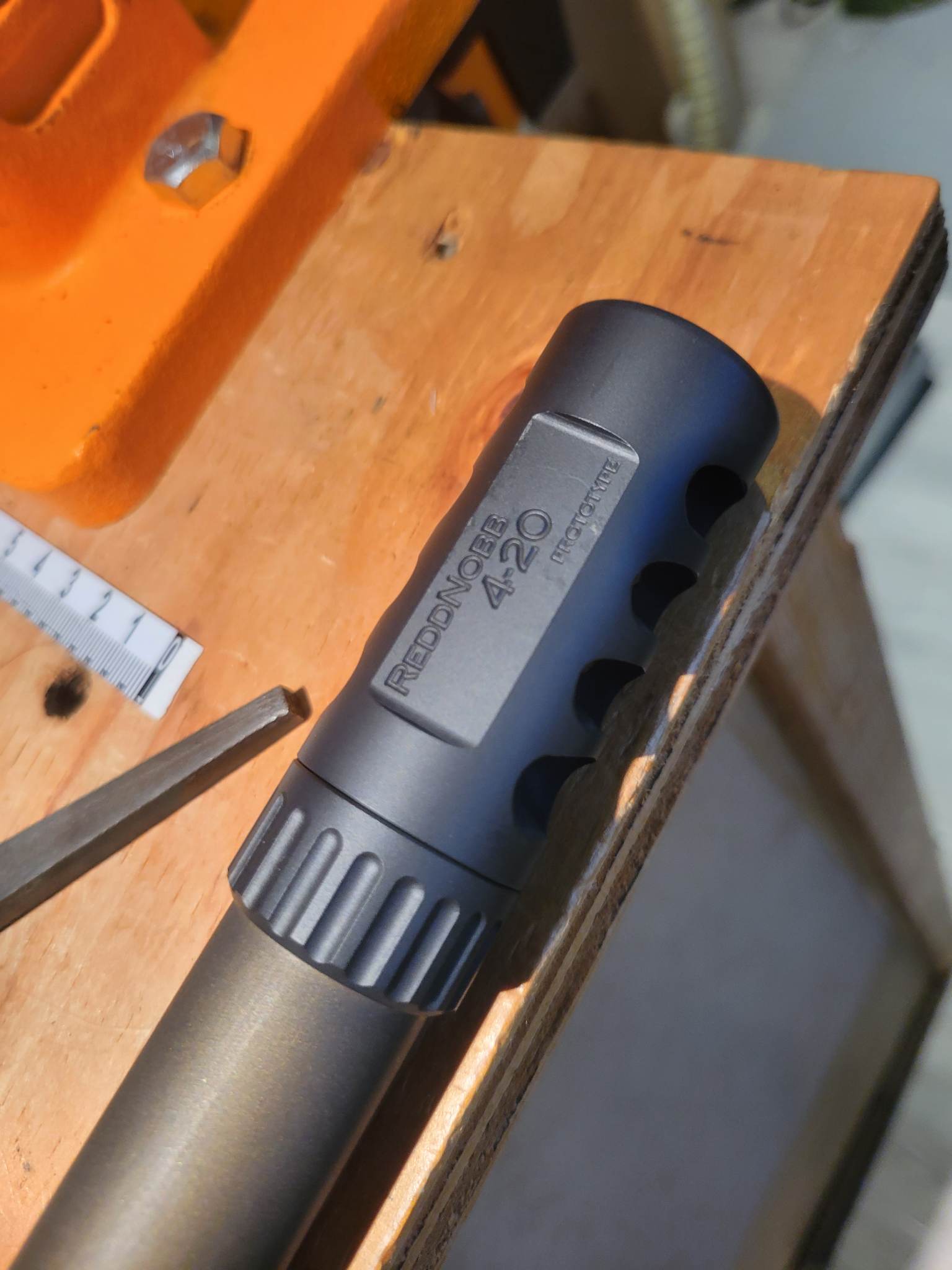

Here are some pictures of the ReddNobb custom "new generation" The gunshmith making them have called it the 420 (4 ports, 20deg).
The one in the picture is a prototype, but the final version will be the same with a more modern front finish from what i've heard. So far he doesn't make huge batch, so it's kind of on reservation.

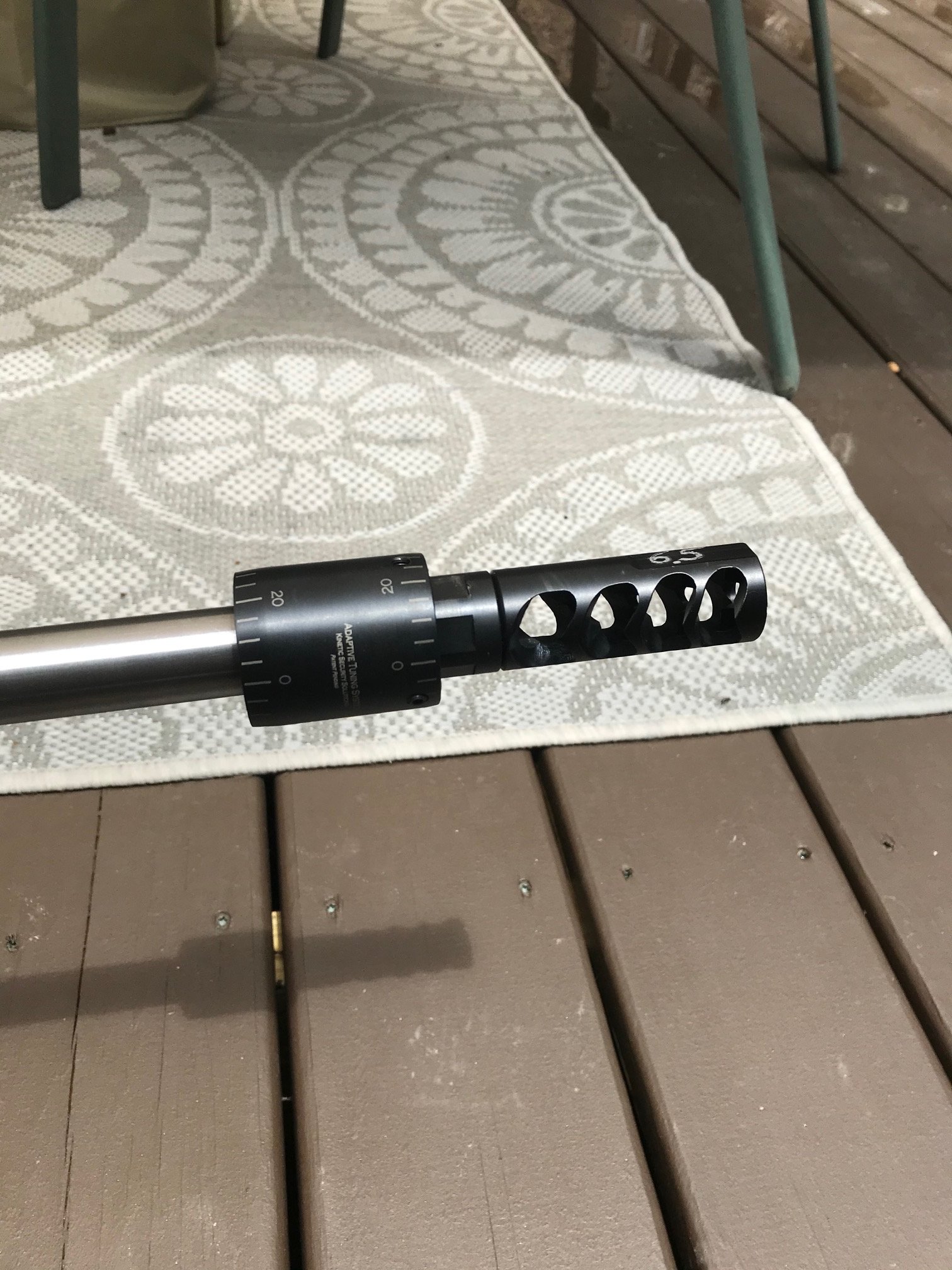

I would try the ATS tuner brake as well. I have a feeling it's going to be favorable in a couple areas to the ones tested. It can be had as both a tuner brake and stand alone.
I own and have run apa gen 2, gen3, helfire, sidewinder, helfire match, heathen, SRS, ACE and now the ATS brake. It has more recoil reduction than the apa but has less concusion and side blast than the ACE ( one of my favs). I like the fat bastard for 6.5cm and the ACE and ATS for 6mm stuff.
I own and have run apa gen 2, gen3, helfire, sidewinder, helfire match, heathen, SRS, ACE and now the ATS brake. It has more recoil reduction than the apa but has less confusion and side blast than the ACE ( one of my favs). I like the fat bastard for 6.5cm and the ACE and ATS for 6mm stuff.
So on the ATS, do you think the tuner is assisting with the muzzle rise difference or is it the brake itself? I saw in a different thread that you were not having as much rise reduction as Aaron was so I'd be curious if you changed your load out at all to try something different
It had to do with the way i was holding the rifle. Now that is fixed on barricades its holding well. Tuner is really just a tuner, brake is a brake. If you like both, rock both.
As DBD said the tuner tunes and the brake reduces recoil. Been using the ATS tuner for a few years with the PVA Jet4 brake, which looks similar the tuner/brake combo set up although the below pic was the original untapered tuner. The tuner works great. I use it especially with factory ammo. The Jet4 works really well at recoil also.

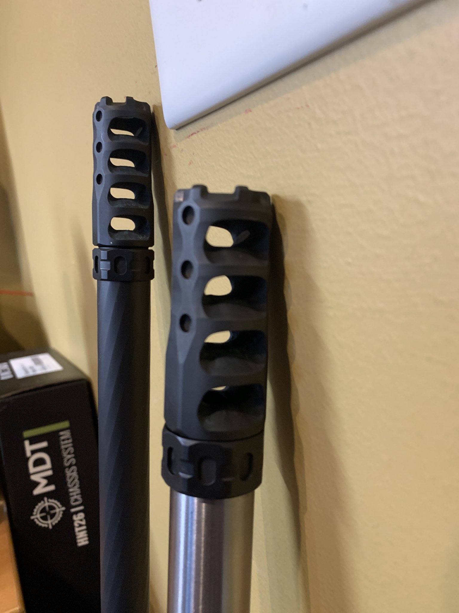

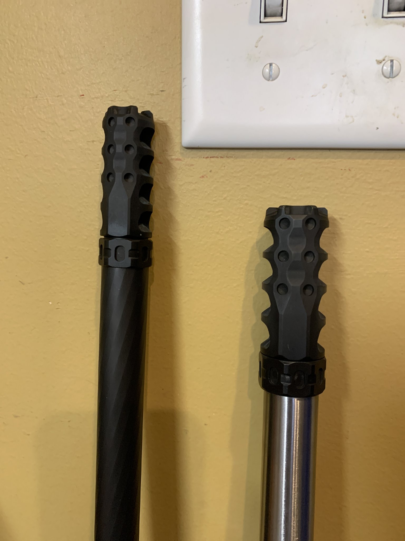

Photo for ref. Both are 6.5 cal. Small is .860” large is 1.040”
Yeah they sent me the big one. 1 with all holes drilles one all top port closed. Will be interesting to see the difference.
