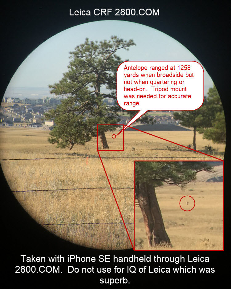

    One other factor between the 3200.com and the Geovid Pro is the pro is using a new laser with smaller beam divergence, this can mean the difference between that elk 432 yards away but he's standing behind some brush that is at 327 yards and your LRF tells you 327 instead of 432 and you miss your shot - this is because the beam was larger and hitting the brush in front while you thought it was centered on the elk.
    Here is an example, notice the antelope was standing well past the tree in front of it, I was testing accuracy by trying to get the ranging circle close to the branches and trunk but be able to range the antelope behind, an LRF unit with larger beam divergence may have picked up the tree instead of the antelope. In general, the smaller the beam divergence the better.

    @Glassaholic, your issue with the Leica's above may also be where the aiming point is compared to the actual laser point of impact right? The beam divergence obviously might cause it too. I think the Sigs having an adjustable aiming box or circle is a nice feature so you can "zero" you laser to the center of you reticle in the bino/rf.

    Yes, the actual beam location vs. the LED circle inside the bino can be an issue, I think Leica has a good track record and want to say maybe it was Sig and one particular model that seemed to have more issues. I remember someone using NV to identify where the actual beam is in relation to the LED indicator, but would have to dig that up.
    905nm units can be seen in NVG’s, but the power and pulse rate can make it difficult. 1550’s are invisible to NV. Set a target up on top of a berm that is the size of the beam, then move the reticle around to the edges of the target and see where you hit and miss.
    Beam shape is also an issue, most are not circular, but rectangular. The Radius for example is really a line, about 5 times longer than wide, so orientation is an issue.
    This is where the Vector rangefinders crush the competition. Beam size and shape combined with a high power 1550nm beam gets you an eyesafe system that ranges stupidly small targets at rally long range. I can ping a 24x18 plate at 3000m with the 21 so long as I can actually see it. Bright sun, non reflective camo paint, no problem. Sadly, they are not cheap. They are worth every penny if you really need that performance though.
