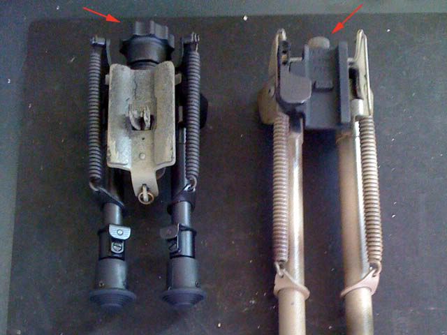

A while back I was looking to see if somebody made a permanent picatinny quick release base for the Harris bipods. Not one on these adapters, that just about everyone sells, that has a sling swivel on one side and the picatinny adapter on the other. I wanted something that replaces the original Harris swivel base that attaches to the sling swivel. Turns out I found two. Alamo Four Star and LaRue both make them. Alamo has the complete bipod, or the base alone. LaRue on the other hand only sells you the complete bipod. It's called the LT706. I prefer the LaRue setup because it's lighter, has a lower profile, and the lever system is more to my liking. LaRue also has a rep for making quality stuff. Here are some pics of the LaRue setup:
My problem was that I had a many Harris bipods laying around the house, and didn't see the point in buying another or spending twice as much. Also LaRue only sells their base on the 6-9 and 9-13 bipods. I wanted it for the 13.5-27 Harris bipod. I write them an email to see if it's possible to get the base alone. I get a reply from James from the technical department. This is what he had to say: "<span style="font-style: italic">We don't sale the mounts individually. We build them into the bipods. It isn't something that can be done on a work bench in the garage.</span>" Darn! Maybe they had to mod the bipod to attach the base? Even then I figured that with my skills I would be able to make it work. So I gave up...........until a shooting buddy showed up to the range with one of them. I asked him to borrow it to see what the big mystery about this LaRue base is. I go home and start checking it out. It seems that everything looks straight forward. I wondered if maybe there was a spring under heavy load that required a special tool to compress it to be able to assemble it. I decide to take a leap of faith and pull it apart. I get my 1/4" socket wrench and and loosen the nut inside the big knob. Nothing flies apart. I then release the big knob. Nothing flies apart. Out come the two parts and the bipod is fully disassembled. No big mystery. No flying parts. Nothing! It's all very straight forward. Here is a pic of the two bipods. They are a great example because one is painted and it's easy to see what parts have been swapped. I even installed the large knob on the bipod with the factory base to show that all the parts are completely interchangeable. The red arrow shows where the 1/4" nut is, which is all the is required to install it.

That's odd... I asked to buy the LT706 adapter alone instead of the LT130 and was told I could. Bought the LT706 without an issue. This was in August. Installation was a breeze, as you mentioned.

ARMS is the closest thing you can get. It doesn't replace the entire Harris base, but it does replace the original Harris tension screw. With the tension screw removed, the ARMS adaptor bolts directly to the Harris base.
I agree with you. Fuck LaRue. I actually had a similar conversation with them about this very topic. I think the ARMS version is very smart because it actually bolts to the Harris base and elimates the ever-loosening Harris tension screw completely. I asked LaRue why they didn't make one with this design. I was laughed at, and told their bipod adaptor with the sling stud was good enough. They told me if I didn't like the Harris tension screw then I needed to learn how to use Loctite.

I abstained from saying anything till I personally checked to see if "am I missing something here". I did go through customer service first, and the reply I got was posted on my first post. I actually had more than one conversation with them, and I always got the same treatment. I made sure that I covered all my bases before mentioning everything. Once I saw that all it took was to remove a 1/4" nut, remove the the shaft, remove the original base, replace with LaRue base, put the shaft back in, and tighten the 1/4" nut, that this did not require special shop skills or tools as they said it would. It couldn't have been more straight forward. I don't believe on keeping quiet about such things, but you are free to also voice your opinion. As you can see from other posts, I'm not the first person to get treated this way. What's the point of living in a free country if you can't defend your own views and opinions?
