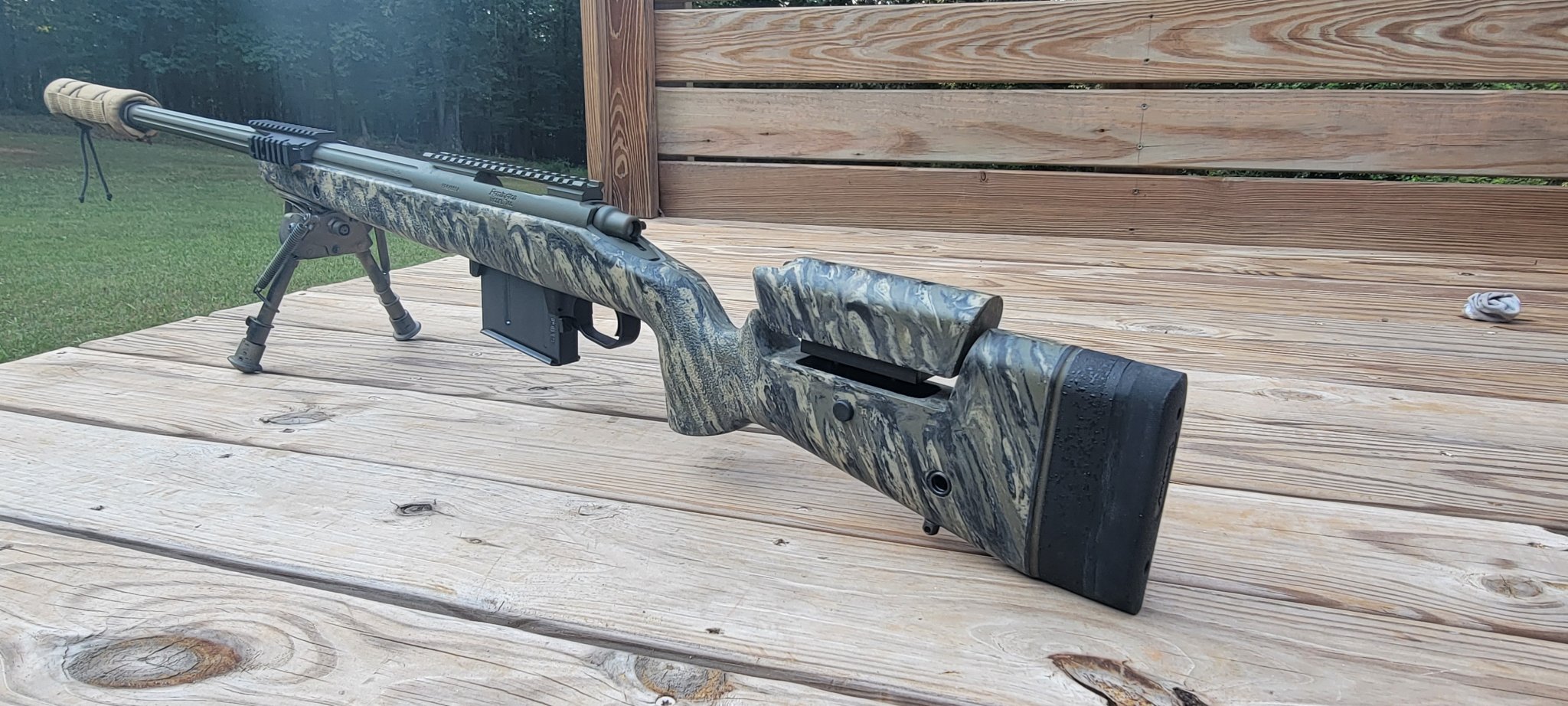

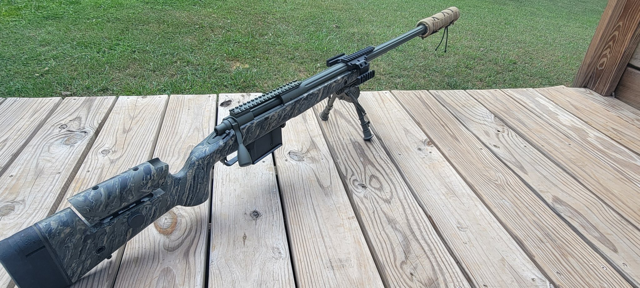

    This is fantastic news. I just received a new A3 stock from McMillan. I had a Badger EFR installed in it by McMillan. They told me that Badger Ordnance will not longer be providing their famous EFR mount because they need to shift production over to other, more important operations. McMillan said I got one of the last EFR's that Badger will produce.
    I want to place a 2nd order for another A3 set up the exact same way. I was bummed to learn about this as I don't like any other EFR's out there (that I've seen). This is really cool news! It looks really similar.
    However - @LongRifles Inc. will you consider adding a side rail provision just like the badger EFR has? This model does not appear to have anything for side rails... (Not because I need them, only because they look cool!!!) There, I said it.
    Thanks!

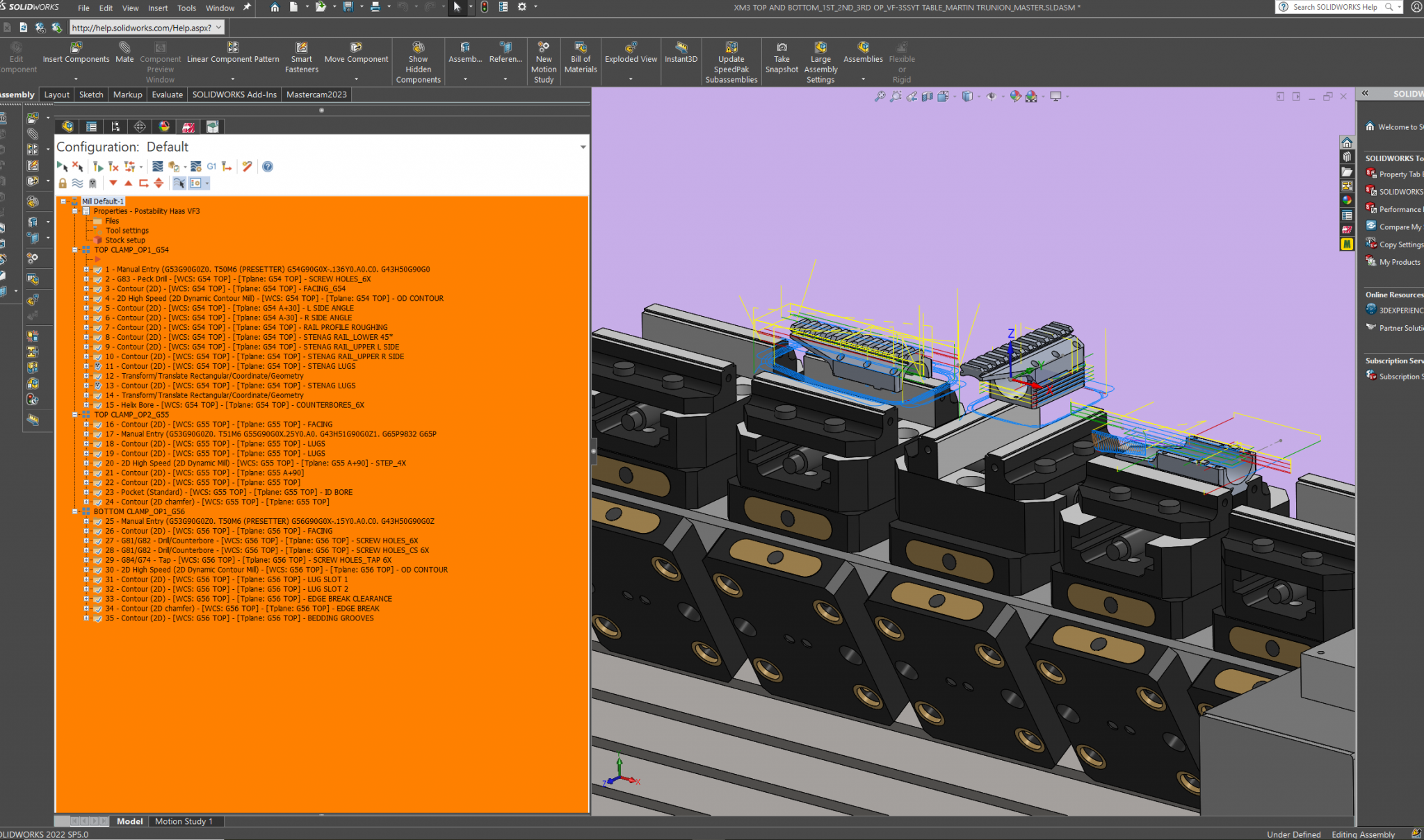

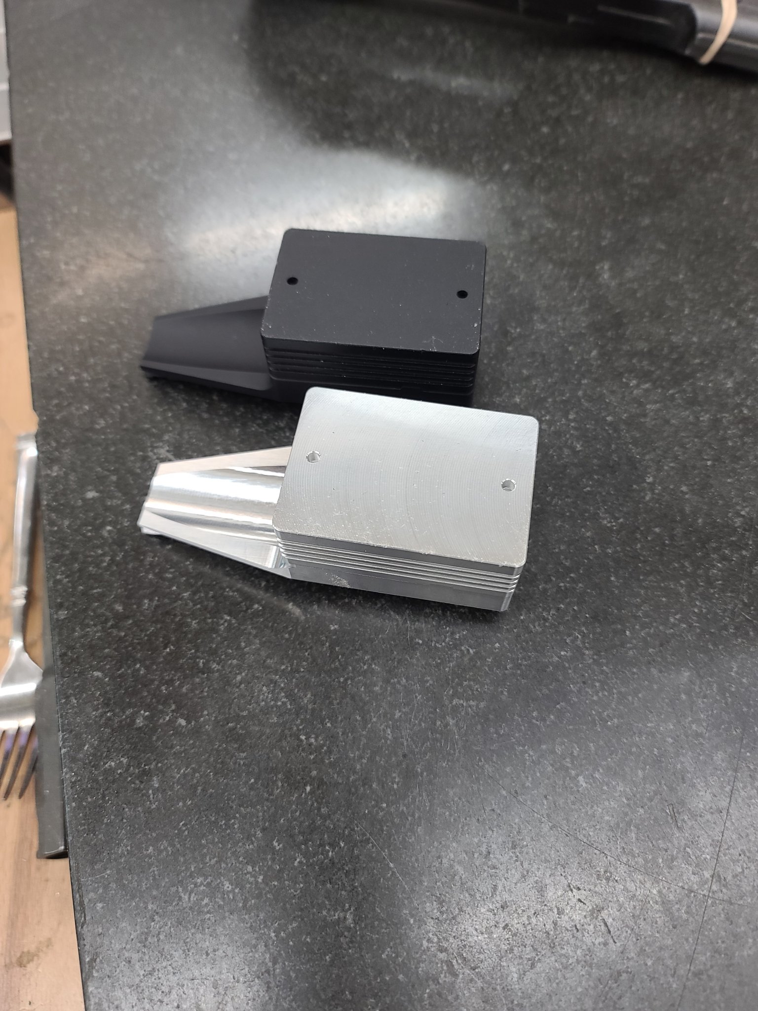

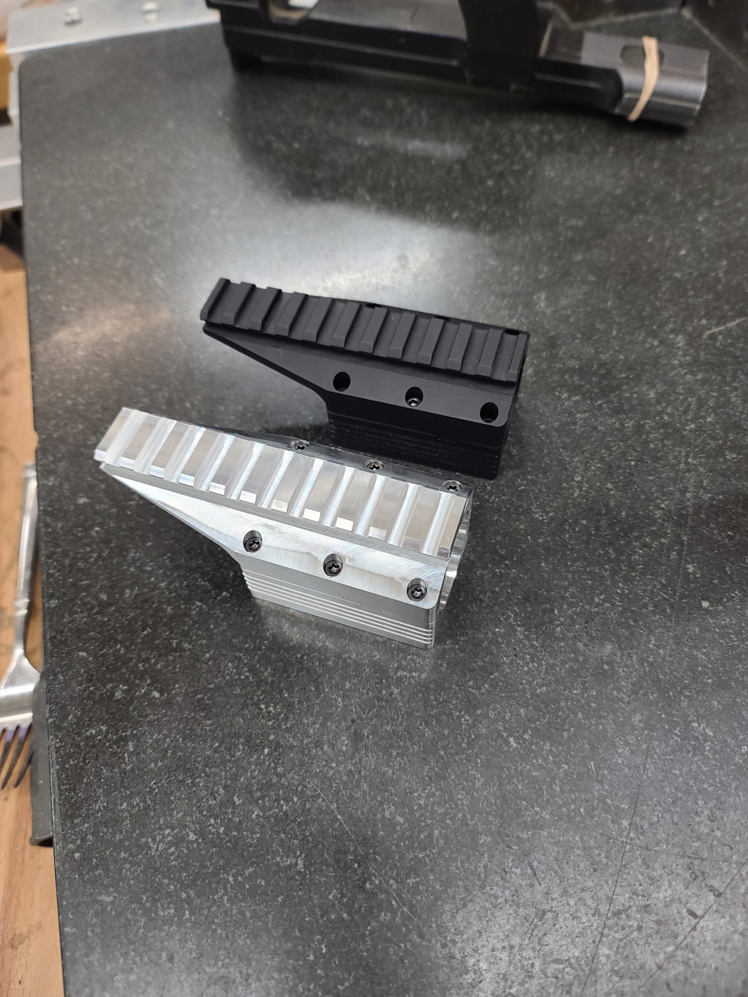

    Wrapping up for the day. Op1 on all the top pieces are done, Op2 for the bases is programmed, and I'm starting on the programming for Op2 of the tops.
    What's left:
    • Program and run Op2 of the bases
    • Program and run Op3 of the two pieces assembled. Basically, I'll screw them together, drill, and ID bore the hole for the barrel as an assembly. That'll eliminate any offset or weird stuff.
    I start my day around 4:30 each morning so we'll hit it again then.
    Have a good Friday gents.
    A little update:
    As with many projects, I'll start the programming ritual with the mindset of "It's a small batch; keep it simple." Then I faceplant the brick wall and remind myself of the resources available on my machines. -Hit the reset button and put the shop resources to work. (dummy)
    That was my Saturday. I had the top plate on the 5 axis just because its become a go to of mine for conveinience. (This is not a 5x part.) It's just as easy to do this on our big 4x machine. Plus I can gang up parts and make the top/bottom pieces in a single run. Being able to consolidate stuff and get a complete part at the end of the cycle is power. So, my Saturday morning was consumed by computer work and a little setup.
    A few little things to finish up this am and were ready to make chips again.

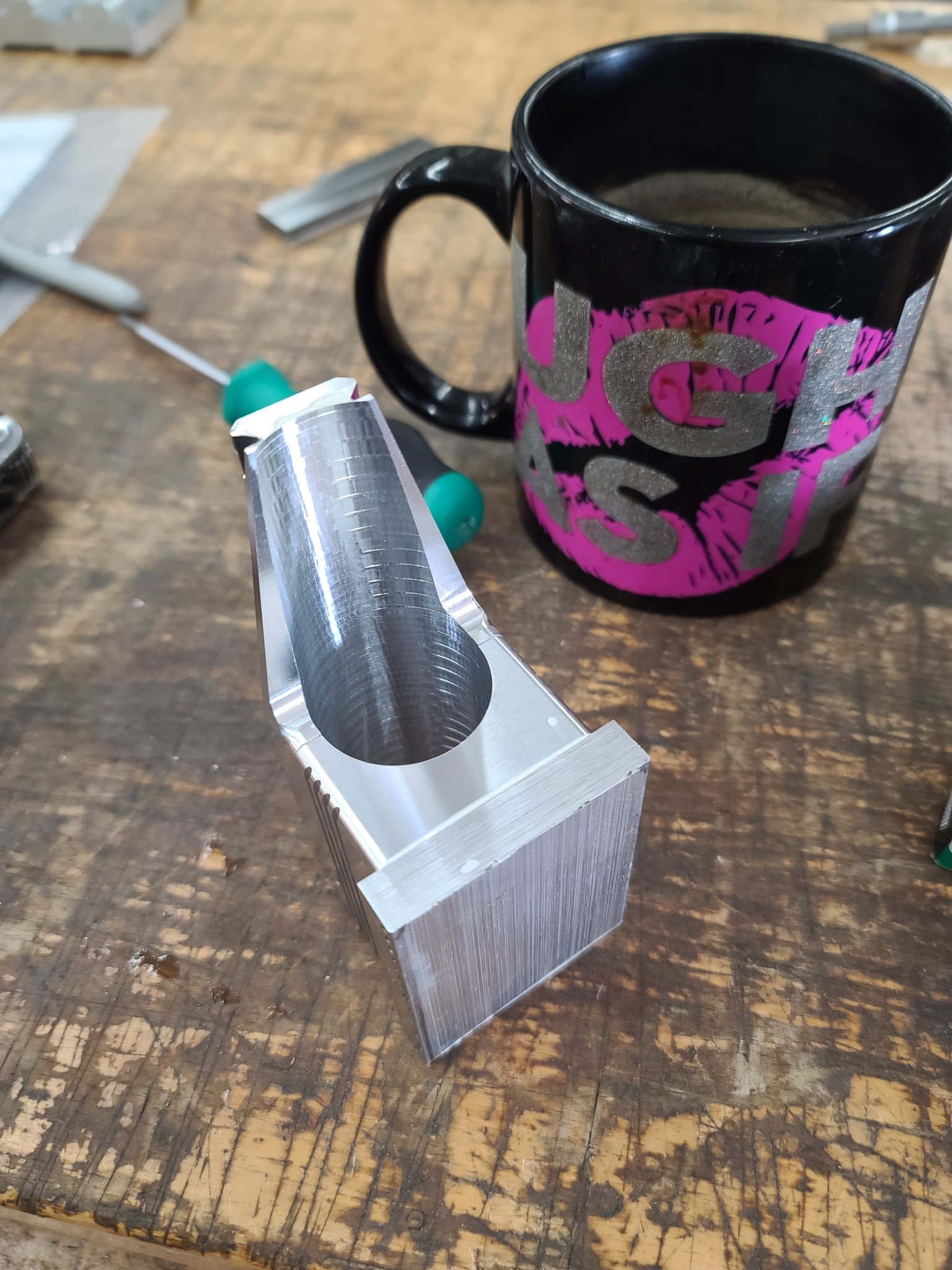

    On a side note, the bore of these needed a modified barrel contour a bit less than a mtu. If this was ever to be a regular offering might be worth seeing if you could somehow open up the bore without making paper thin walls. But I'm not sure how many people who NEED rail for a clip on will be healing mtu sized contours so might be a non issue.

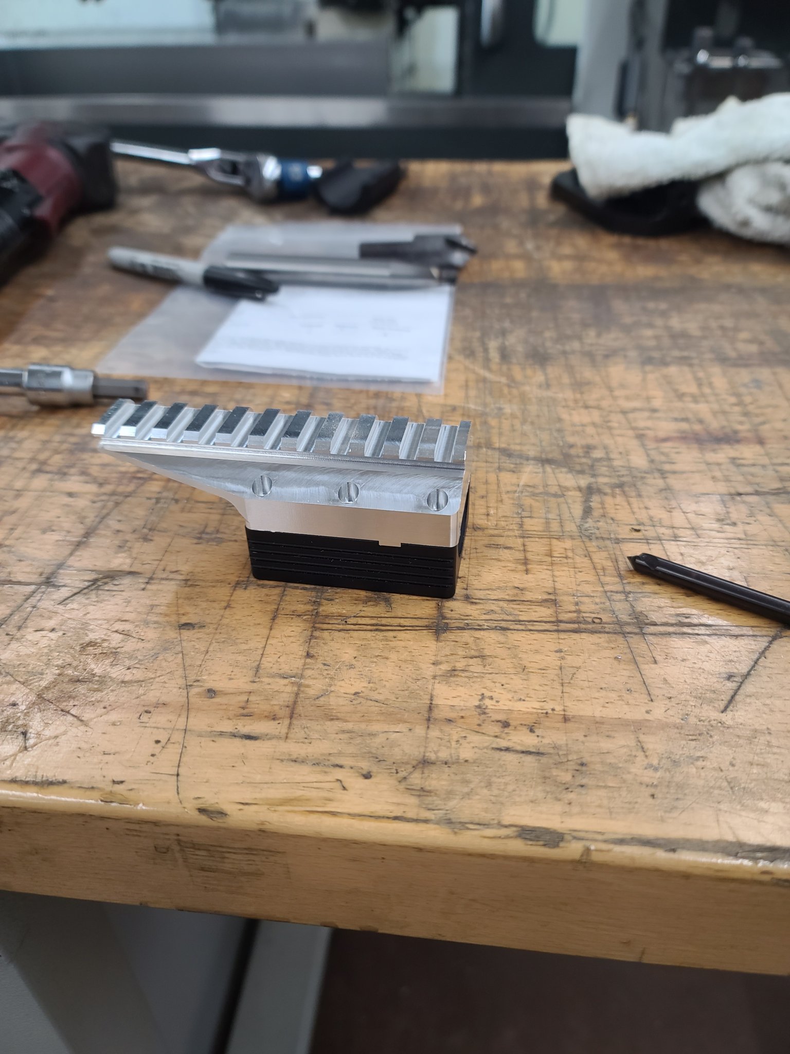

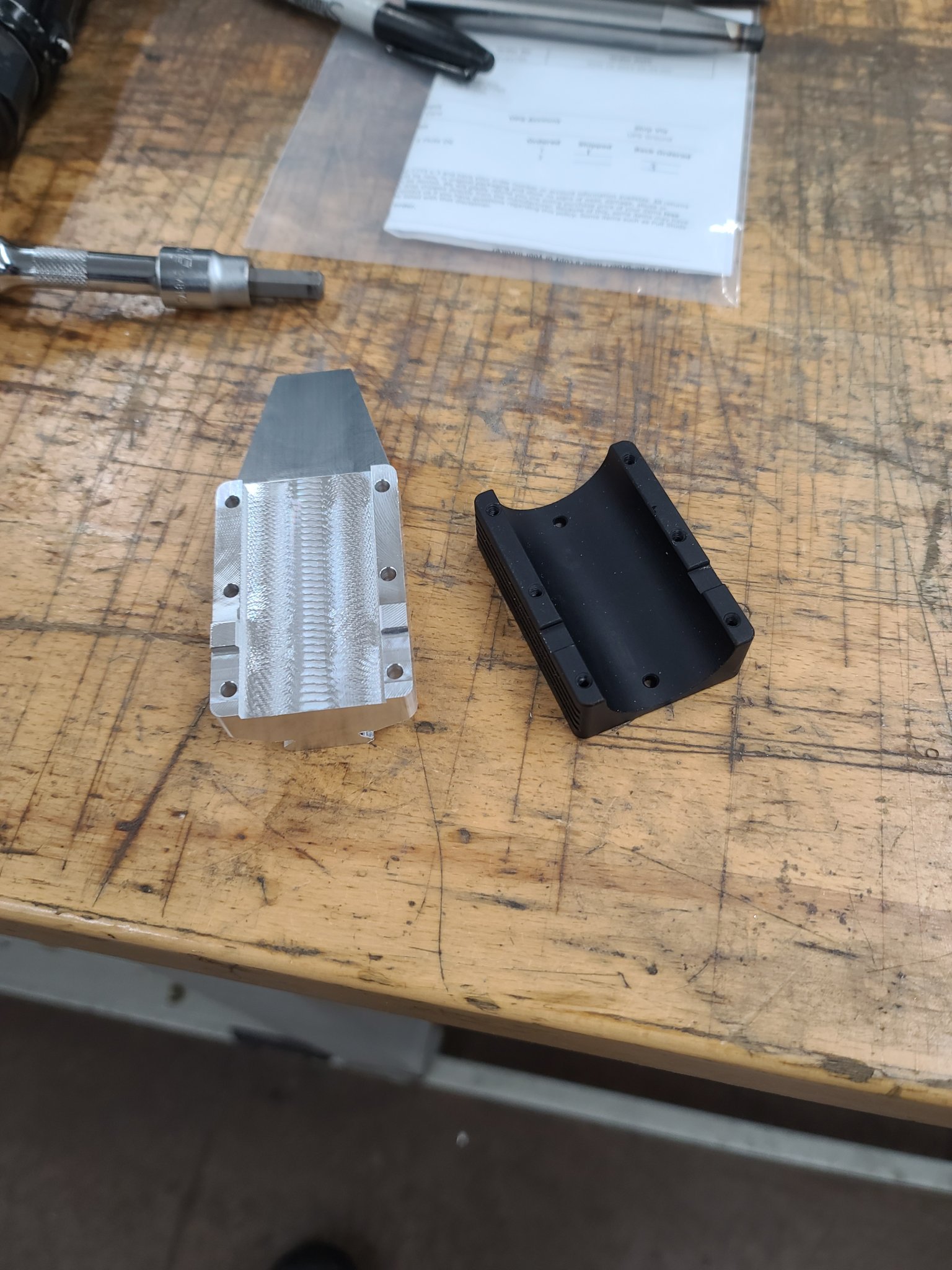

    Base and top piece. It works, but I'm not happy with the finish. A wee bit crunchy as it bored the opening. These are not a hole. It's an oval. That rules out a single point boring head. Instead i either get a very long/large tool and contour or I ramp a contour like a spiral staircase. That's my preferred route as throwing a 1" dia EM that has 4" of cutting length is going to have its own set of complications.
    Sorting that out now...
