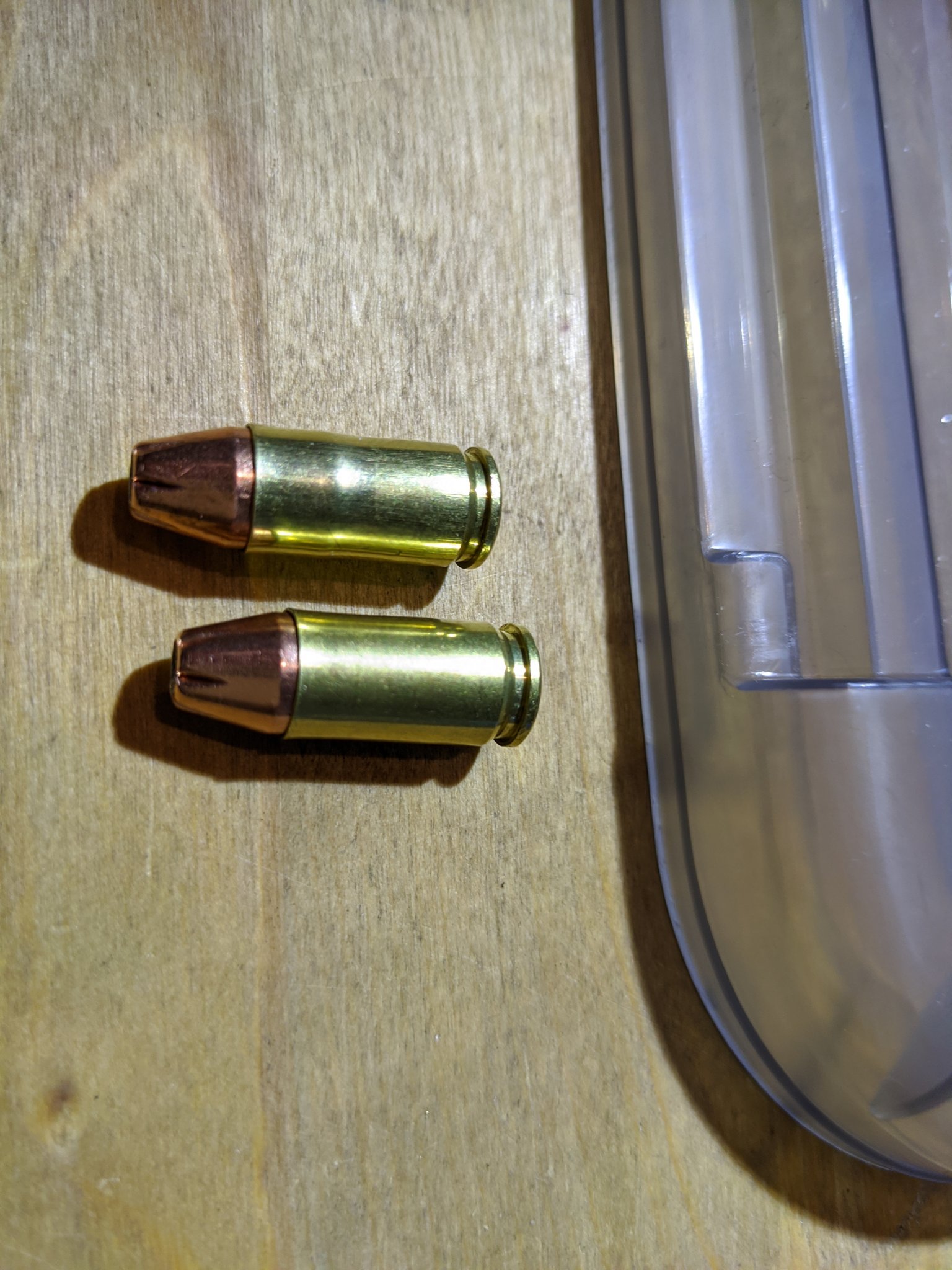

Top dillon bottom lee. These are pre-crimp though...

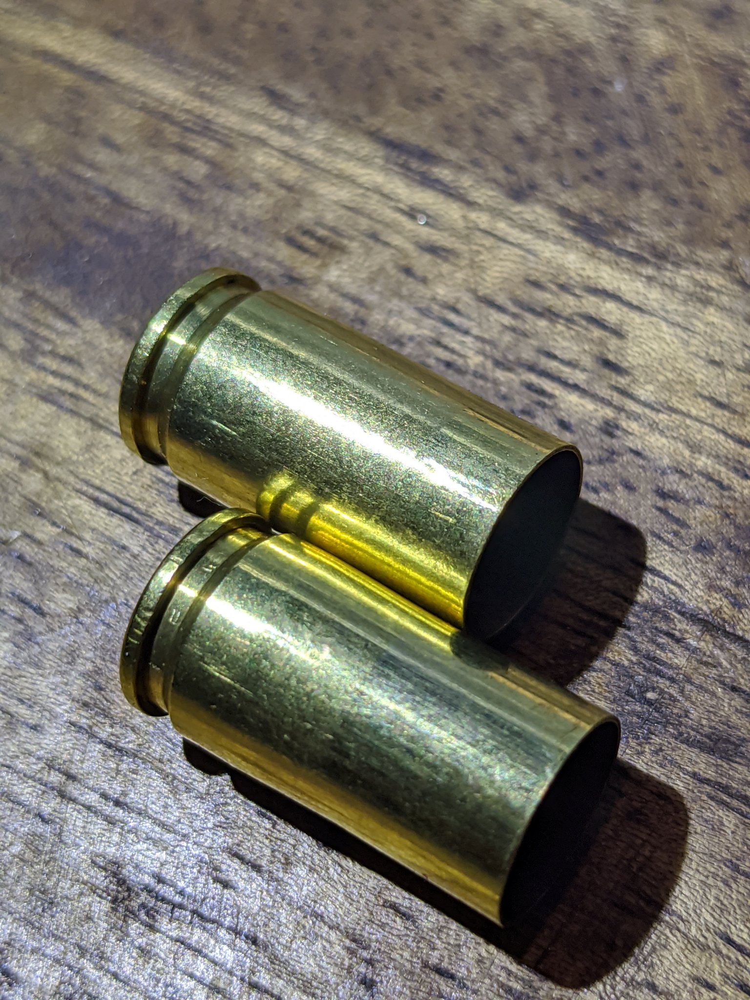

One more picture. If you look at the bottom one sized by the Dillon you can see the shades of color change twice. The lowest part is the normal spot where the resizing die stops and is usually there from all dies. Then you can see another one father up where the diameter of the case gets smaller a second time which is unique to Dillon dies.

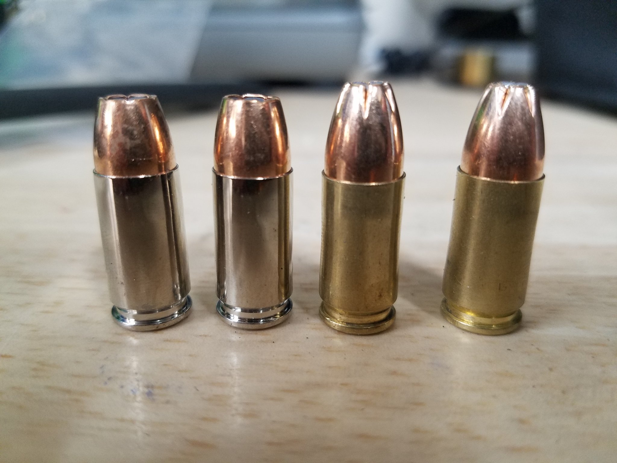

Here is factory ammo on the left and reloads using a Dillon die on the right. Both exhibit the exact same hour glass bulge.

As for your picture, in most cases the Dillon hour glass is even more noticeable than yours but besides that those factory rounds barely have an hour glass shape at all compared to the Dillon. Terrible comparison. Looking at the sides of the nickel cases they look pretty damn straight actually.

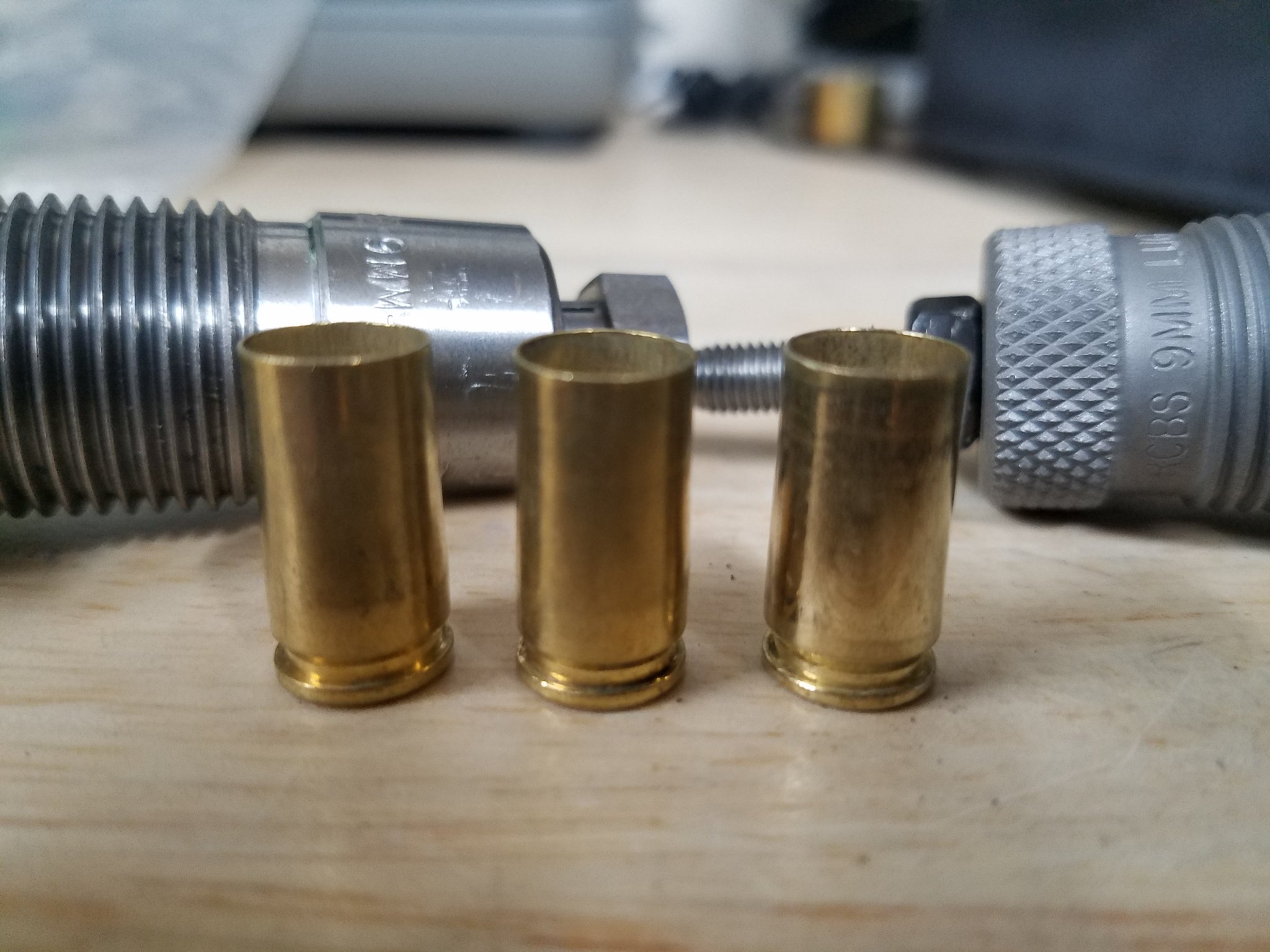

Here's three sized cases, all FC head stamps. From right to left, sized with RCBS, Lee, and Dillon (die not shown). Your dillon sizing die isn't the issue.

Figure what out? They manufacture dies to size the smallest thinnest case so it can hold a bullet. If you use anything bigger than the smallest thinnest it will assume a hourglass shape when you seat a bullet.
